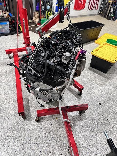

I put on the 'it's winter, so the engine's coming out for maintenance and leave the bitch on the lift' tire.
But the real answer is blizzak's.
Concur. That’s what I’m putting on my 3.0, even though that baby will only come out on those few days when pavement’s dry. Road salt and abrasives are a real bitch here in MontrĆ©al. Got a Cooper S for everyday winter driving.
Bro, don’t you know the internet says not to leave your suspension hanging? Car is going to turn into sand!

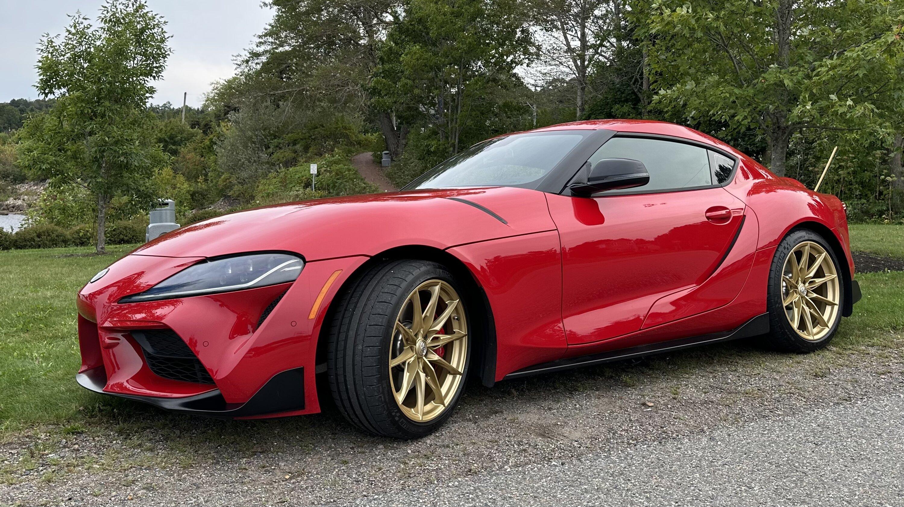

Got a set of Fast Wheels FC04 18x9 wrapped in Nexen WinGuard Sport 2 245/40R18, total cost was 1.6k CAD which was a crazy deal.
Did some research and found the Nexen WinGuard Sport 2s to perform really well especially for the price, so far no complaints gripping really well on cold/dry. Will give it a nice rip in the snow to see how much grip I get
