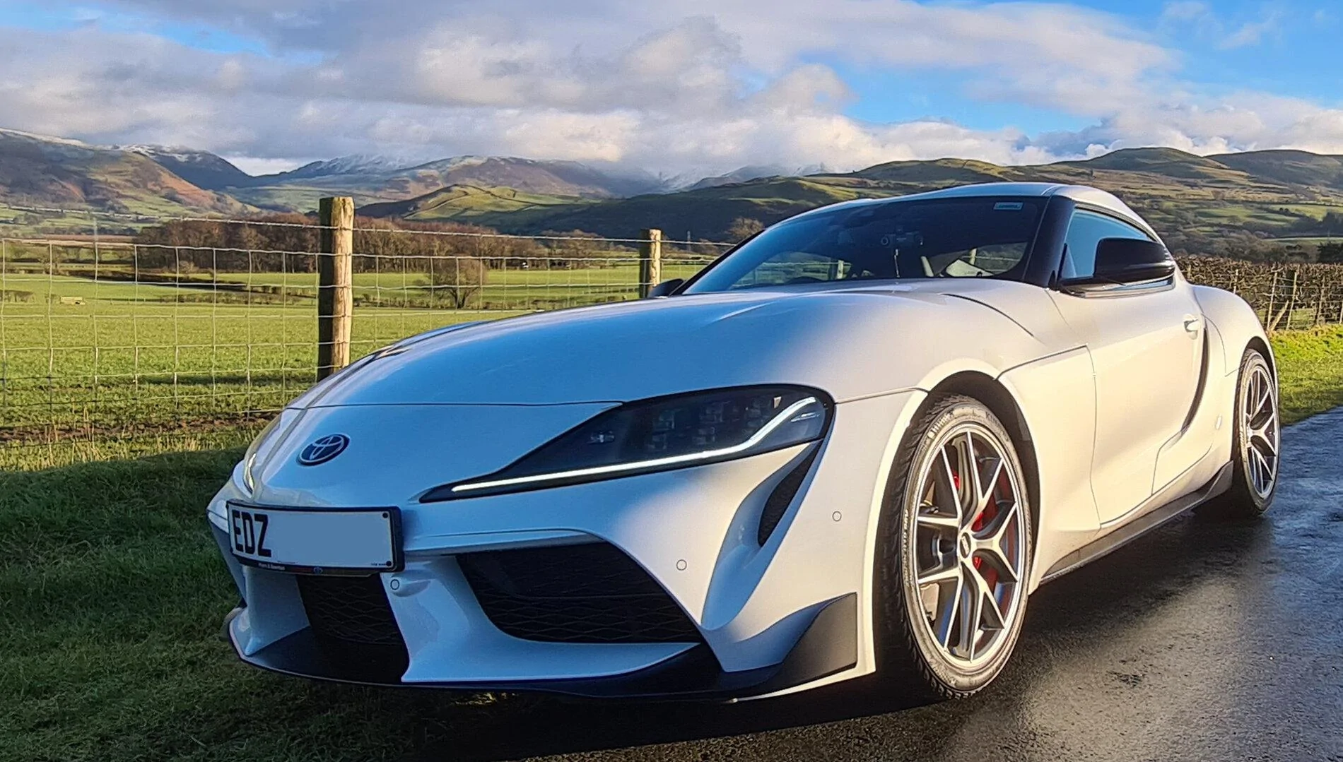

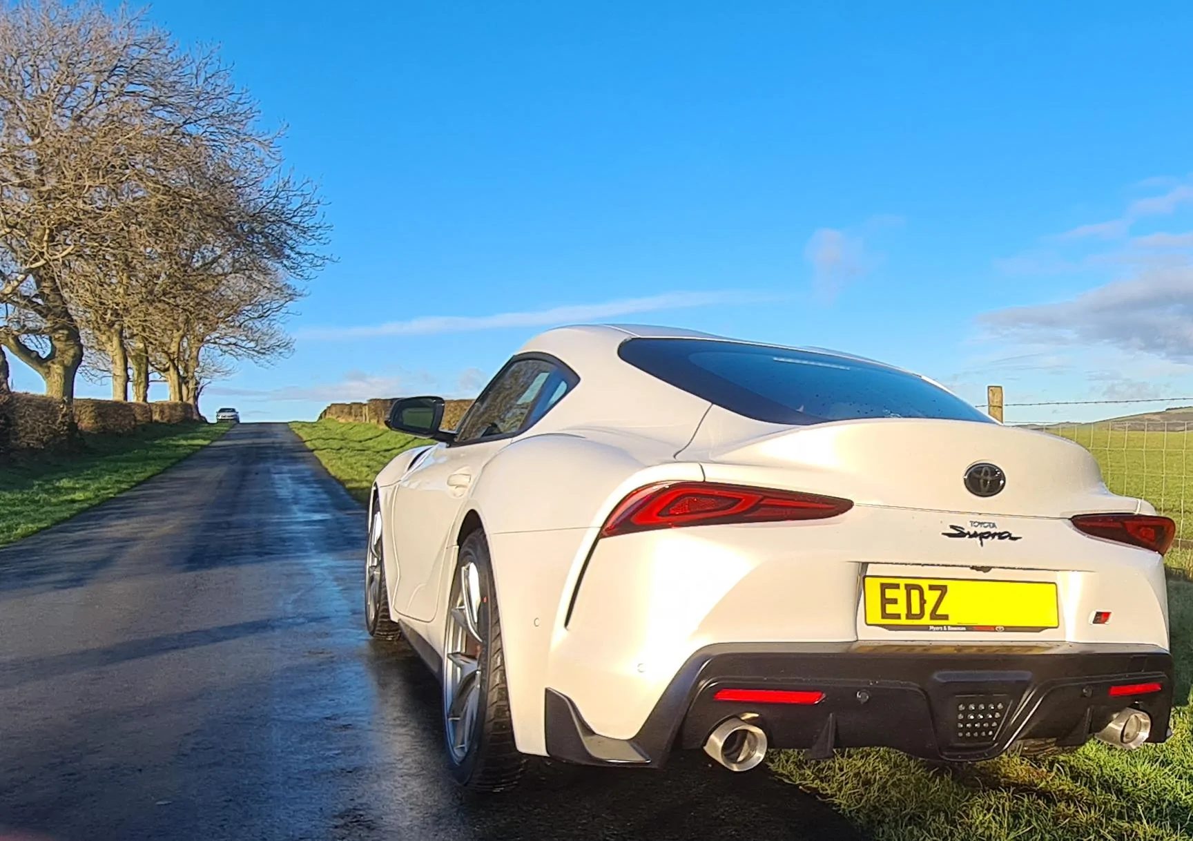

So after a bit of a tail to get my Winters, my Supra has been detailed and Ceramic coated with Titan coating. Really pleased she looks great and drives much better on these tyres for the colder weather.
Only got these two photos for now will do better next time i'm out.
Dang, those wheels look great. Nice countryside pic. Too. In other UK pictures I’ve seen it’s nothing but hedgerows blocking your view.
Wish the US spec plates were narrow and low profile like yours. Ours are huge!
