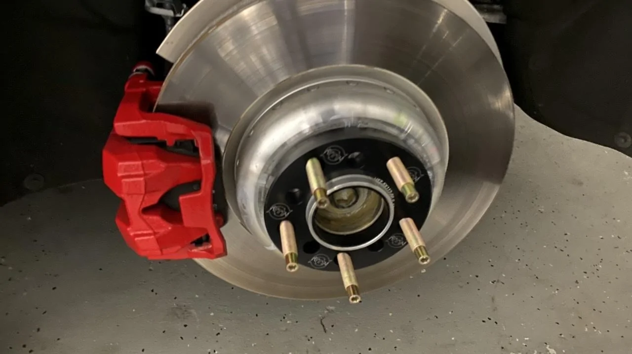

I didnt get a chance to install the entire set of 5x114 wheels I plan on using... I only checked one side (front and rear). Ill post an update here once I get the entire set on and actually drive the car.
Definitely want to use a hub centering ring that matches your wheels hubs to the Supras (66.6mm). I didnt have them yet at the time I tested the studs which is why I didnt drive the car. I just wanted to make sure they actually allowed the 5x114 to be mounted. The rings arrived yesterday so hopefully I can get a chance in the near future to fully test it all out.

Just confirming this conversion kit works if you want to run 5x114.3 PCD: Stud Conversion

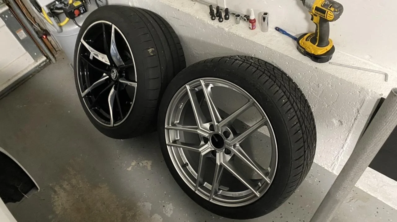

Tested them this weekend and was happy with the fitment. Its a bit finicky getting the wheel over the studs bc they have to line up just right....but they're good. If you dont want to see the stud, you'll have to come up with some sort of cap or 12mm lug nut to cover the stud.
Do you have any pics of the 5x114 on the car? I have the same Stud conversion but was unable to get the wheels on the studs correctly.. Tried CCW's and some cheap rep wheels. The bolt holes on the wheels are large enough, just didn't seem to line up correctly.

That’s funny bc someone else on here messaged me with the same issue. It was a little tricky getting the wheel to line up but I got it on. I do have a pic, it’s not the best but it still shows.
And just to verify…you’re using the included black nuts to mount the wheel right? You’re not using them to lock the studs to the hub…right?
Im wondering if there are some slight differences in machining from company to company which may be screwing some people up. The Enkei TY-5s I have worked without too much of a hassle.

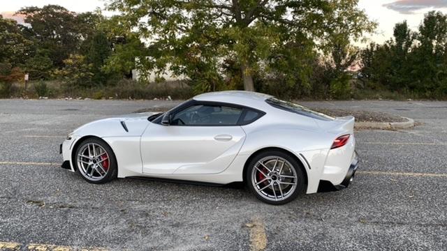

Bumping this thread just to confirm the fitment is very good. Finally had a chance to install all four wheels and go for a nice drive. I ended up getting aluminum centering rings to ensure proper fitment and don’t have any vibration or alignment issues at all. My only gripe about these is their length… 50mm shank length seems a bit too long IMO. But I guess their made longer to fit a wider range of wheel sizes.
Pics:
