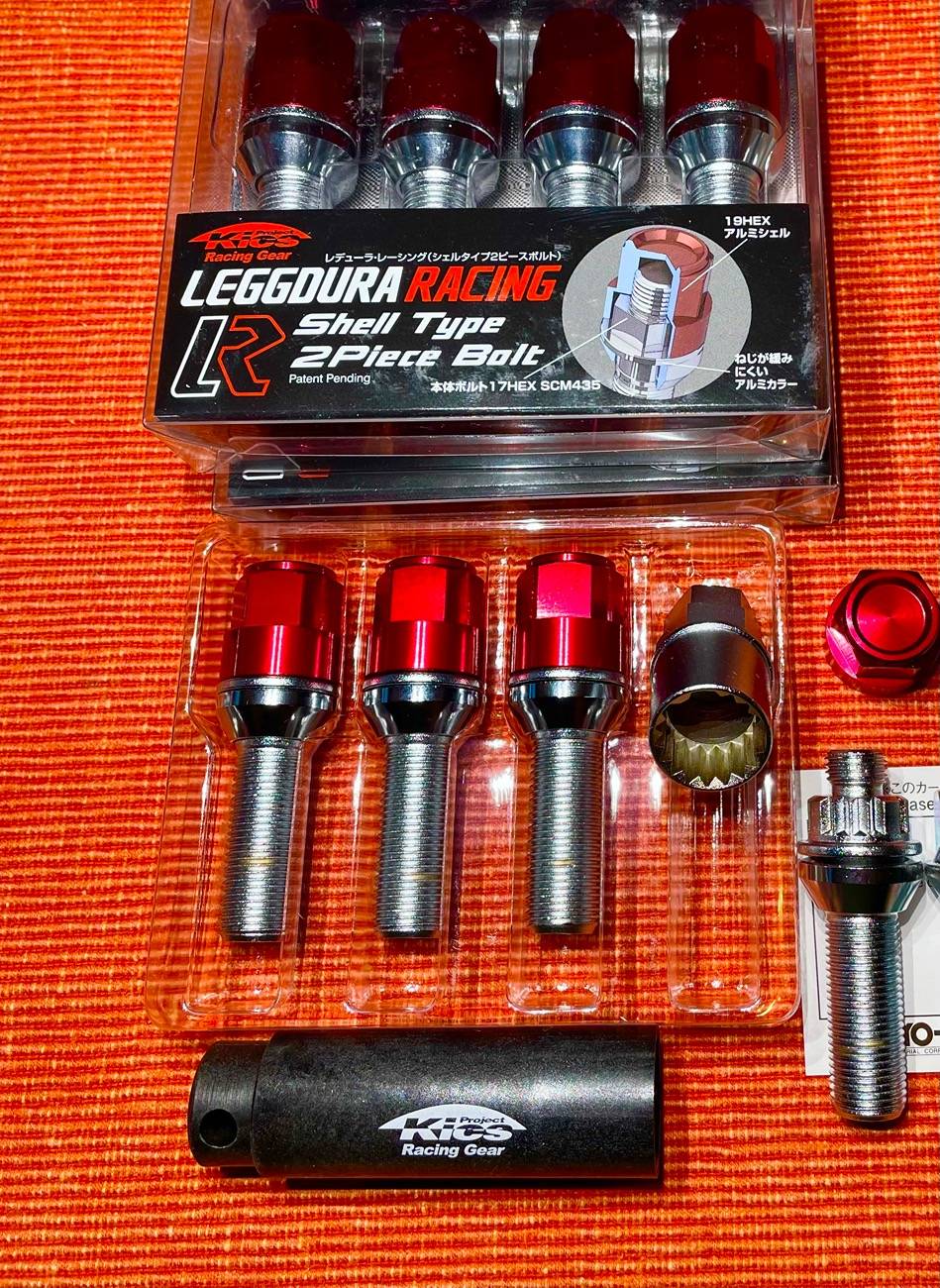

Anyone know of replacement lug bolts with the swivel washer to protect the wheels?
These are the ones I’m using. Longer than factory length for thicker aftermarket wheels.

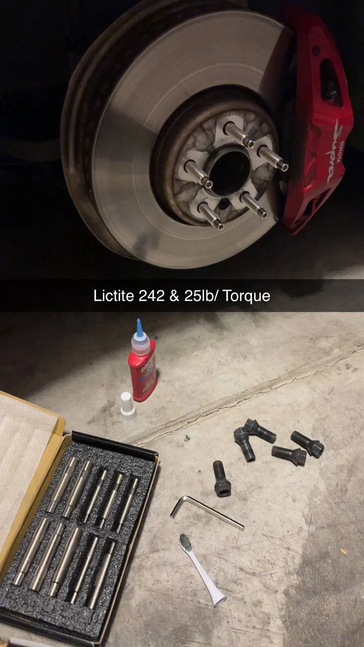

I don’t think 25 ft lbs is enough to keep them on if you are using impact tools. I used to have a set of Motorsport hardware wheel studs and they would easily back out even with loctite. I remember taking my car to a shop to get some suspension stuff installed. When I took my wheels off, the studs were loose.

Studs are more likely to fail because there are forces exerted on the screw in part of the stud, which causes fatigue in that area. After a while they just snap. Just take a look at these examples:
https://www.core4motorsports.com/gallery-of-broken-bmw-wheel-studs

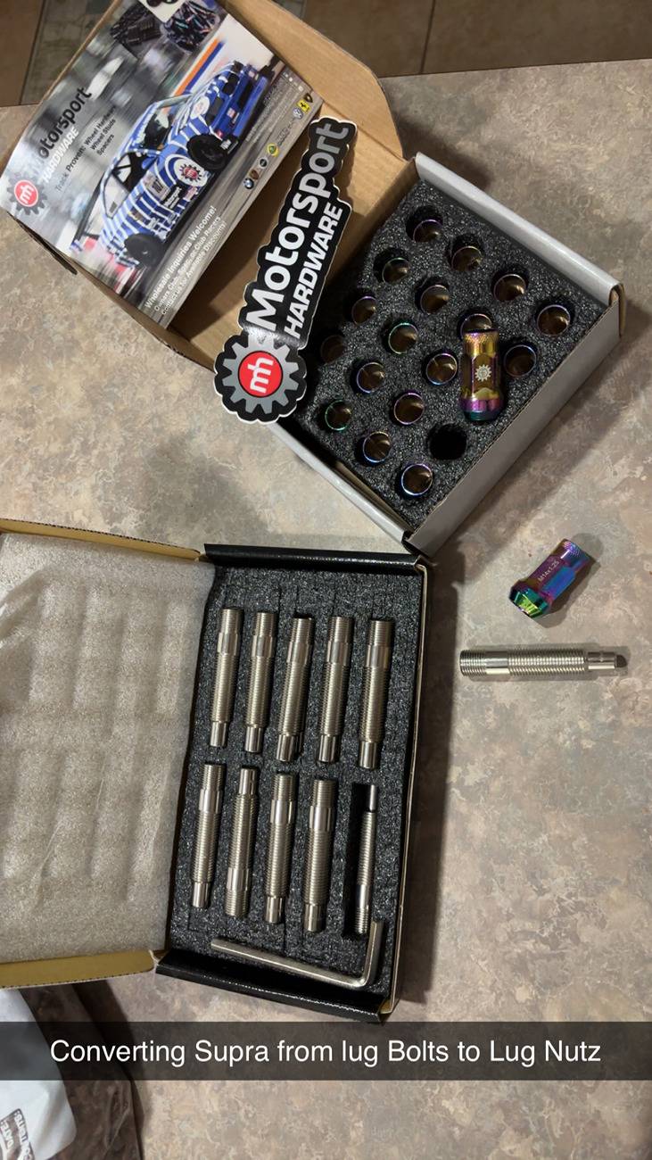

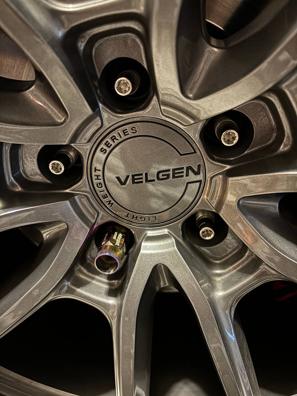

I have the same model wheels but in a different size, 18x10 square all around w/ 5mm spacers
I run the Motorsports Hardware kit M14x1.25 to M14x1.5 conversion w/open end monster lug nuts
How long have you been running the Monster lug nuts? I had MSH lugs that were less than a year old, never saw winter, and were too rusty for my liking already.
I ran them for almost two years until I swapped them out for a new set two weeks ago. They do rust as well, since I drive my car daily and it sees mild winters. I can show you a pic of the old lug nuts sometime this week.
