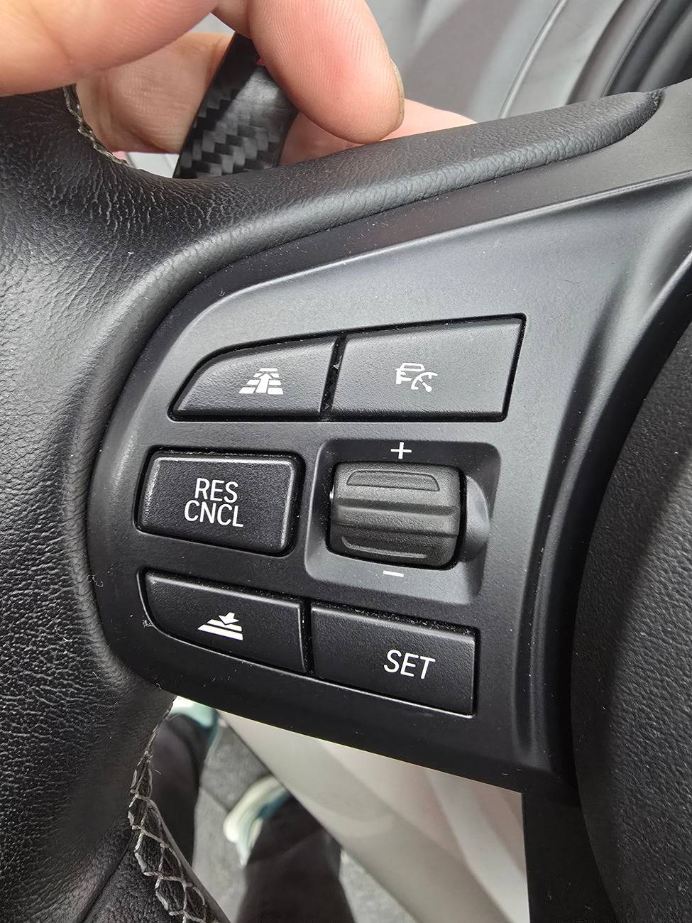

I understand ya and very nice writeup! Currently not running anything like line lock. But I do plan on going to bootmod tuning with flex fuel, so a concern of mine is if ethanal content reading, map switching, and anti lag will work since they work off using the cruise control scroll wheel if that make senseJust left my shop and was playing with the button layout and made sure every feature was mapped to the wheel. I believe we are missing a button or maybe the way it works is not the same as for the supra (I see all the features are from BMW).

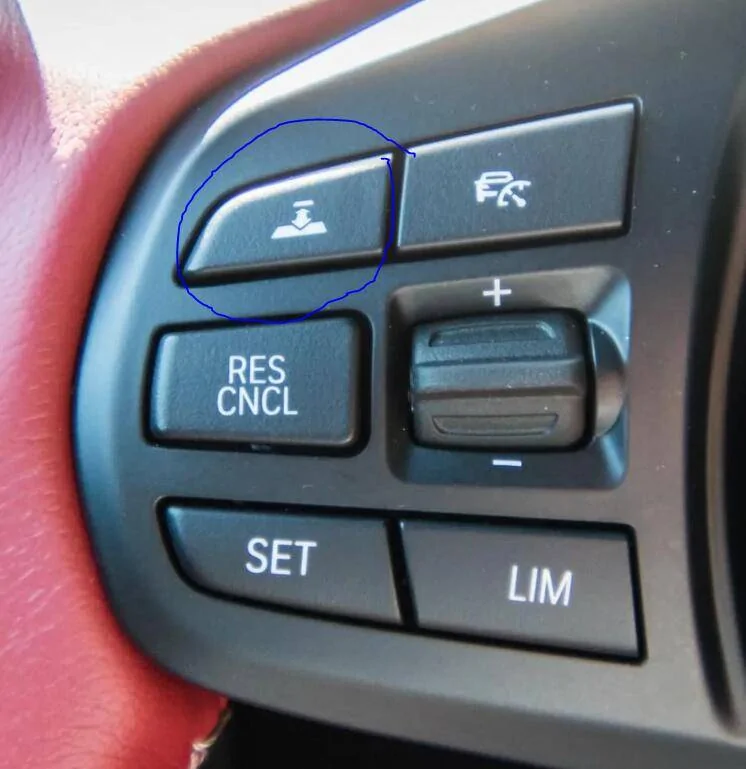

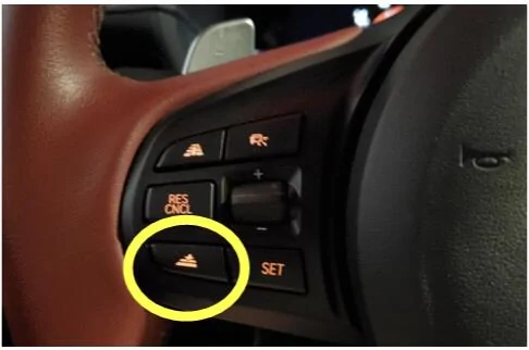

This all came about because I have a line lock setup from Twisted Tuning and I can not get it to activate because the distance decrease is not available.
Here are the available options inside the Zestek program. If your supra isn't then everything should work. My only issue is with the Cruise Control mapping.

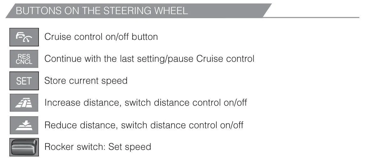

These are the cruise control buttons on the stock steering wheel.

- Distance - Should have an increase and decrease option not just one.
