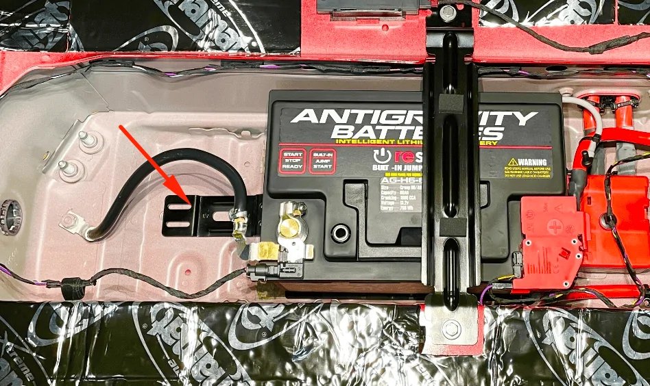

Almost 64 LBS, its a chunker for sure. ?
Its makes a big difference once you ditch it.

@zrk what did you use to secure it on the left side? I had to dig out a bracket from my toolbox since the stock one didn’t reach.
-RJM
8,472
14,122
-RJM
Stock one with included bolt. It fits.

Can you please tell me what this mount is? I want to install mine H6 battery and dont know how to fix it
-RJM
anti gravity batter comes with a bracket.
Mine didn’t come with a bracket. That’s a spare bracket from my tool box. The OEM bracket was stubby and couldn’t secure the new battery.

@baagel I found another spare bracket in my toolbox. If you still need one let me know I will gift it to you.
-RJM
I'll be alright, I have an H7 size battery and managed to squeeze the OEM bracket in enough to secure it. Thanks though!

Replacing mine today. What about the little hose thing that goes into the stock battery on the right side? I'm not seeing a hole to put it in on the AG.
I swear to Christ the next time I do this it's going to be with a car built in the 90's...
That's a vent tube for AGM batteries in case of malfunction. The chemistry of lithium ion batteries does not require that. You can safely tuck it away.
