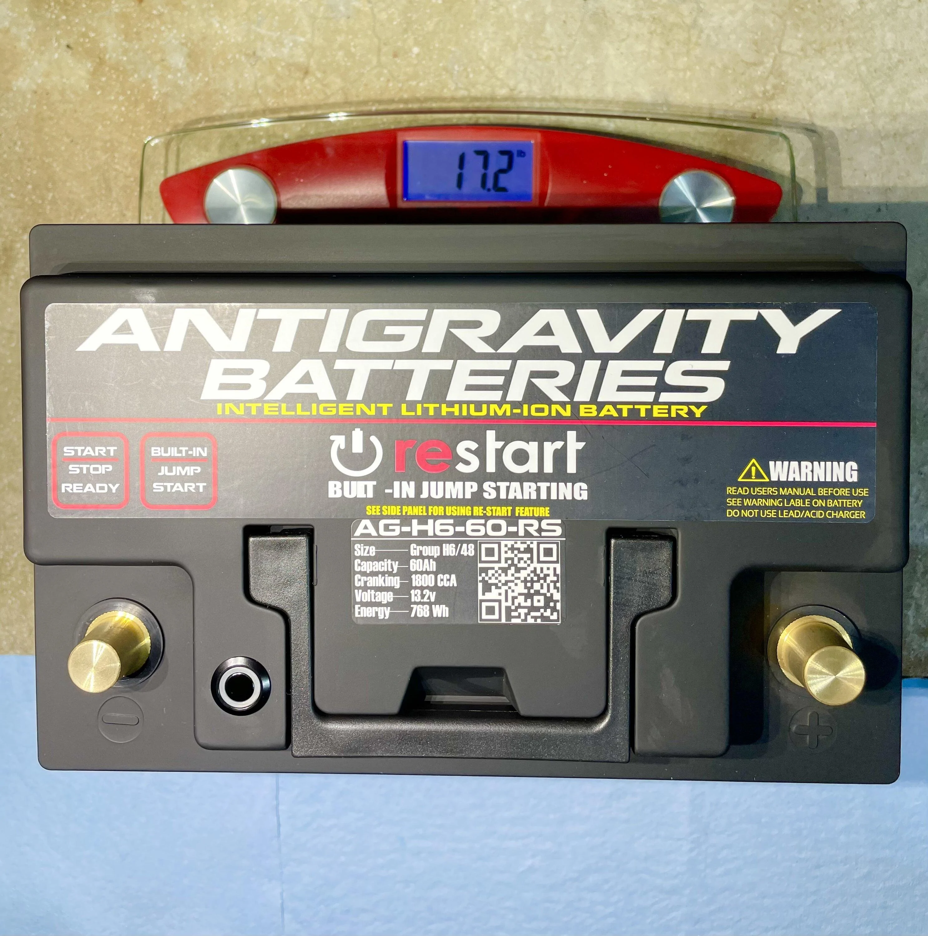

For Anti Gravity is a H6 48 amp? 60amps? Is that what you would recommend? Other suggestions tips? I think this may be the route I'll go now.

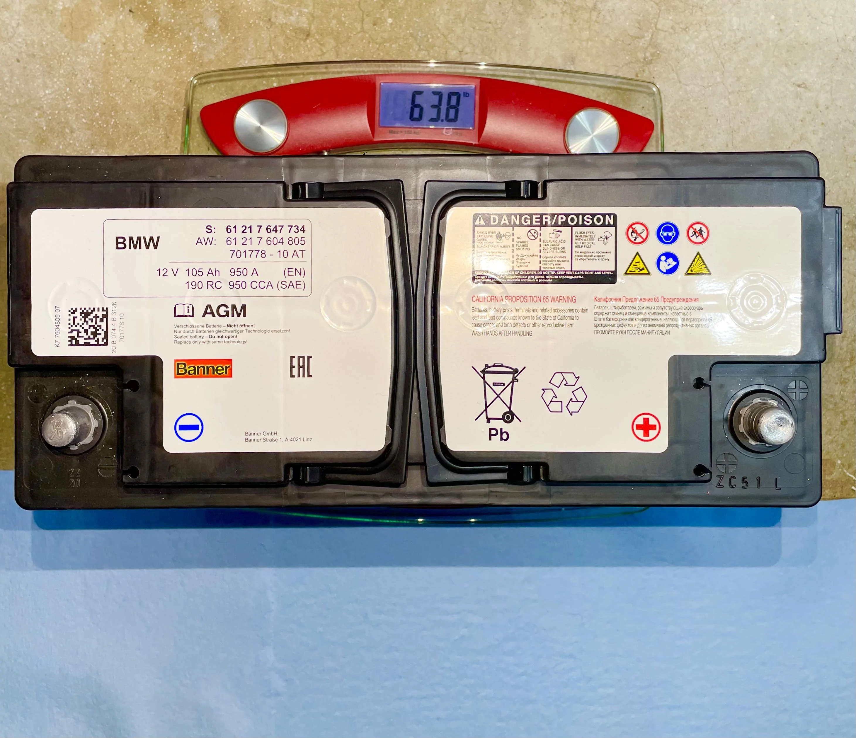

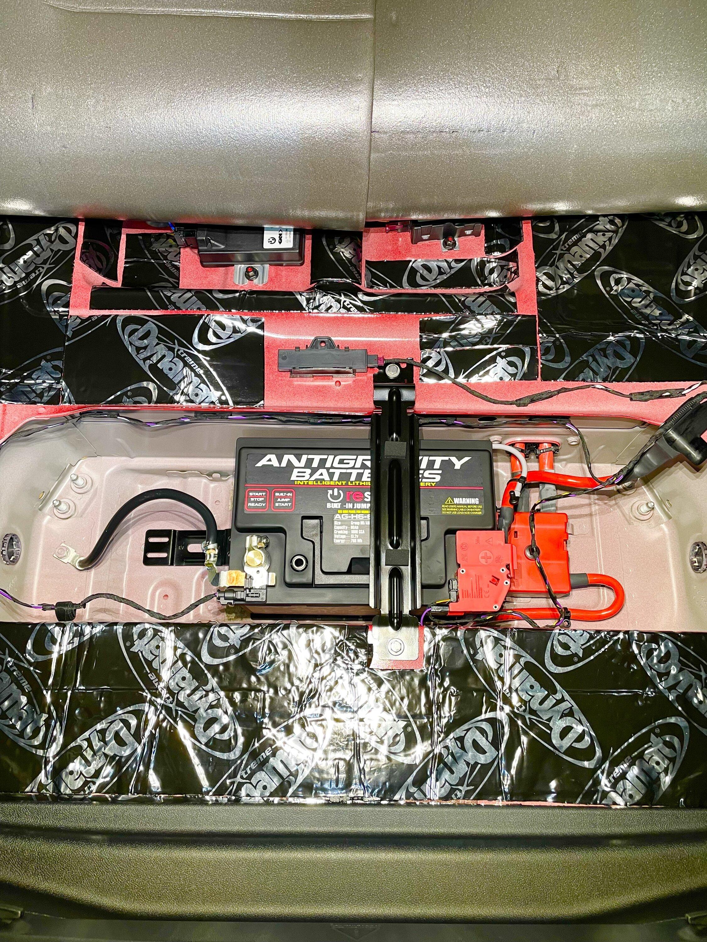

I was able to drop 75.8 LBS and it made a decent difference on launches and 60-130 mph times.
- Anti Gravity Battery (-46.6 Lbs)
- Courtesy Cover (-5 LBS )
- Cheezy tire fix kit (-4.2 LBS )
- Covid gut (-20 LBS )
Total weight reduction = 75.8 LBS
-RJM

Almost 64 LBS, its a chunker for sure. ?
Its makes a big difference once you ditch it.
-RJM
I'm curious if you've had any issues running the 60 Ah battery. I daily my Supra and would really like to grab one of these. I imagine the sound system would be the biggest source of charge consumption, though I'm on the stock 3.0 Premium system.
Any thoughts on running even lower Ah ratings?
No issues at all with the 60 aH model. I don’t daily my car so I connect it to a Ctek battery tender after every drive.
If you daily with this battery setup you should be fine not using the battery tender.
I wouldn’t recommend anything lower than 60 ah unless its a trailered only track car.
-RJM
