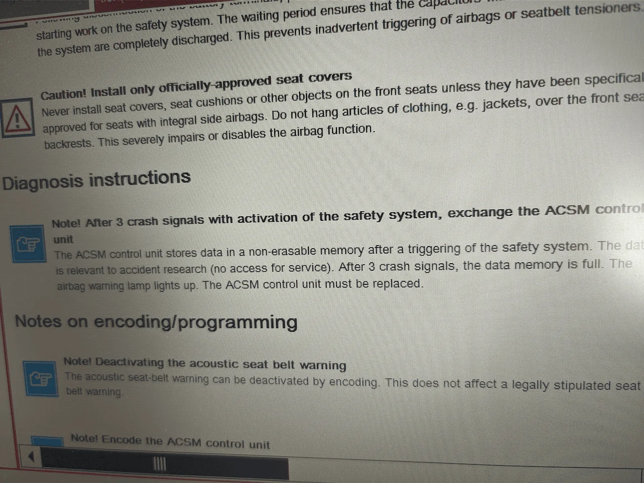

The airbag ECU (ACSM) will hold up to 3 crash datapoints (crashes) until it needs to be replaced & reprogrammed, then its $$$$ or $$$$$.

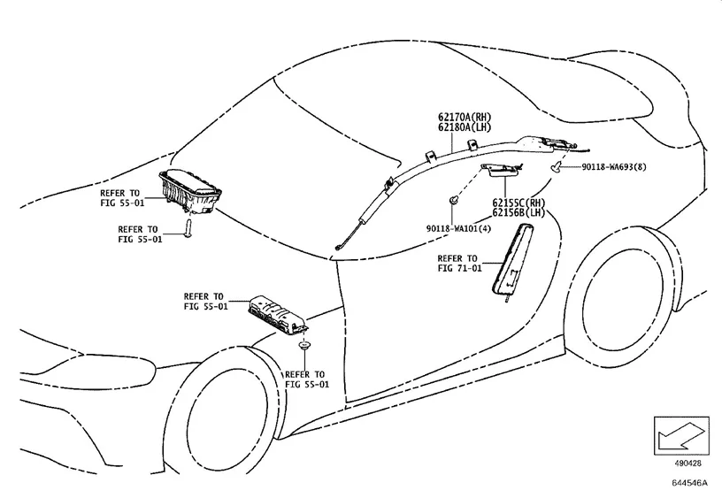

The headliner will need to be dropped to make removal/installing easier but not entirely removed.
Just rest it on the steering wheel and seats.
See page 2884 of the workshop manual: https://www.supramkv.com/threads/workshop-service-manual.2415/post-138353
Visual diagram/illustation on page 2881/2882.

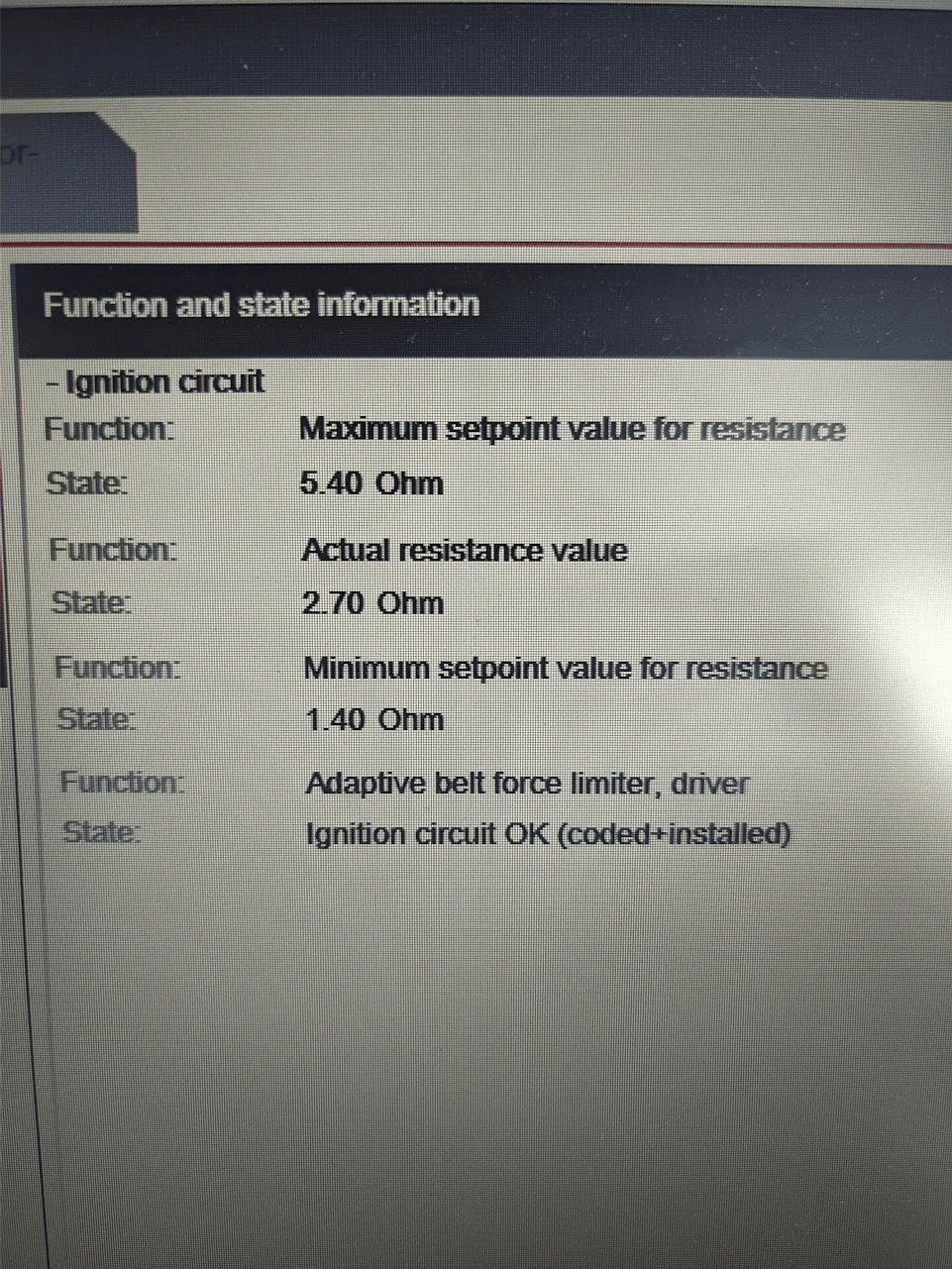

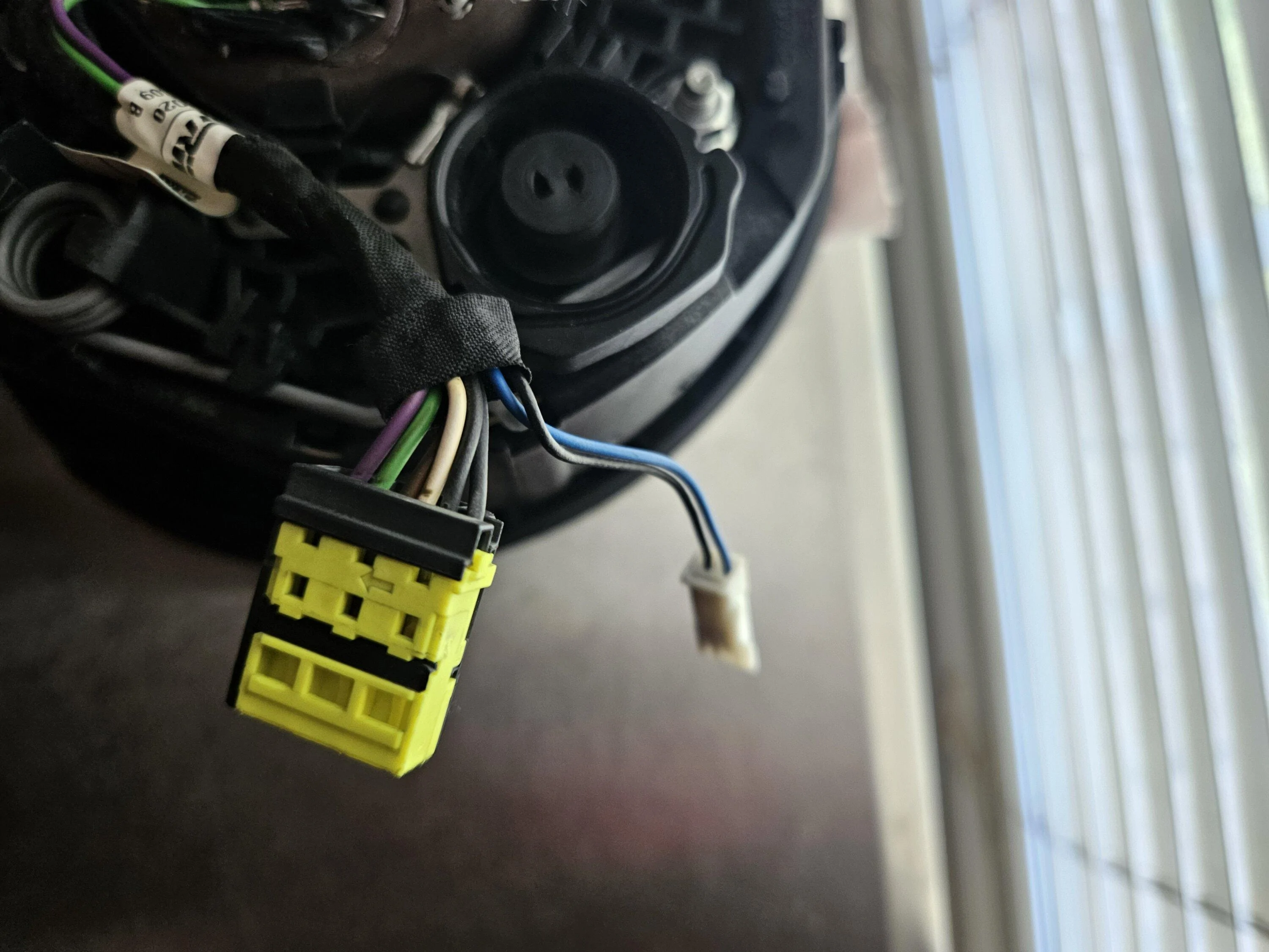

So say I wanted to go to an airbagless steering wheel. Could I essentially make a dummy plug with a resistor to remove the airbag light?
Tsuki8
May 28, 2022
342
504
TX
21 E50 WMI
Yes, takes 3 resistors.
(2) for the dual stage airbag, (1) for another circuit, from what I remember.
I did it to test the circuitry.
Basically the 6wire yellow plug:
(1) resistor for White + Brown
(1) resistor for Purple + Green
(1) resistor for Black + Black
3.3 Ohm 1/2 Watt resistors used.
The Blue + Black (2wire) plug, I believe is the horn.

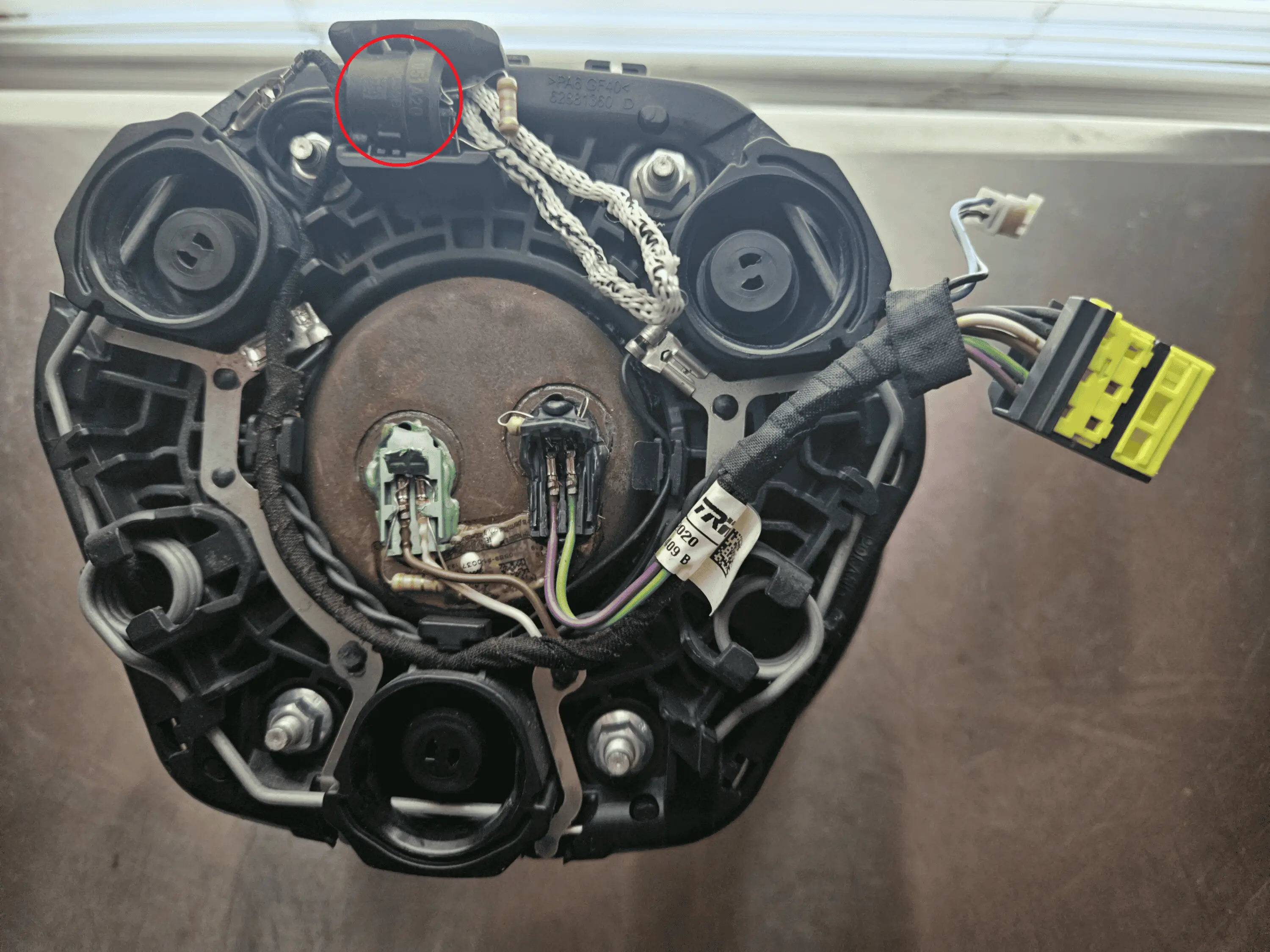

My blown airbag with with resistors:

So this is what I’m looking at. What do I need to do?
Tsuki8
May 28, 2022
342
504
TX
21 E50 WMI
Left plug, however you wish to connect them.
(3) 3.3 Ohm 1/2 Watt resistors.
Could depin the existing plug and wire in the resistors.

Have to clear codes, since they went open circuit.
Lights wont go away on their own.

MSport said:
I already put it all together and it didn’t work. ?. I wonder if it is tied into the the other conector
I'm not 100% sure, but I think the part circled has to be wired in. In this video they just throw in the resistor, but that black piece is wired in. Once the airbag harness is installed, the airbag light is gone.

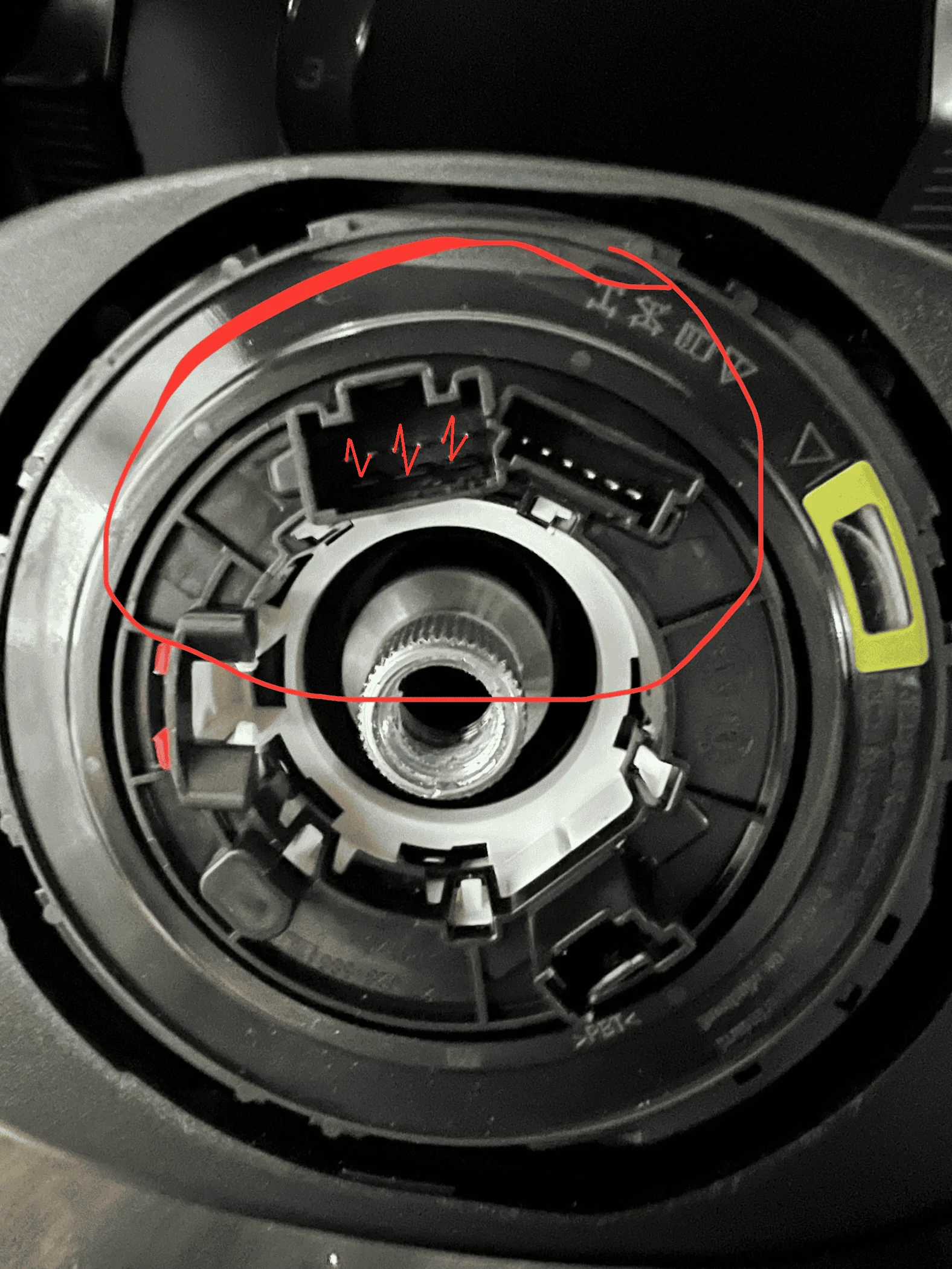

if 1 pin on this connector broke cause the connector from the steering wheel was clug when i got it what should i do from there ?

Sorry to revive this thread, but when you say the module stores 3 crashes did you mean 3 separate crashes? Or just 3 airbag deployments? I had 4 pop do I need to send the module out or am I good to put them in and just clear the codes? Thanks!
