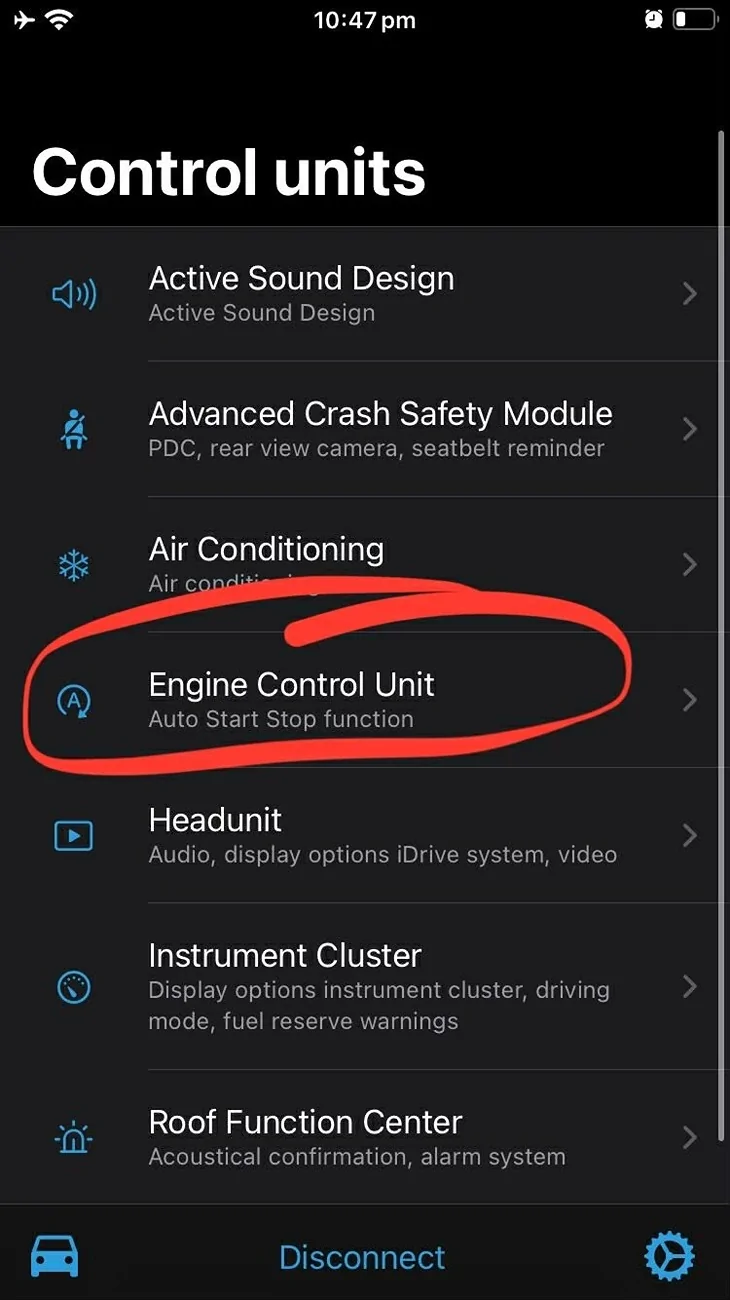

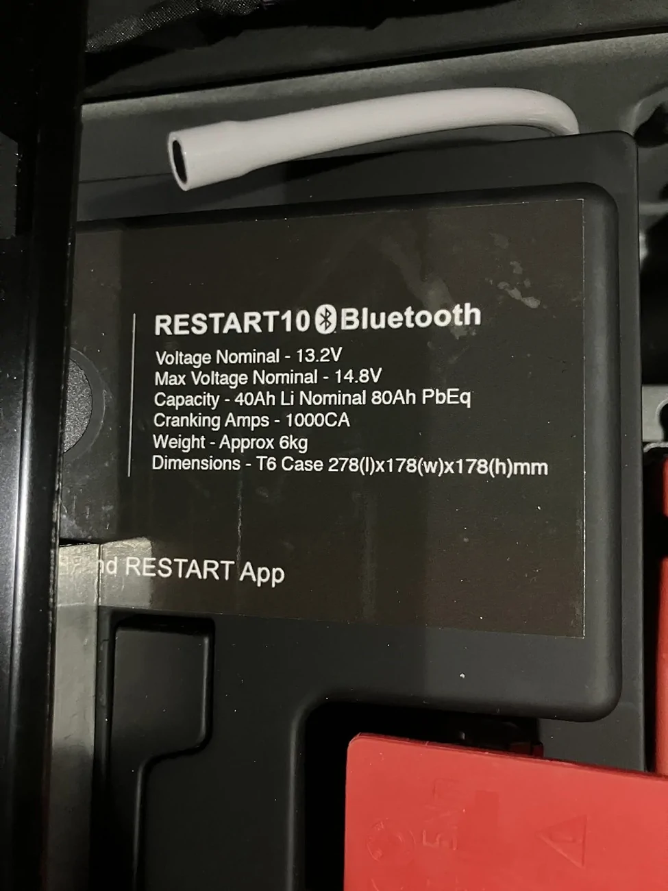

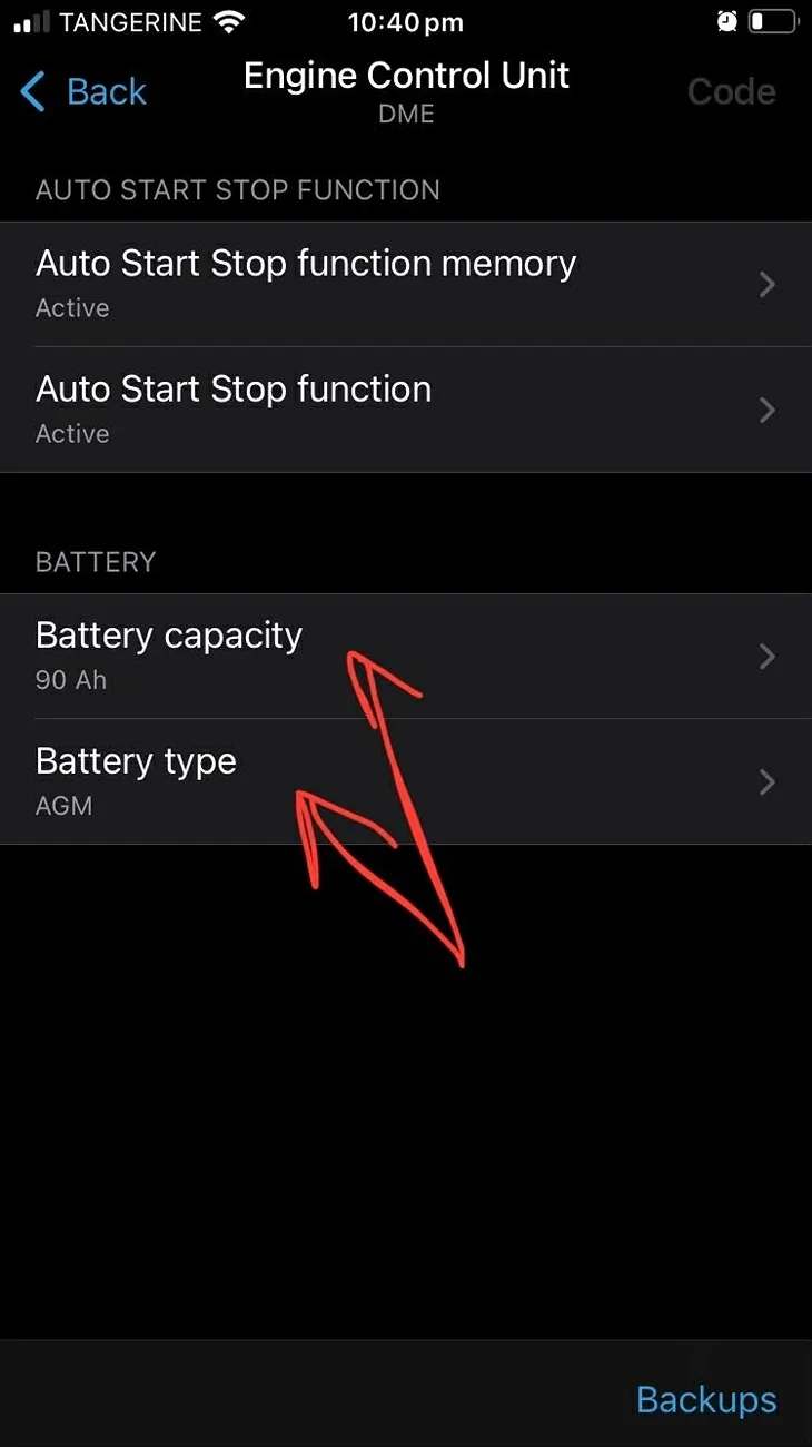

Just to try help, I used this thread to code my Lithumax battery recently.
I fitted the battery and just left it without coding as others have said, but I found whenever I dropped to very low rpm usually in 5th or 6th gear my instrument cluster would drop out and the car would lose power for like 1-2 seconds and figured it was related to going from the stock AGM to aftermarket Lithium battery, which seemingly was the case (My car is m/t also so that might also have an impact).
Anyway, you can change battery type & capacity via Bimmer code, ref images attached. All battery coding options can be found under "engine control unit"

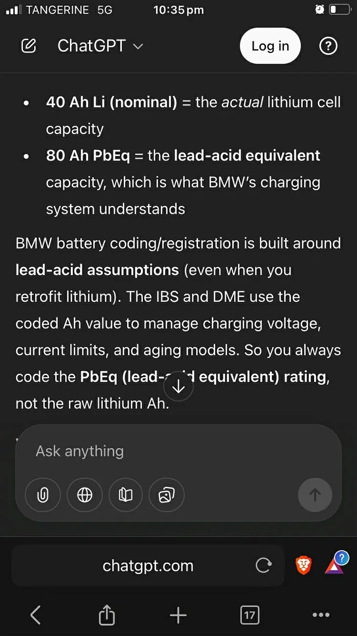

I ended up using chat GPT to convert Li Ah to AGM Ah, but this didnt work in the end, from memory the stock battery was 100 Ah, i coded the Li battery to 80 Ah but still found the cluster dropping out, I've since dropped the Ah rating even lower again and it appears to have resolved the issue.

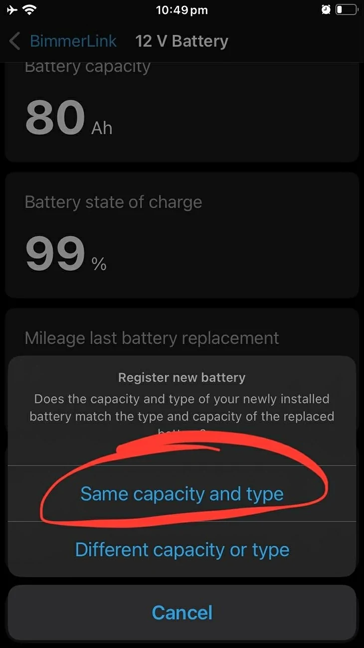

So yeah, change your Ah and battery type to reflect what you've fitted then code that to the vehicle. Then use Bimmer link to register the battery, it should automatically detect your new battery type and Ah specs and then just press register new battery.
Cycle cluster, clear faults, all should be okay.
