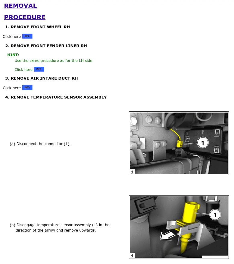

Have a 2020 and think I have located the sensor peeking into the passenger side front brake duct in the bumper. Has anyone taken this on? Going to lift the radiator and take a look.
Is this a remove the front bumper project? couldn't find a diagram that hints at an access hint so feel free to share any and all info.

Hey there, @gpcustoms
Were you able to do this without too much intrusion to the rest of the car?
Mine just faulted unfortunately.
