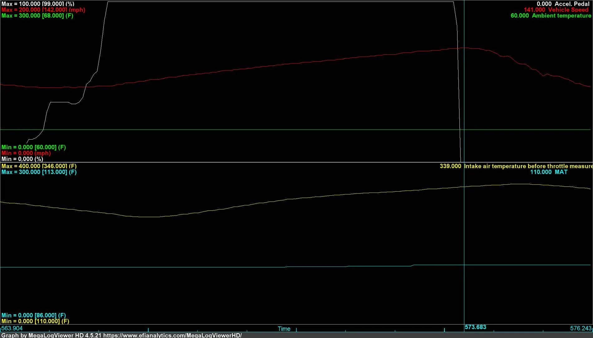

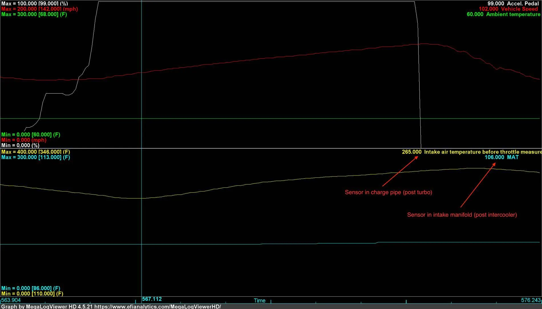

The hotter one is on the charge pipe. The other one is on the intake manifold after the intercooler.
Example of both sensors at WOT:

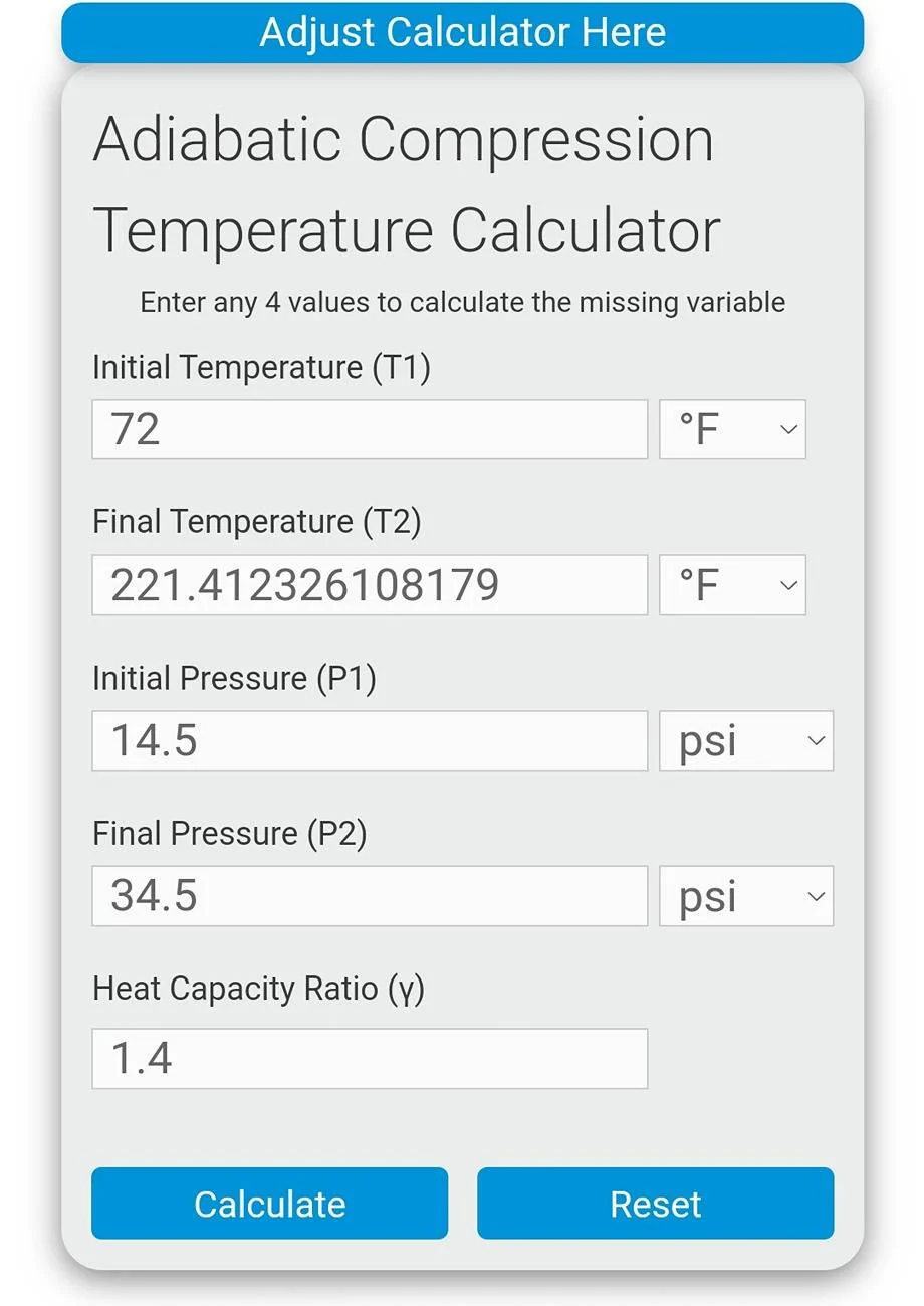

Thanks for these graphs. Now I have a better idea, maybe it's worth directing air to the filterbox inlet.
air will always heat when pressurized, because the compressor is performing physical work on the air. even with a magical 100% efficient compressor, things are already pretty hot.
example for 20 psi boost:
221-72=149
If you factor in the fact that compressors typically have a peak efficiency of 75-ish percent, multiply that temp rise by 1.3 to 1.4x or so. That is how you get air charge air temps in the neighborhood of 300 deg.
149*1.35=201
72 + 201 = 273
You can imagine that cooling the inlet air by 5 degrees is pretty much a throwaway. your time and effort are better spent on the intake manifold.
