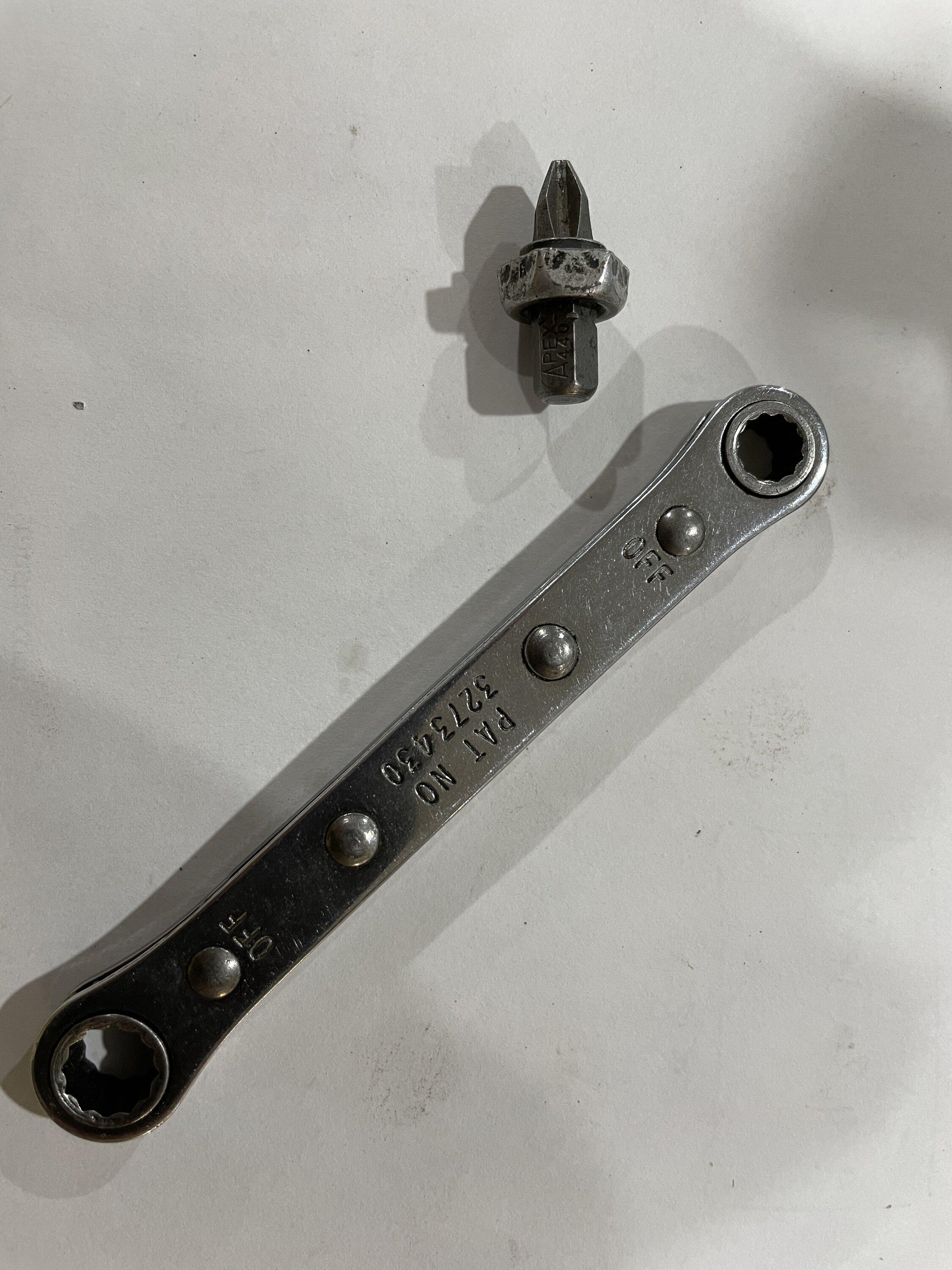

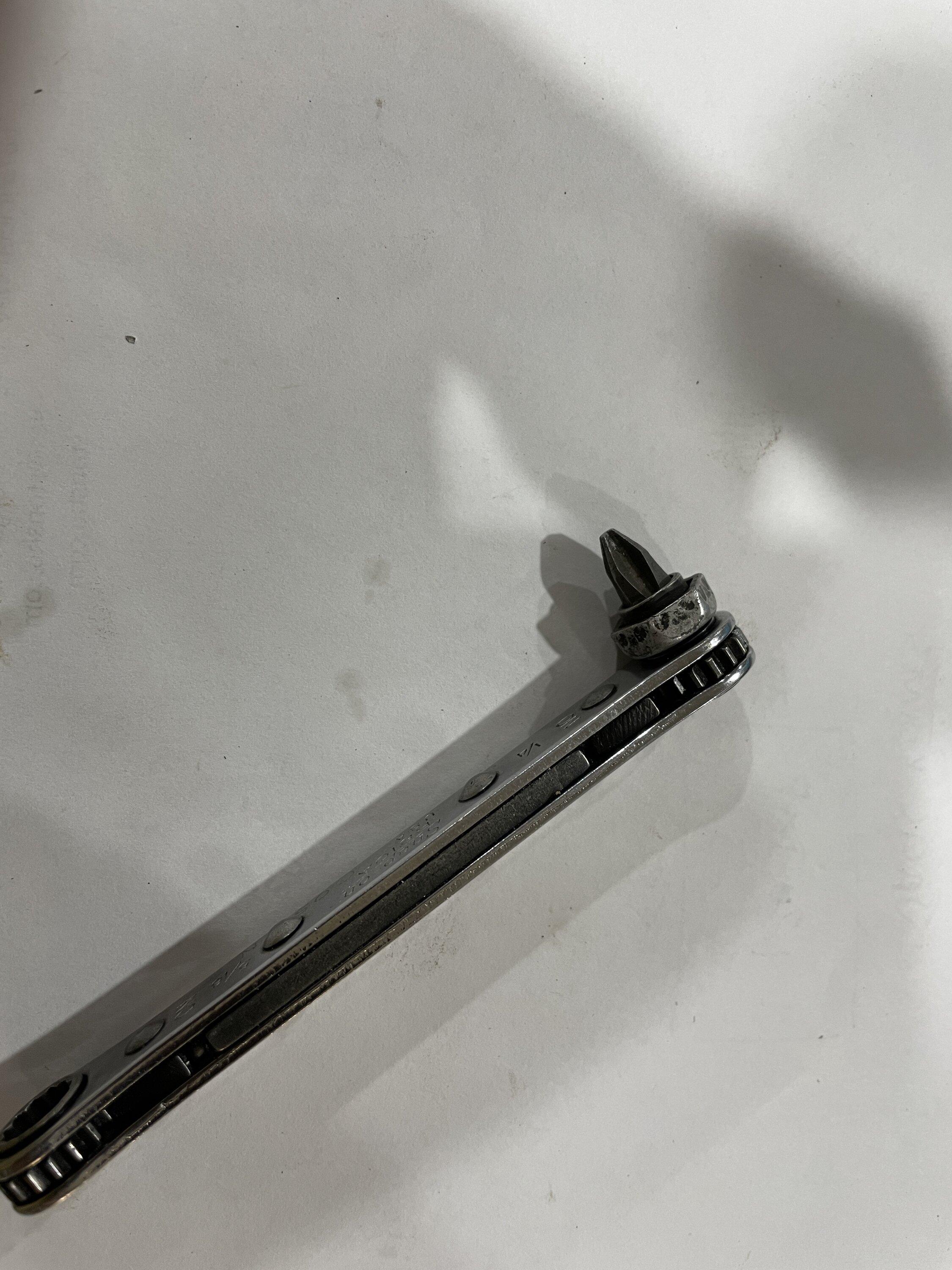

Someone mentioned the tool clearance issue for the mount screws for the ZL1 rock guards when doing the rear wheel wells. Here is a simple and useful and very space efficient tool for phillips bits. Just drive an 8mm nut over the phillips bit and use a 1/4" ratchet ring spanner as a right angle screwdriver. The nut pressed over the phillips bit allows you to push on the bit and keep the drive in the screw and apply pressure as you turn it. Here's my 50 year old Snap On 1/4 x 5/16 ratchet ring spanner and a tool mentioned I made god knows when (although I used to use a 5/16 UNF aircraft nut back in the day) Very compact and useful and the better quality ratchet ring you buy the better as the quality ones have a fine ratchet action allowing for smaller bites at turning in confined spaces. Saves rear wheel removal.

I fitted the ZL1 rock guards today rear wheels on and used the tool mentioned in this thread post #106 along with a Snapon 1/4 drive ratchet and 8mm socket. Absolute piece of cake, 5 min a side, no swearing.
