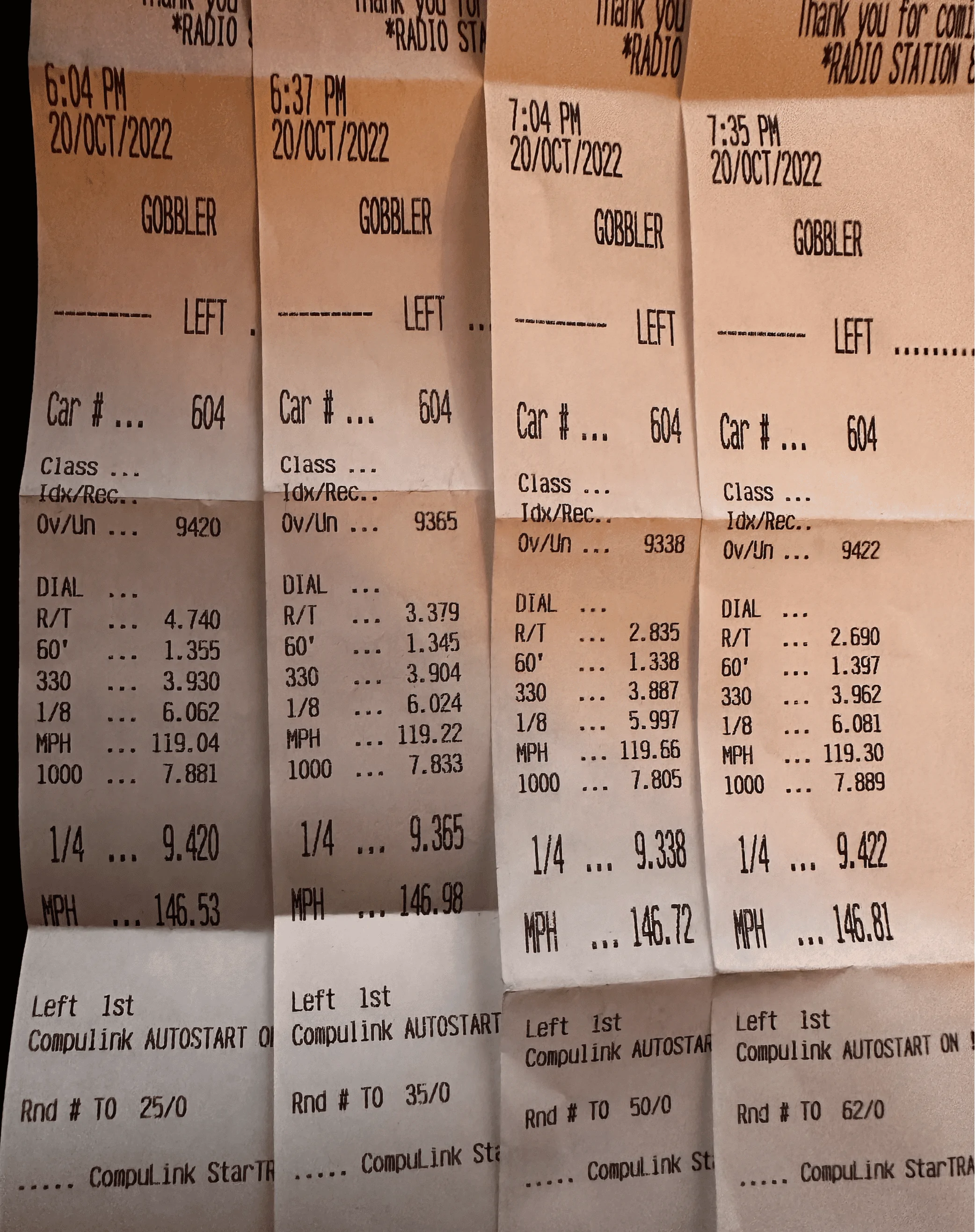

I don't usually post slips, but last night was great. I made 4 passes, all under 9.5. I'm super happy with this. It was a test and tune night, so I didn't care about RTs. DA was in my favor.
F**kin A…that’s movin.
The 60' ft. times are crazy.
slow
