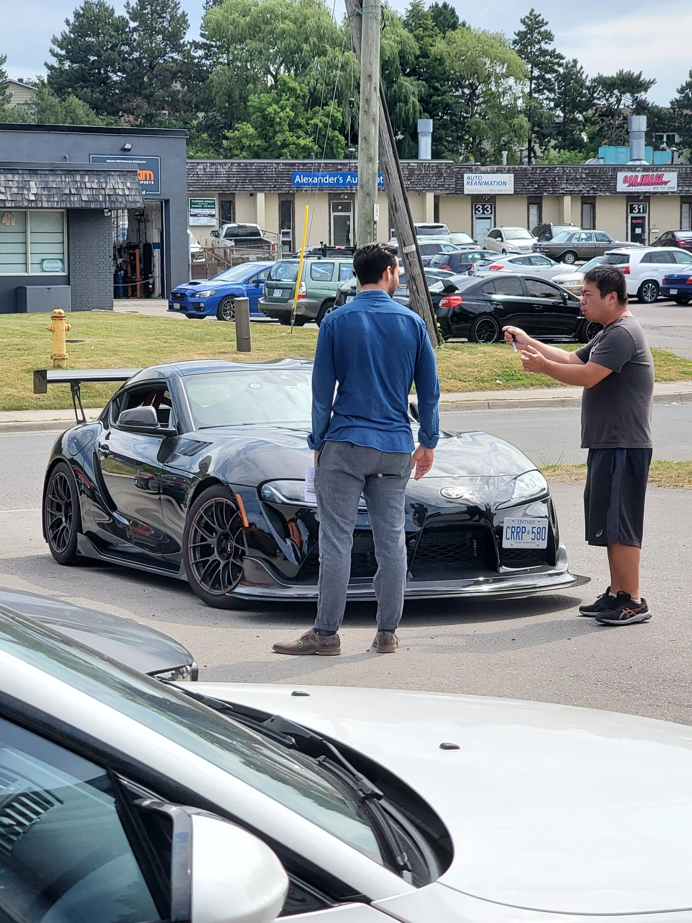

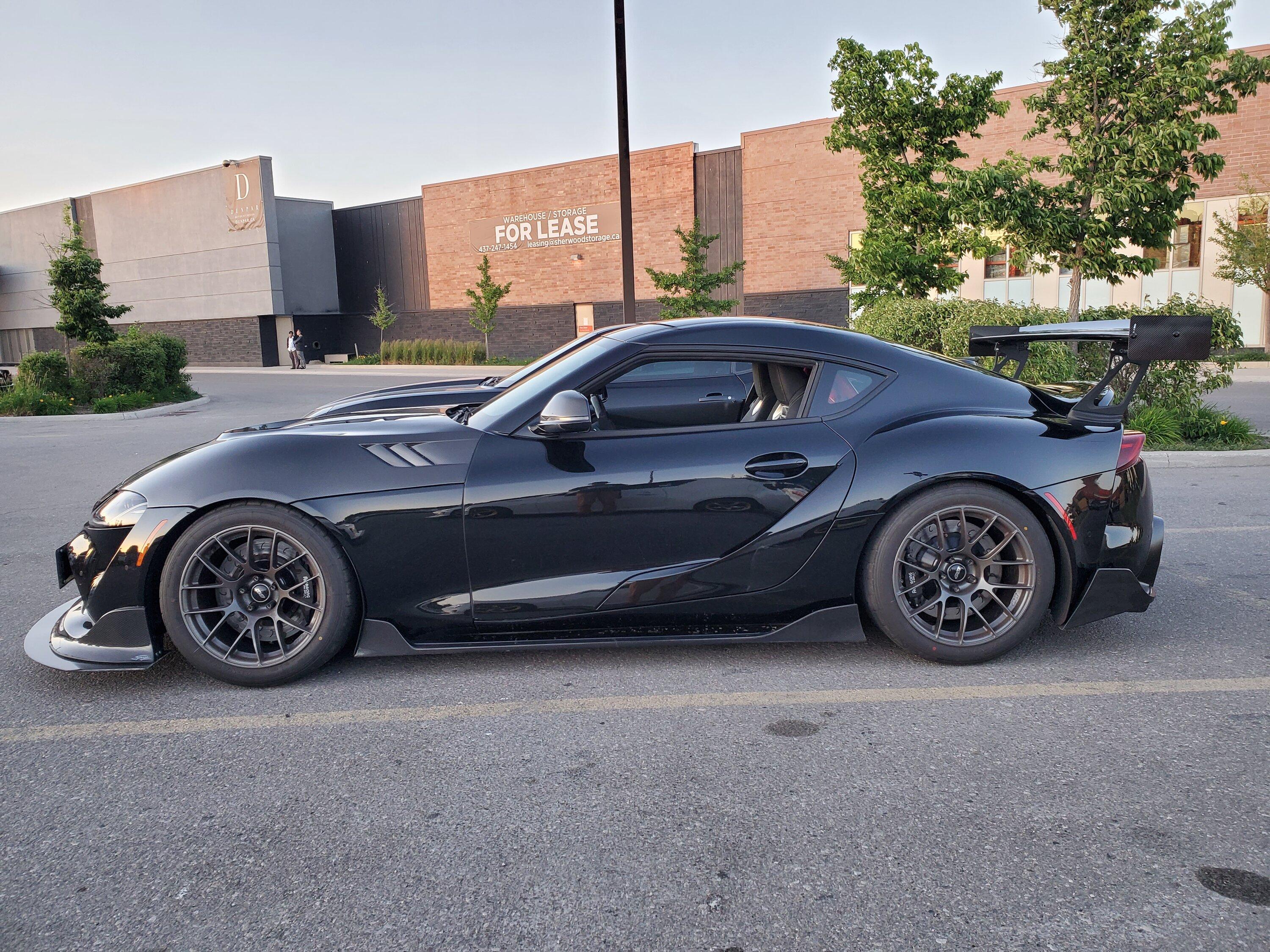

Late to the party... Here's my car with Apex wheels on + 295 square a052s.
Epic setup! Mind If I add your photos to the 18x11 square thread with notes? Would love to get the alignment specs and fitment notes from you when you have a chance to reply. Thanks for picking up a set!
-Tom
Yes totally.
Apex 18x11" EC7RS
Yoko A052 295/35/18 Square
Front Camber: -4.2
Rear Camber: -3
Front Total Toe: 0
Rear Total Toe: .3
Caster: 7.x
Fitment is good. I have a steering rack limiter installed to prevent me from hitting on full lock.
Performs very well on the track. I will try 315 square next year. Seems there is plenty of space to fit, rear for sure, fronts maybe just limit the steering rack a little more.
Square setup compared to my other staggered setup gives me way more bite in on corners which is good or bad depending on your driving style.

Excellent, Thanks! I'll get these notes added to that thread. Enjoy those wheels!
