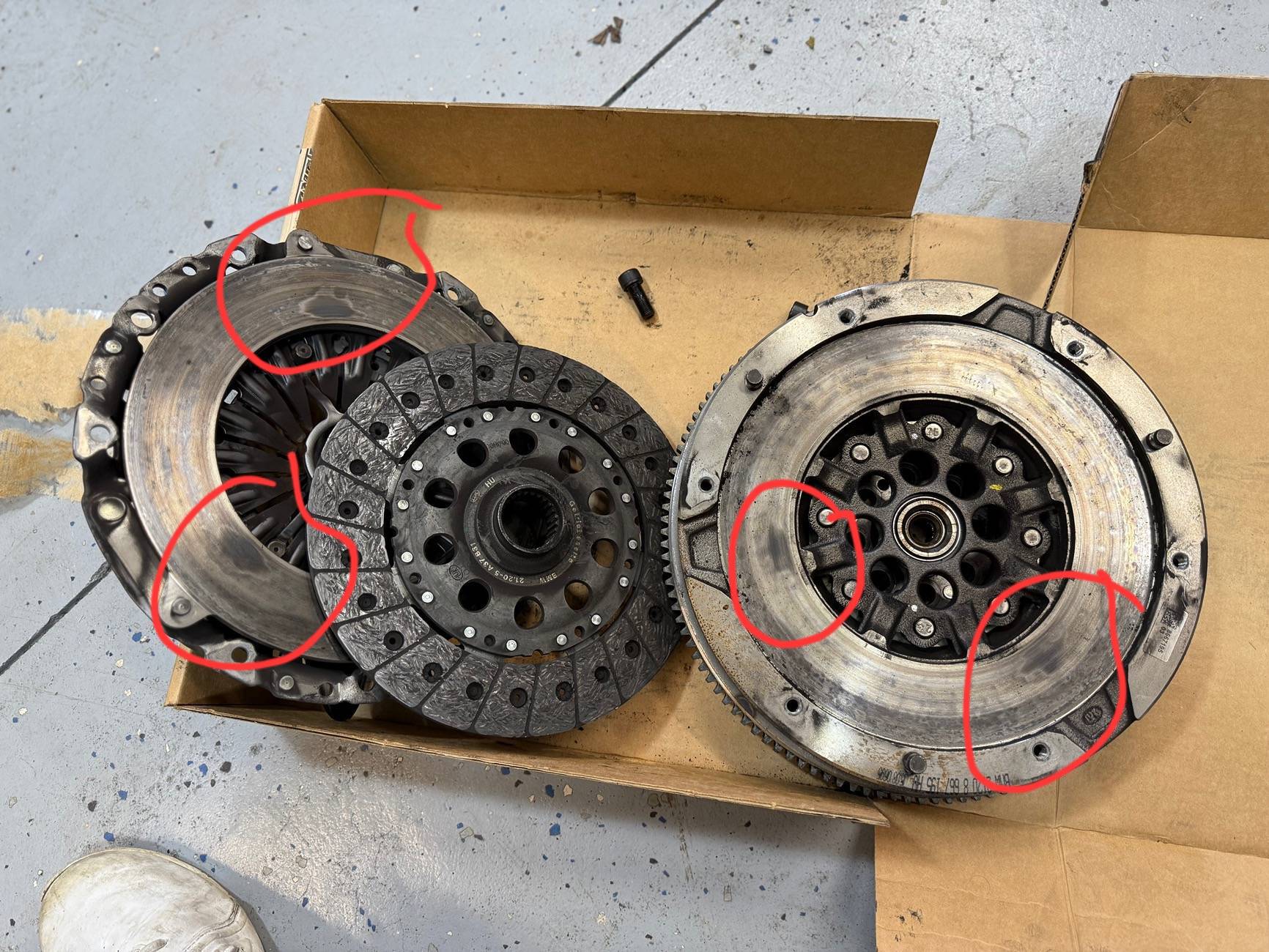

@Cfdproductions - About how much power do you think you make? I saw the mods but wonder if you've got an estimate? 500hp? I'm kind of curious how much the stock clutch can handle (or, not handle, obviously you've gone beyond it).
My 60-130 times say I’m around 475-500hp prob 550+ tq and it was just starting to slip on hard shifts

Couple discolored/hot spots on PP & FW? Hard to tell if there is any damage to the disc itself. Hopefully new setup has enough clamp up to put up with the forthcoming abuse.

****UPDATE**** Just unlocked the car and put MHD E40 on it and it seems to be taking the abuse. Pedal is still a little stiff feeling (30% heavier i would estimate) and when on a hill it is an on/off switch so its a little hard to slip but drivability is still pretty good and my leg does not get tired.
