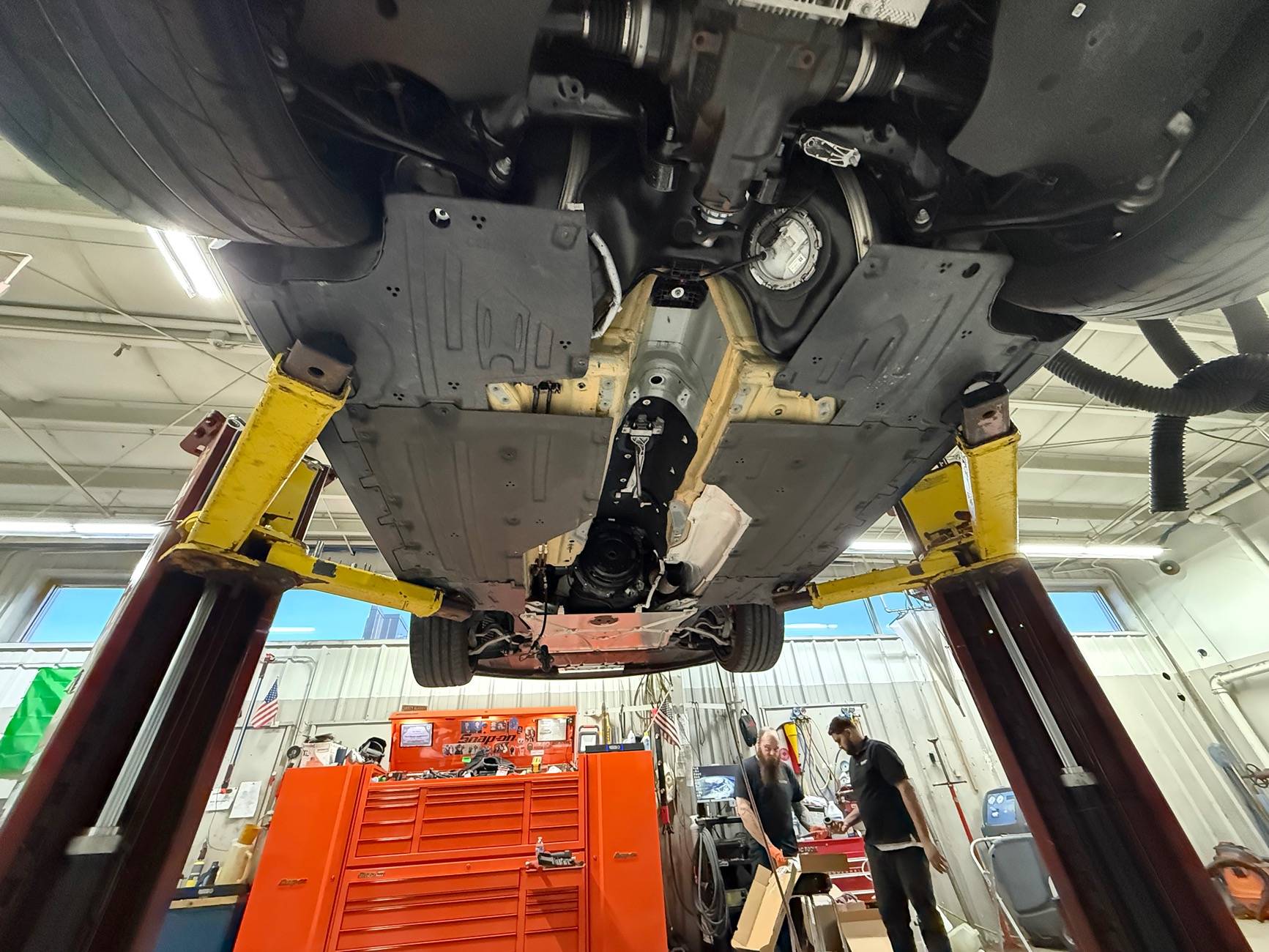

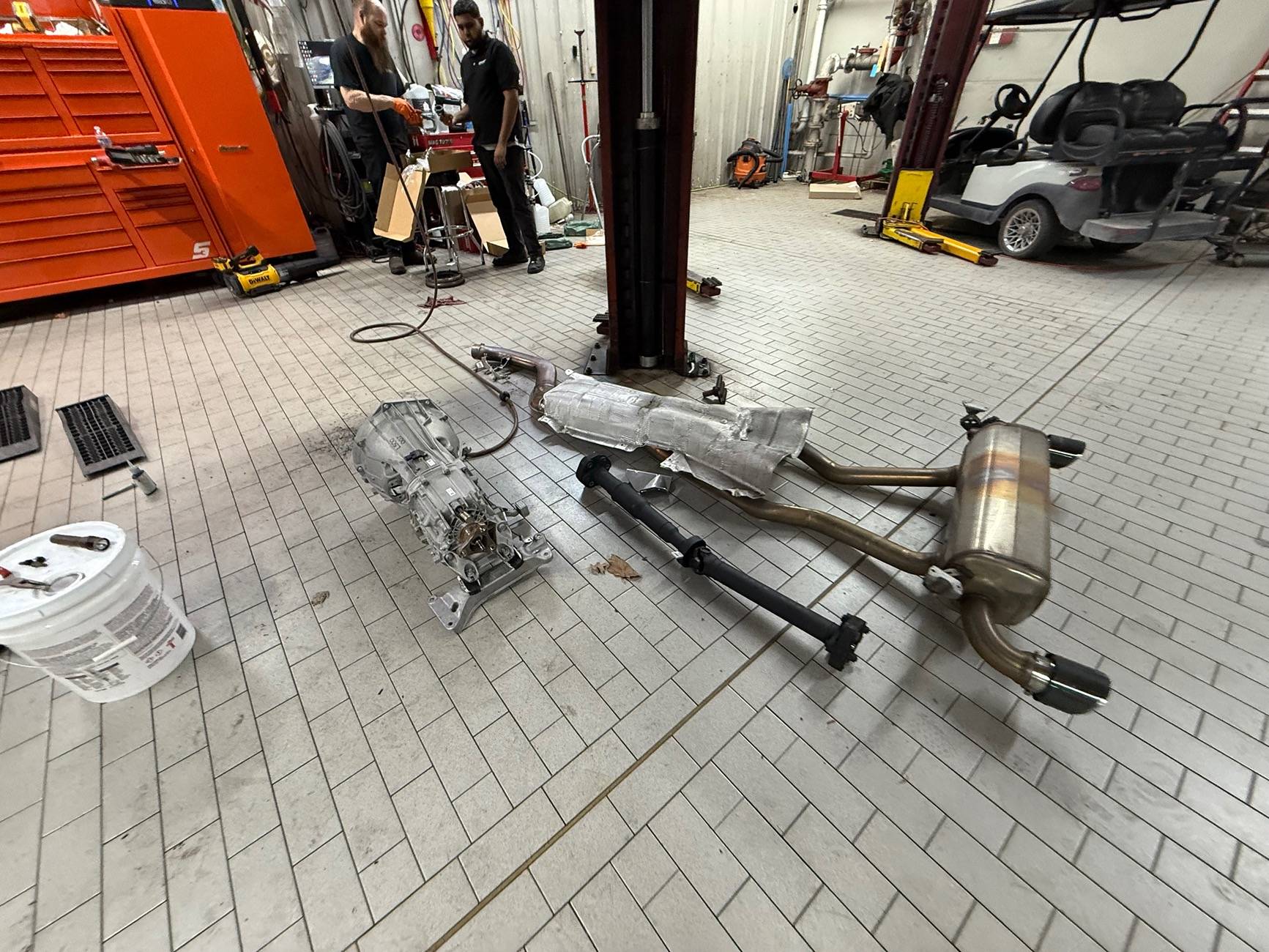

well winter is finally over and I was able to get the clutch put in … took a little over 2 hrs with some help and a lift so not a terribly hard job! First impressions: The pedal is noticeably stiffer not not so bad that my leg is going to be tired after driving it all day, the engagement is good very little chatter of any at all. Pedal engages at a good height and it grabs hard on fast shifts! … I’m gonna drive it a bit before I give it any extra power over stock but so far I’m happy with it !

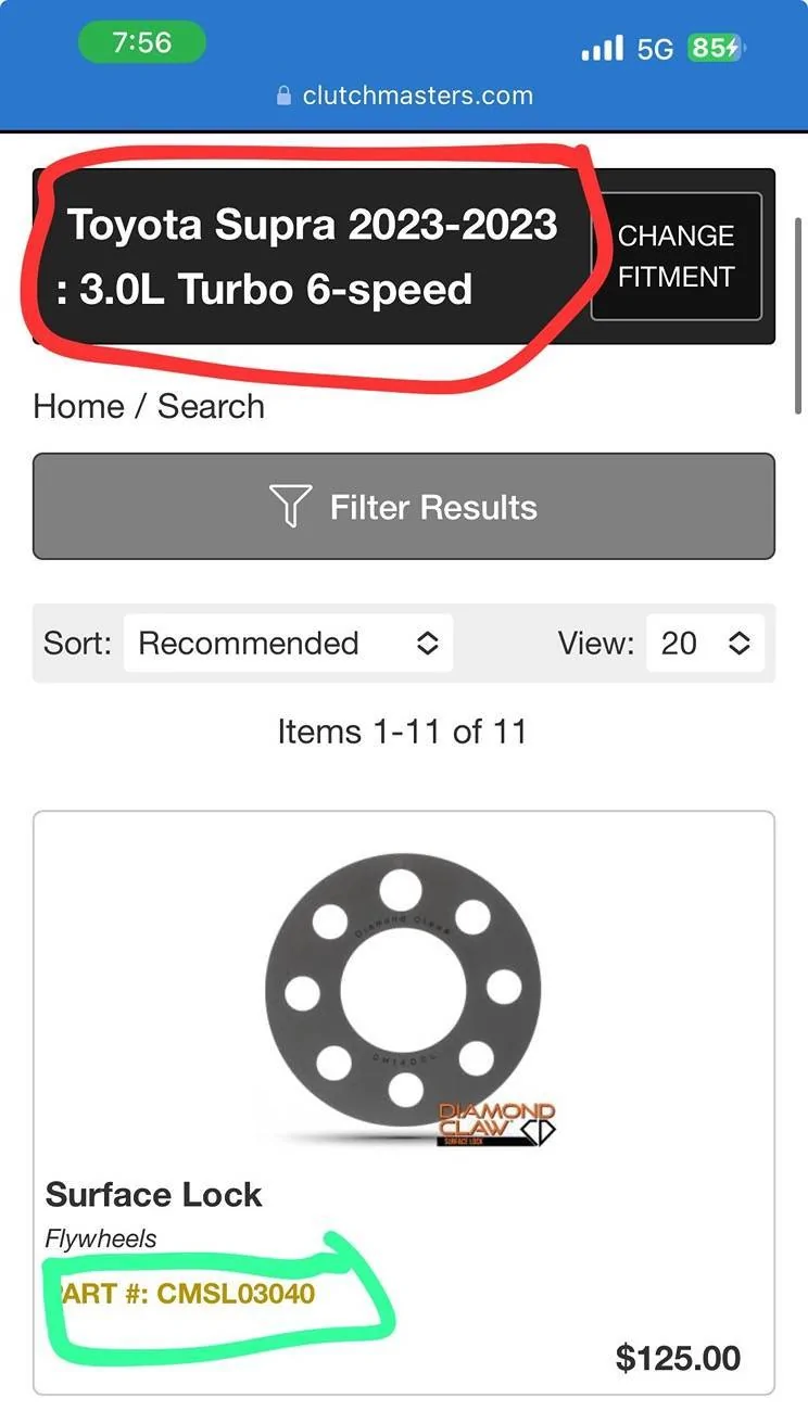

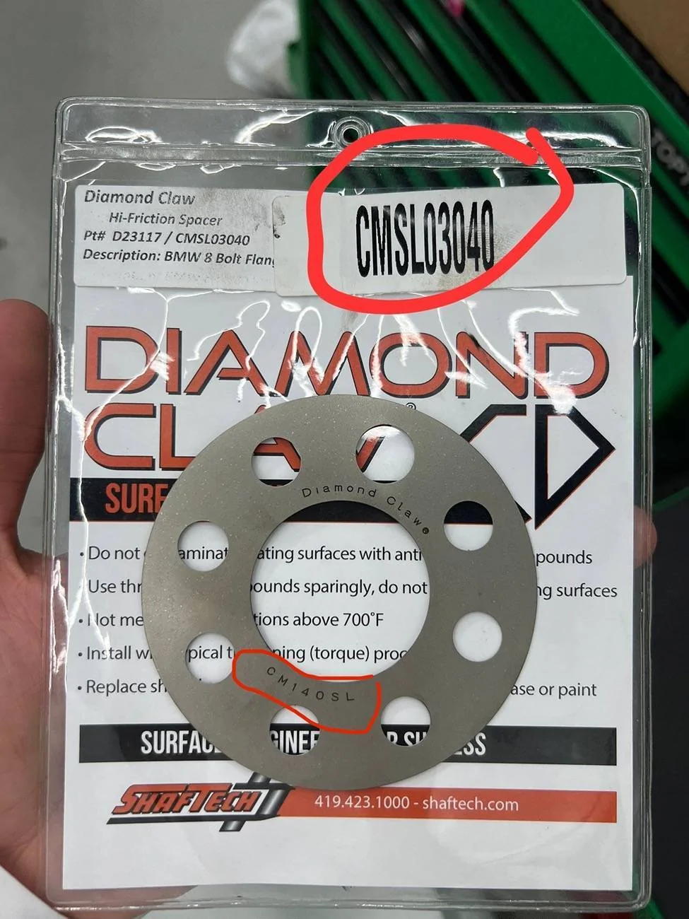

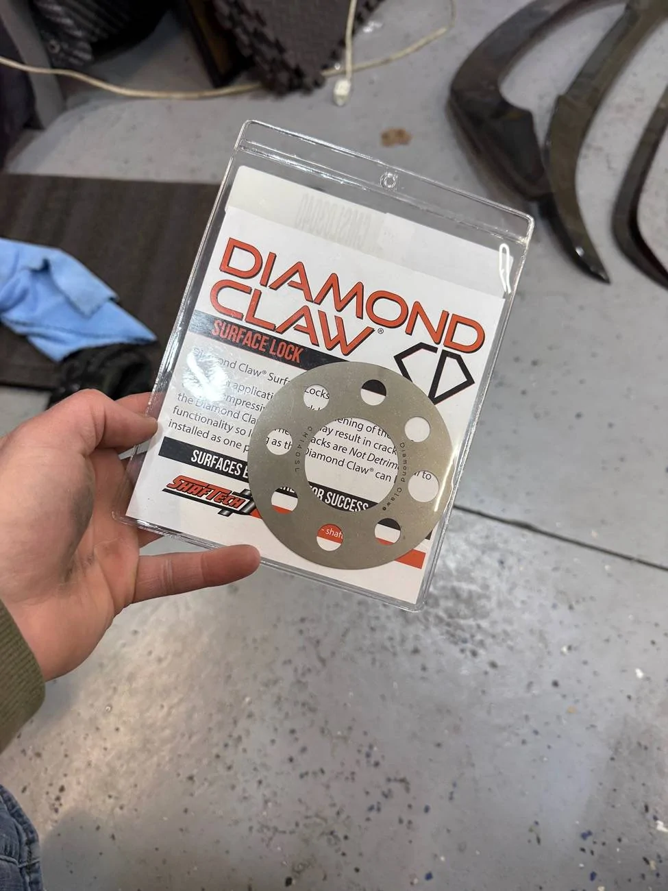

Don’t buy this diamond claw upgrade that they sell you on … it doesn’t work with our cars
I bought it already and they brought the wrong one. Clutch Masters emailed me, they said we mispackaged it. That's why it doesn't work with our cars.

I don’t but it’s literally drop exhaust drop drive shaft drop trans
Thanks! It looks straight forward. Hope I never have to replace mine. Only 600 miles on it so far. But if I do one day, I have a lift, I have the tools, and the knowledge. Just getting a little old it will be just a little slower. I just thought I'd ask in case there is anything out of the ordinary that I need to know.
