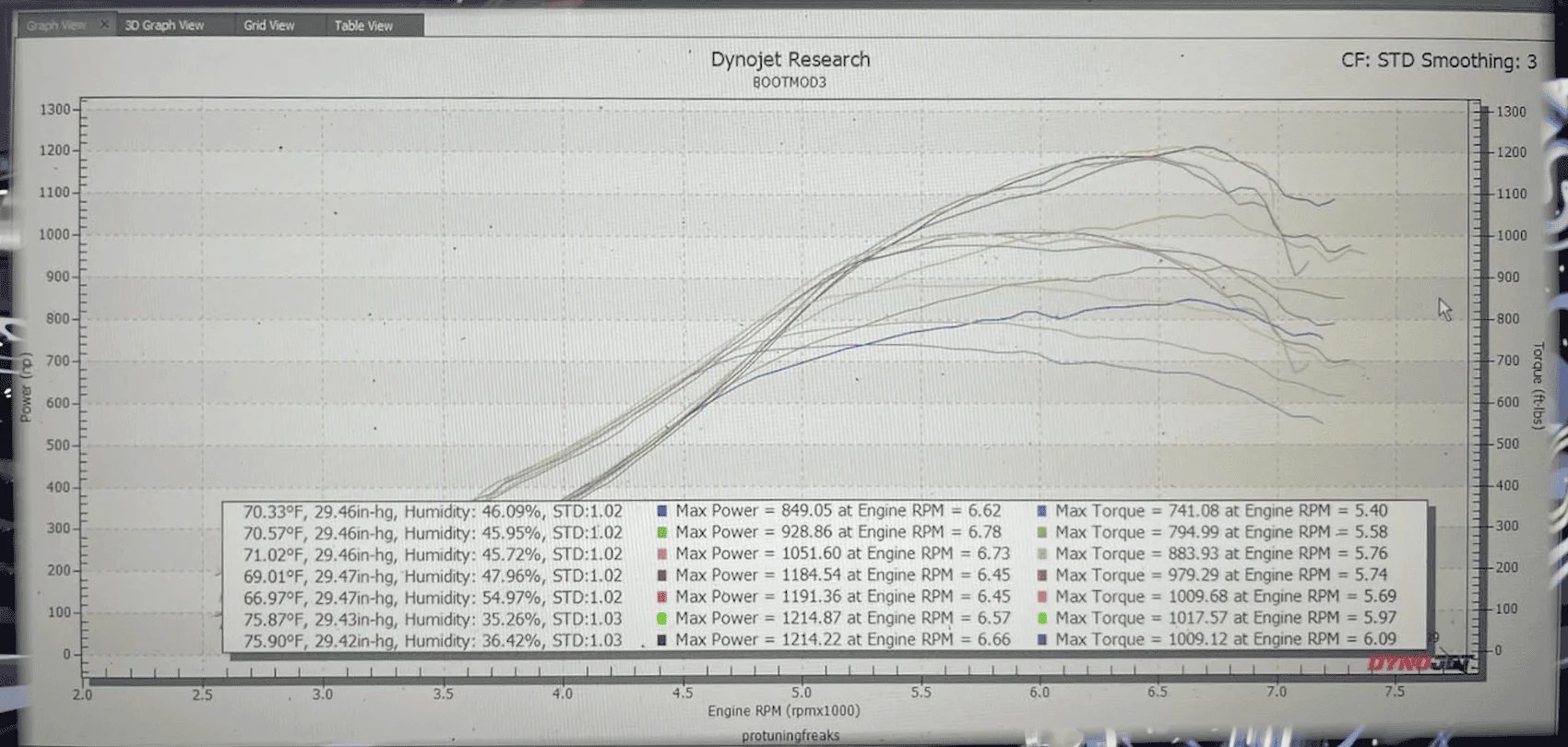

Wanted to share this video of our in-house bootmod3 software development car for the GEN2 B58 platform and our progress with it so far making 1214 whp, on stock cams!

That graph looks like you're rolling the exhaust cam...

Yes Powerband looks really rough. Has good peak power but laggy and drops off hard up top.
Doesn't seem horrible honestly. 650 tq at 4500 RPM's is solid for traction. Bringing on power too fast can kill motors especially when running over 40 psi boost. And up top, I'm sure the kelford cams when tuned can fix the rest.

Traction where lol? the 330'? You don't want a 1200hp map on shitty prep anyway... If you're having traction problems, it's the prep.
Its a stock cams car and no other graph I have seen posted anywhere looks nearly as clean. Lets be honest. Plus they didn’t use smoothing of 5 which would make this look even smoother.

This is the cleanest graph you've seen?

You have 7 graphs in there bro. Of course it won’t look “clean” as you got lots of lines in there crossing each other plus they didn’t post it like others with full smoothing to fake out additional smoothness.

Which one are you referencing that is the cleanest one you've seen?
