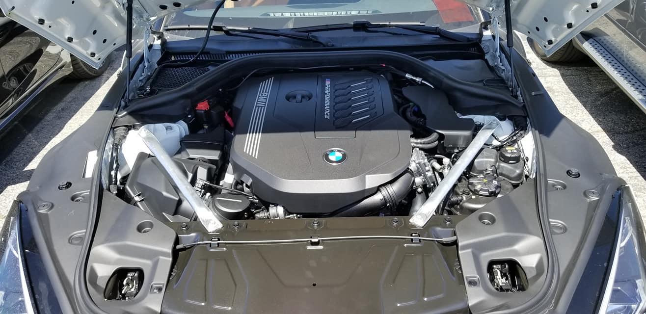

I'm actually more concerned with the 2021 suspension changes than anything else. If we add strut tower braces to the 2020, what effect will it have on handling?

I actually wondered about that myself. When I look at where the braces are, I can't help but think it's mostly for aesthetic purposes and extra support for front mounted aero pieces. Adding rigidity to the corners so it doesn't get pulled down by a splitter.
Braces that aid in suspension rigidity would be mounted straight to the strut towers no?

I did actually laugh when Tada said those weren't necessary during the original press drive. Present on the Z4 and now the MY21 and yet weren't needed huh? :)
Then again, I guess he wasn't lying as they aren't needed, but they're likely better than not having them lol.
Jokes aside, I would bet money no one could feel a difference in a blind experiment.

Those strut tower braces look super ugly. Hope it will look nicer than this. I like it off of the front engine bay
Ugly and something I would have made in shop class when I was 14. I ordered and will install the Cusco today on my 2020. Zoom, zoom. lol

I pretty much agree, though it depends upon the towers etc. And then the sway bar can change other things about the suspension and that isn't always considered but needs to be.

IIRC, the GazooRacing development pro driver didn't like how the car understeered at the limit with the braces on. If I understood Tada-san correctly, It's not that they're needed from a torsional rigidity pov, rather it would create more rigid front bias vs the rear with the current springs/shocks/sway bars combo. and since "some journalists who can't drive for ****" had problems keeping the tail in check, i wouldn't be surprised if many of the handling upgrades moved the bias towards the rear (rendering more understeer at the limit)
Think of it this way, the chassis is a spring, connecting the 4 corners. A more rigid front means more % of the load transfer will take place there.
But more rigidity is ALWAYS good, especially at the radiator side because its basically gaping hole; bridged only by the crash bar. Make that stiffer and you have better (as in faster and more stable) steering response.
am butchering the subject for the sake of simplicity here, there is way more to it than simple "ugly" bars.

Another case of BMW gets priority over parts supplies. Maybe supplier couldnā€™t meet the initial demand?
I doubt that. These parts can be cranked out by the simplest of shop tools in mass. A couple of guys in a garage with a press and a punch could probably supply all of BMW.
Knowing Toyota, this was financial. The BOM goes down $15 without them. $15 x 5,000 cars is $75,000.
