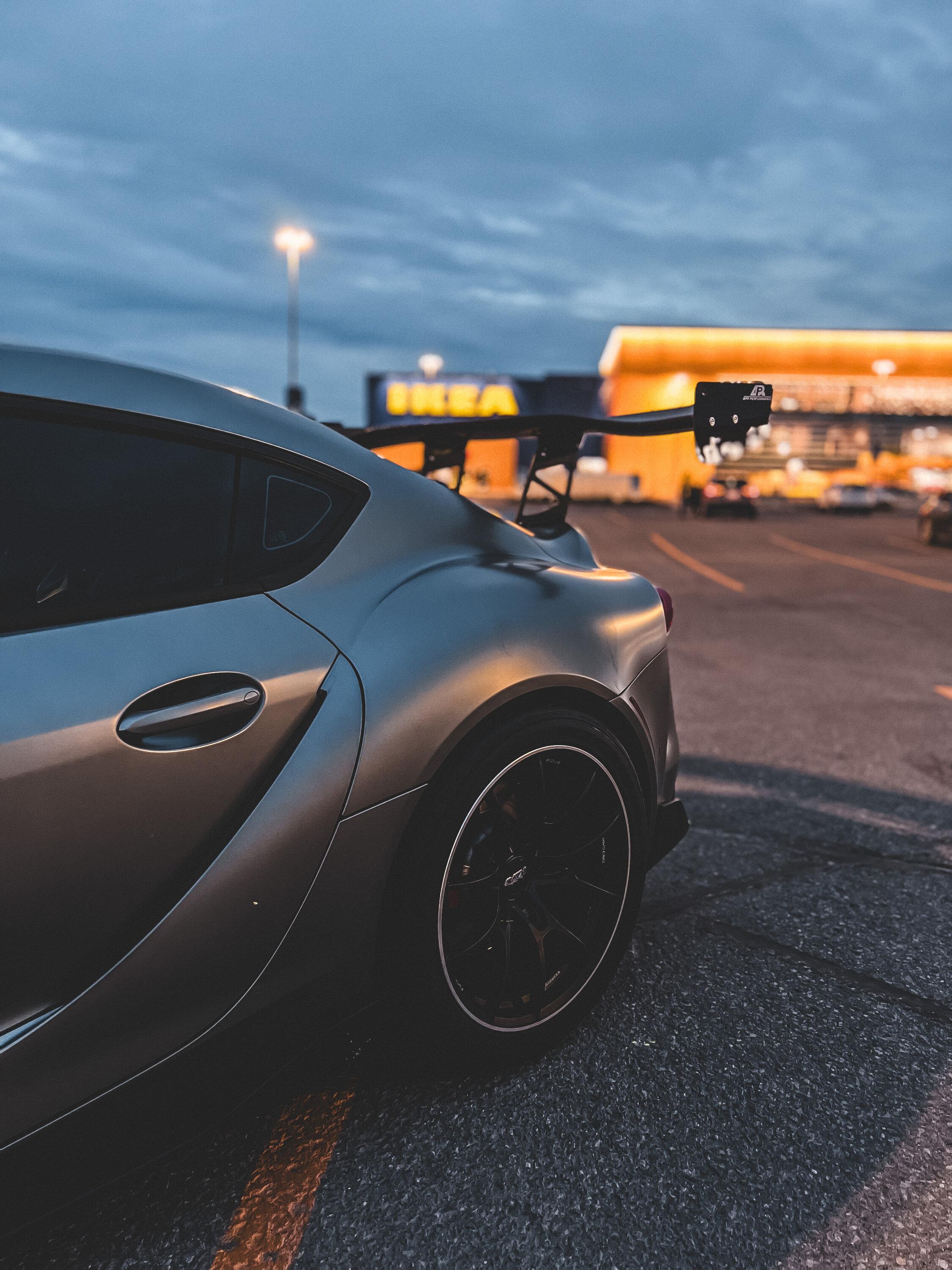

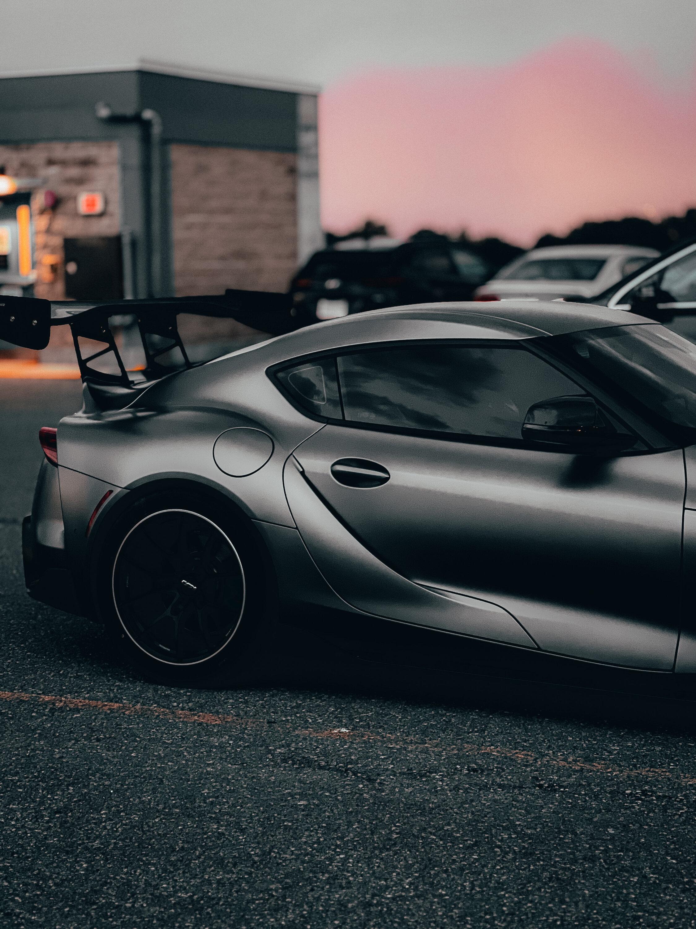

Update : wing installed and when removing front bumper for splitter it fell and got scratched and since it’s satin paint I need to re paint front bumper wing looks amazing

I recently made some modifications to my car, and I just had to share how amazing the changes feel. Firstly, let's talk about the wing. I added a large wing to the back of my car, and it has completely transformed the driving experience. The amount of downforce generated by the wing is incredible, and it makes the car feel incredibly planted on the road. The wing works in combination with a front lip, generating an immense amount of grip that almost makes the car feel like it's all-wheel drive.

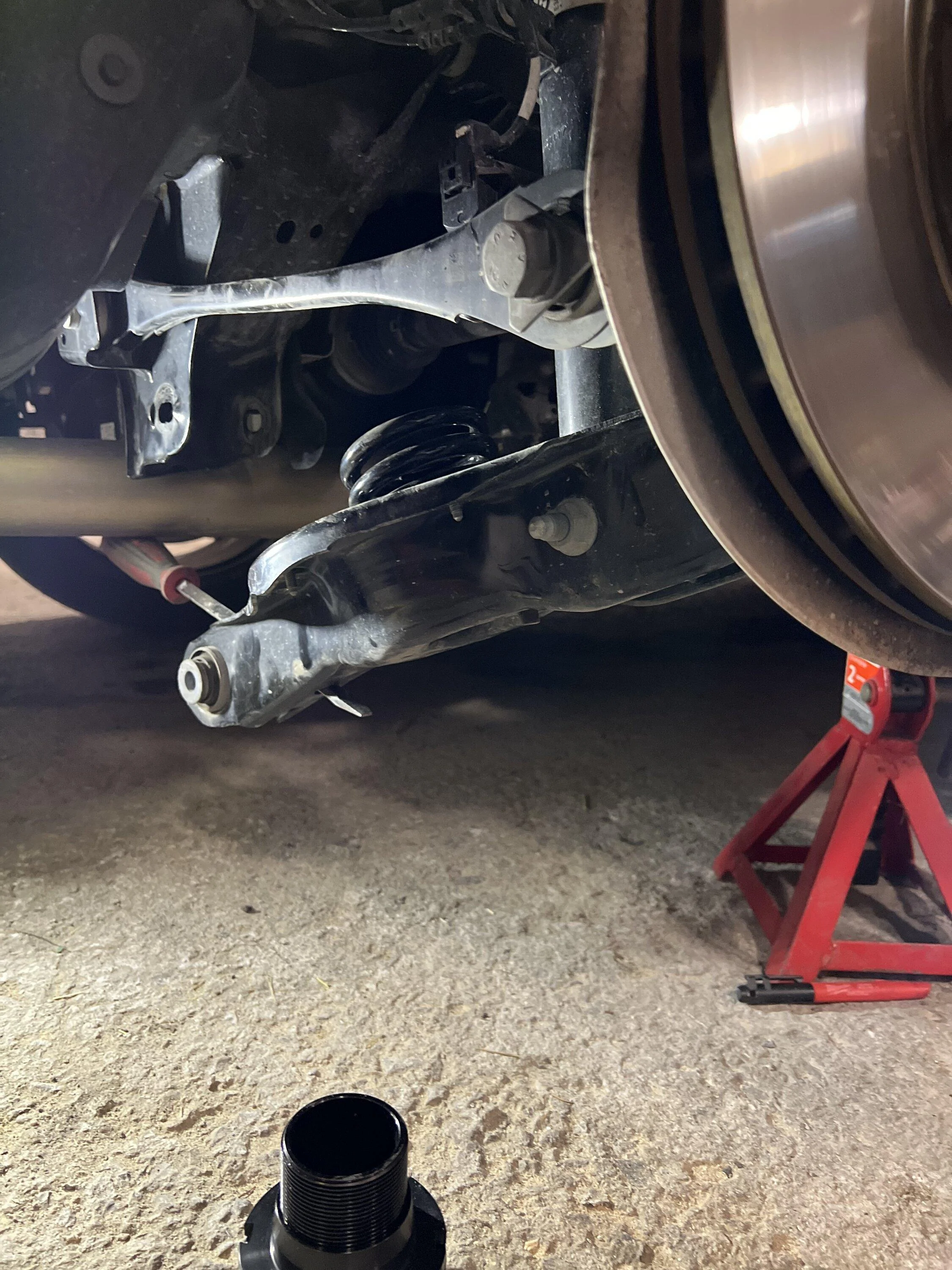

In addition to the wing, I also fine-tuned the suspension to maximize both drivability and performance. I installed an hybrid Coilover/Spring setup maintaining the stock EDC and adjusted the damping settings to perfectly suit my driving style. The result is a car that feels incredibly balanced and responsive, yet still comfortable enough for daily use.

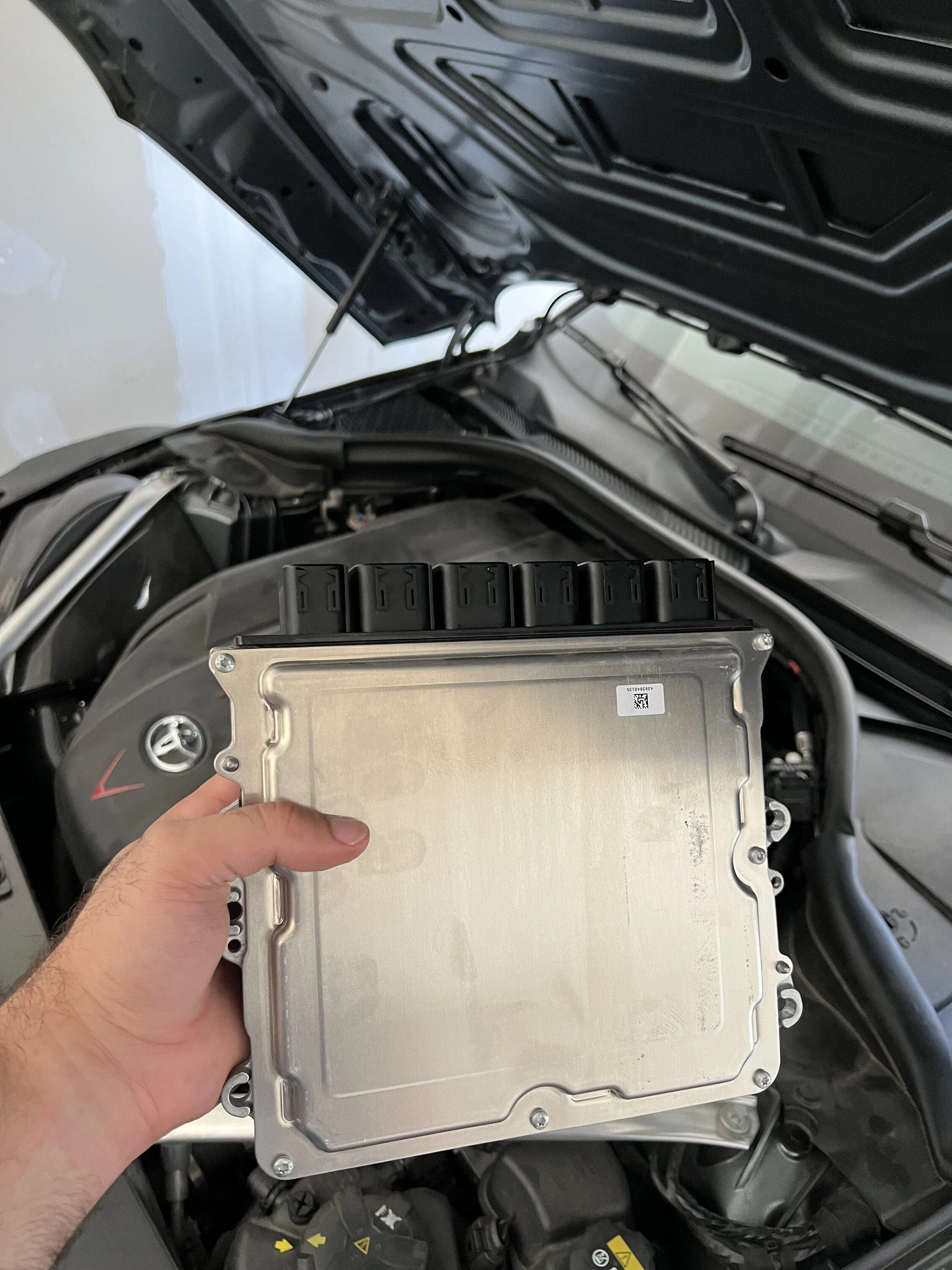

So today I received my ECU back from @A90 Shop , I tried to start the car quickly to head to work with it however cad wouldn’t start . Huge shoutout to Josh for helping me I will re check to make sure all pins are properly connected and car actually starts . But the sending process was quick and painless as well as no delay @A90 Shop gave superb service !

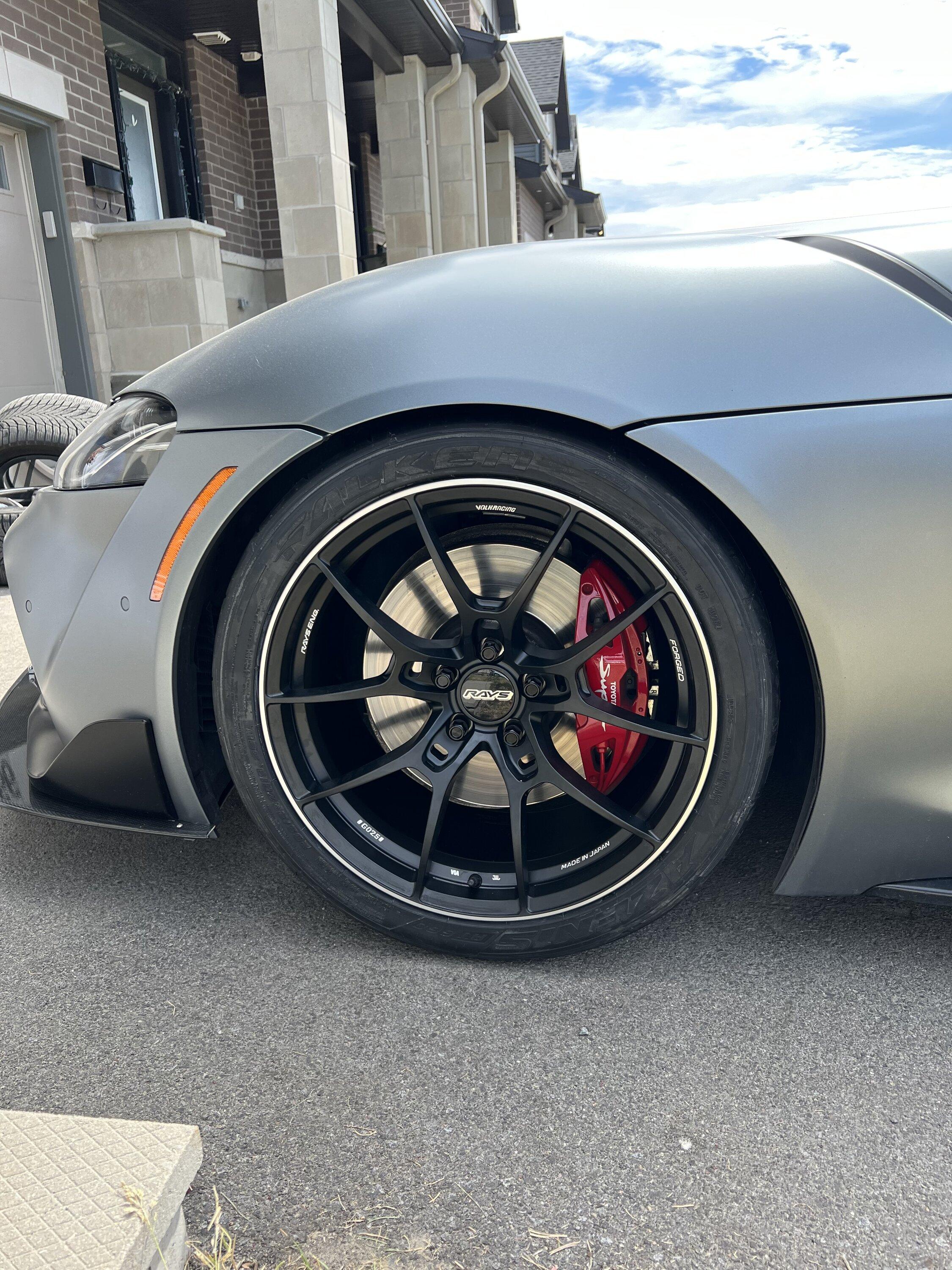

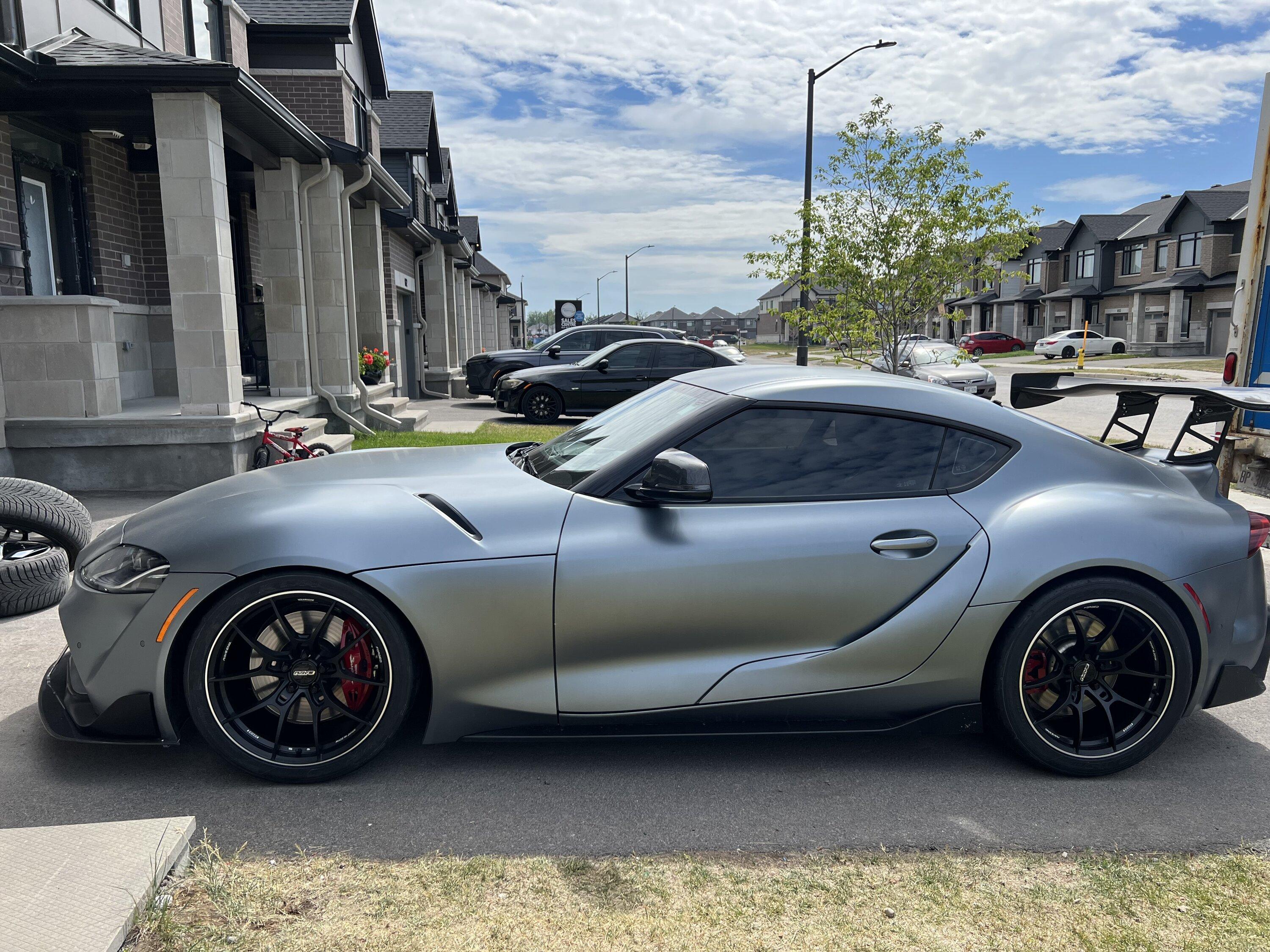

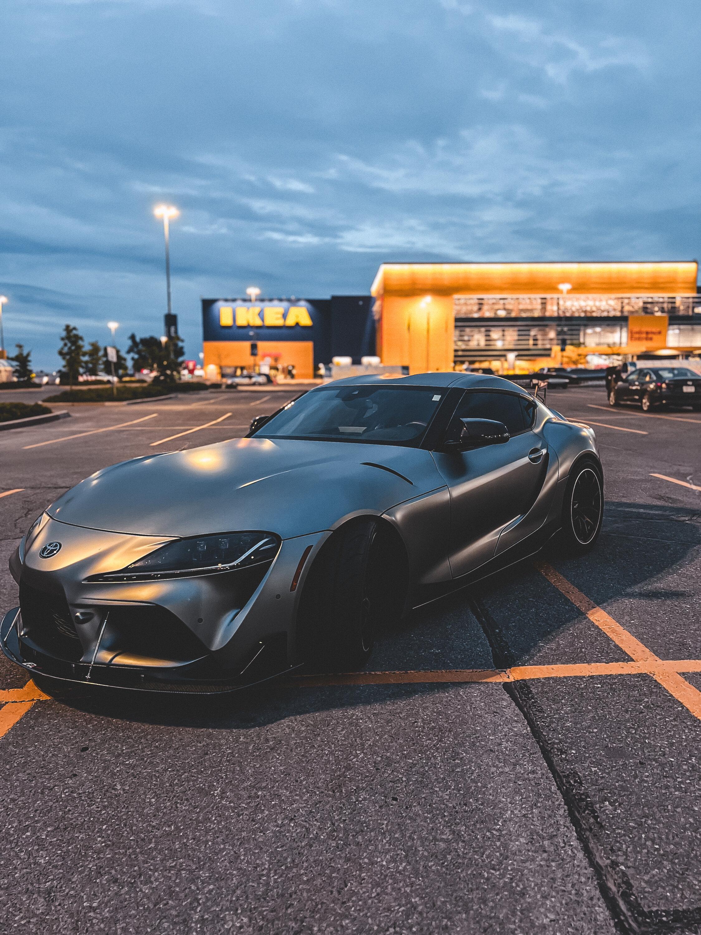

As of today , the custom wheels have been installed and the fitment is mint perfect no rubbing at all I have 265 in the front and 305 in the rear Falken RT660 as I had a whole issue with tire supply issues , the car looks amazing feel is amazing they get warm fast so a lower psi help prob 34 ish if you heavy footed . The car is also tuned and making 490-500WHP and it drives amazing it’s so so quick next up is roll cage seats and turbo

Update : running the 305 Rears Rubs when cornering at speeds over 130KM/H and some pictures of how phantom gray looks with satin wheels ?

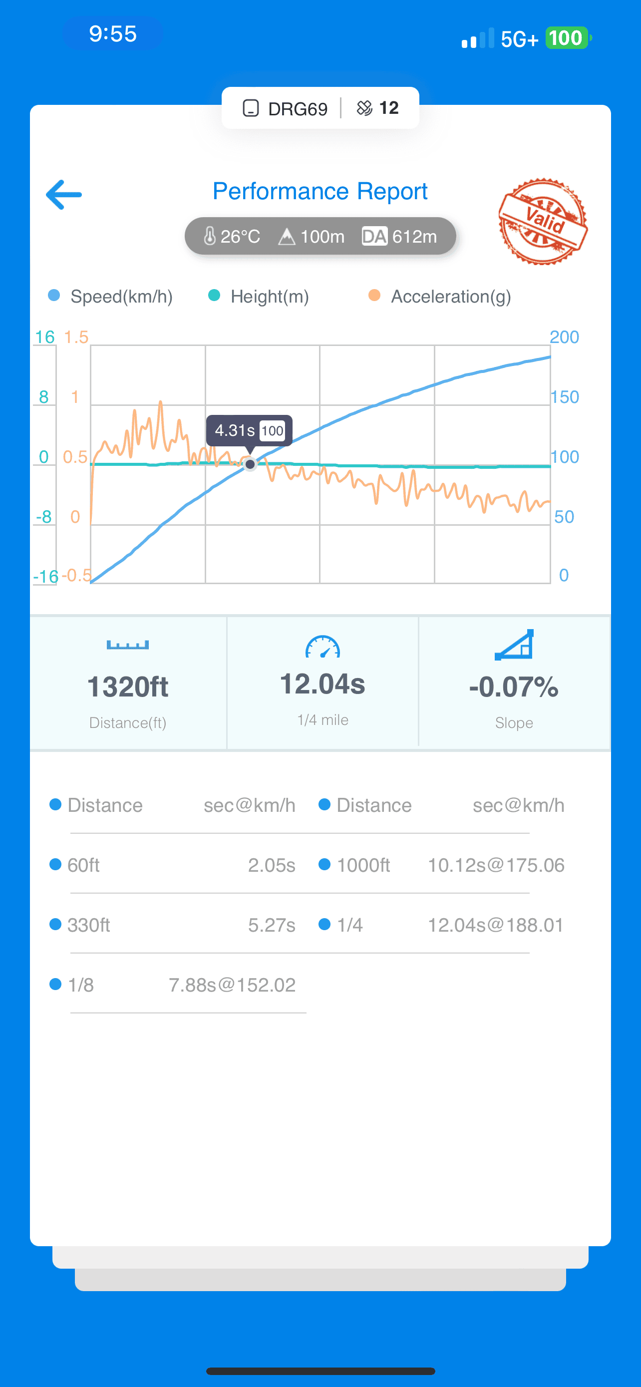

I recently tried to draggy the car with all the aero changes and BM3 stage 2 tune and tires and wheels with the MSS lowering adjustable . Did not do a full throttle launch just gave it around 70% ish throughout and tires were cold I think there is Lowe 11s in this
