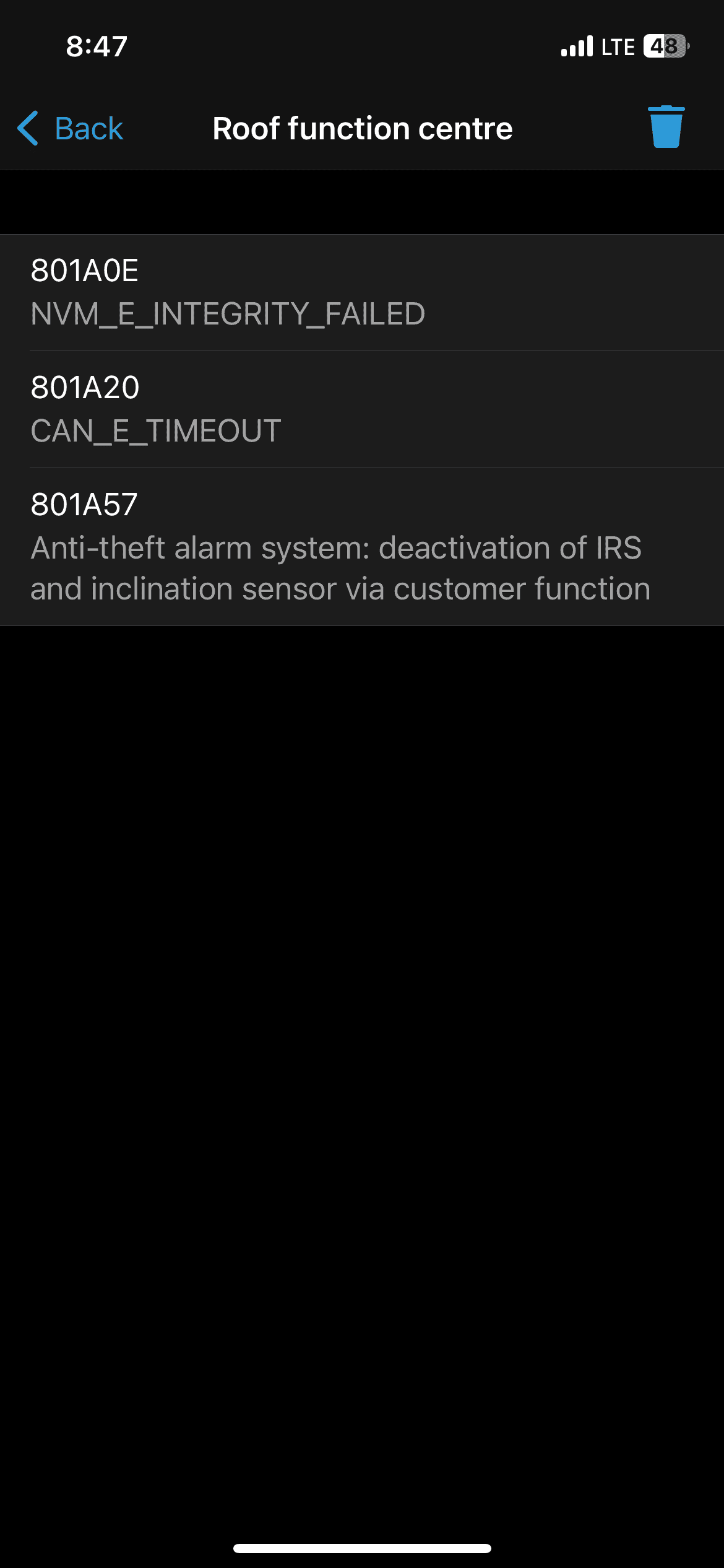

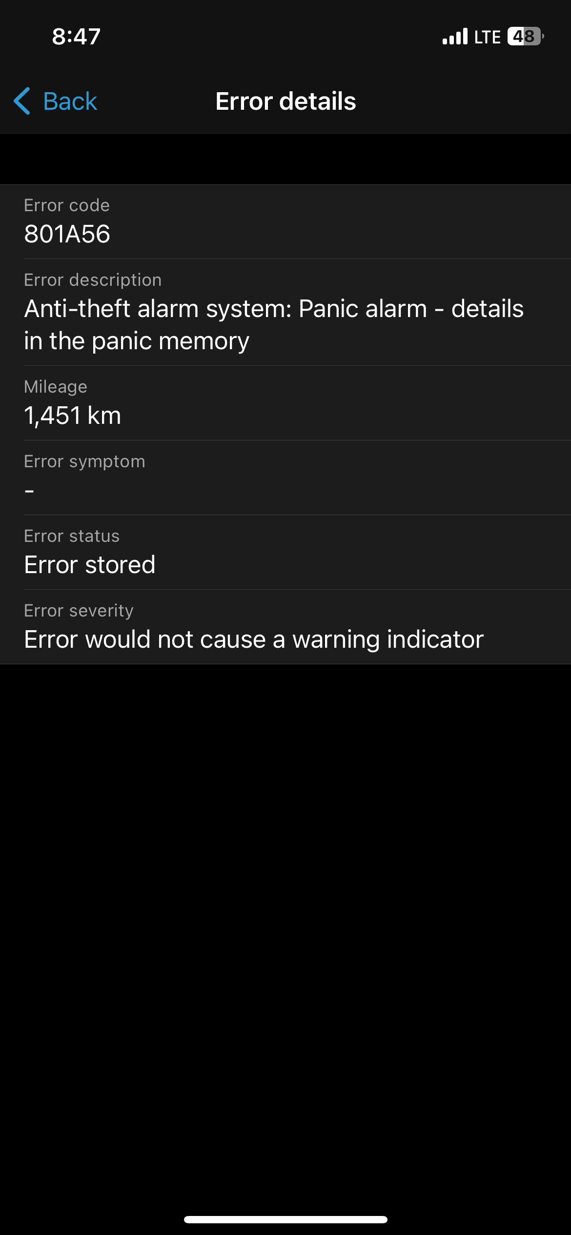

Like the title says, while I was driving today my alarm went off on 2 separate occasions and the car was turned off in between.
Has anyone had this occur before?
Below are screenshots of the error codes and a video

Sitting on the key fob and triggering the panic alarm?

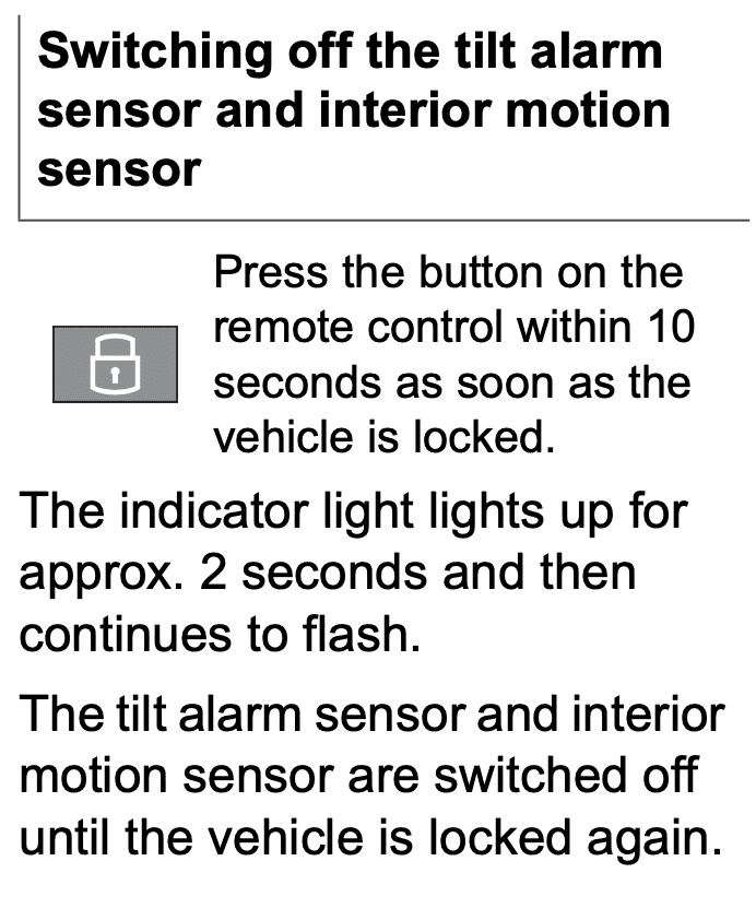

The first code is this. If you keep hitting your lock button on the fob, it actually deactivates the interior motion sensor and tilt sensor (for people who leave dogs and kids in locked cars, I suppose):
Interesting.. The key was in the cup holder though.

Yeah, then I got nothing on that. Definitely appears to be the panic alarm based on the code. Not sure what's triggering it. Faulty FOB? Maybe try driving with the other FOB and see if it happens again?
