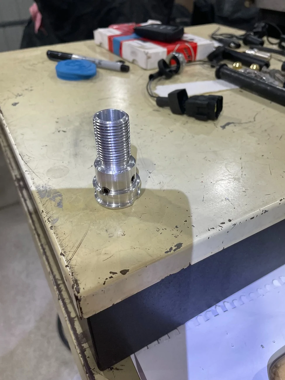

The Supra shift knob isn't threaded on it's a "clip fit". You need an adaptor to fit a threaded knob. I made this one which is based on a Raceng adaptor because I used a raceng knob. I Can't remember the thread pitch and dia. Some silly Imperial thread from memory like 3/4 x 18 or something because raceng was a US company.

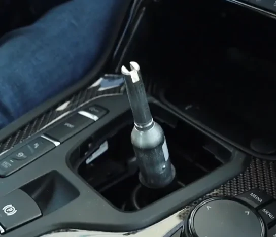

Can't find thread size because it doesn't have one. OEM looks like this.
Use the search bar, you'll find a pretty good thread on different adapters and shift knobs being used.

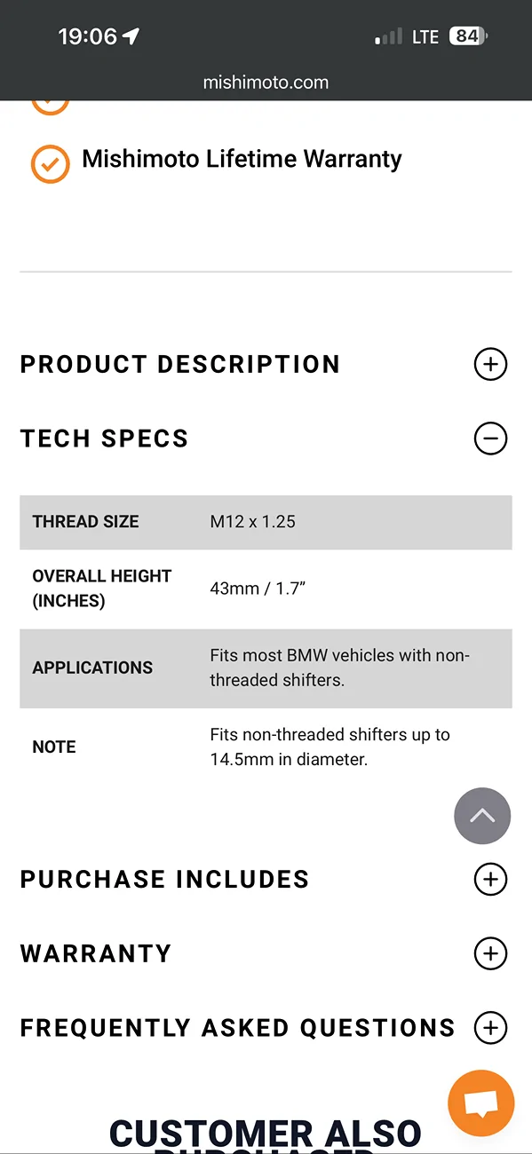

The shifter as shown above doesn’t have threads so you have to use a threaded adapter. I used Racesengs adapter and knob but they are out of business.
https://www.mishimoto.com/non-threaded-shift-knob-adapter.html
this link above has info on Mishimotos solution and in the tech specs shows a 12x1.25 thread
