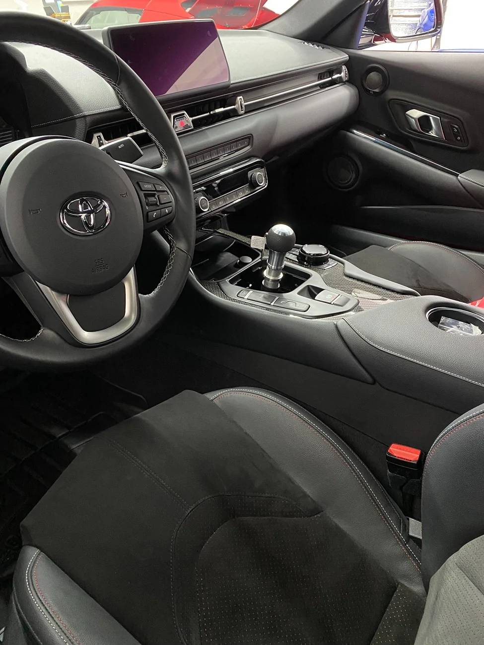

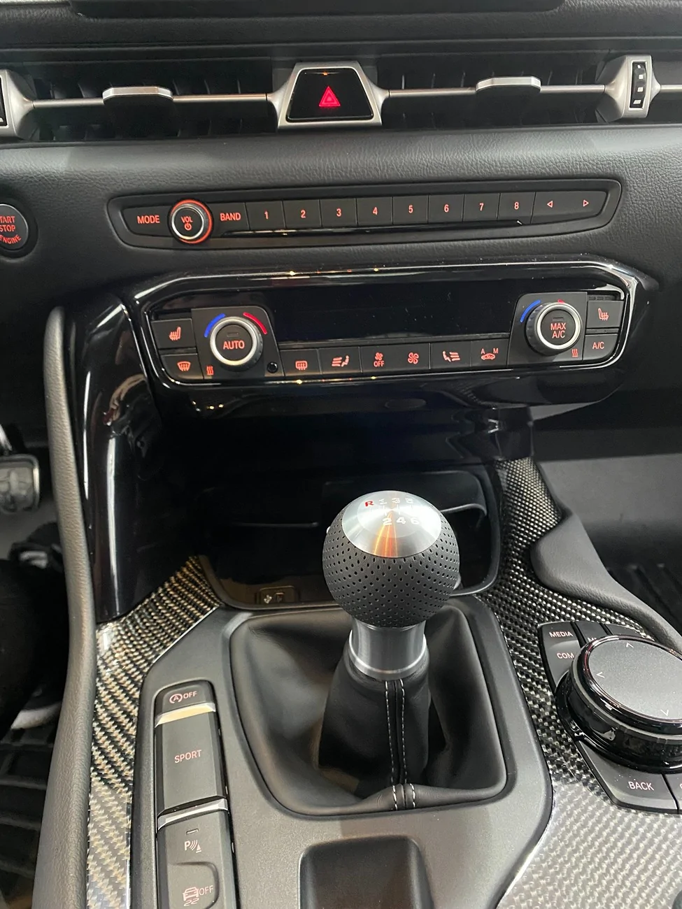

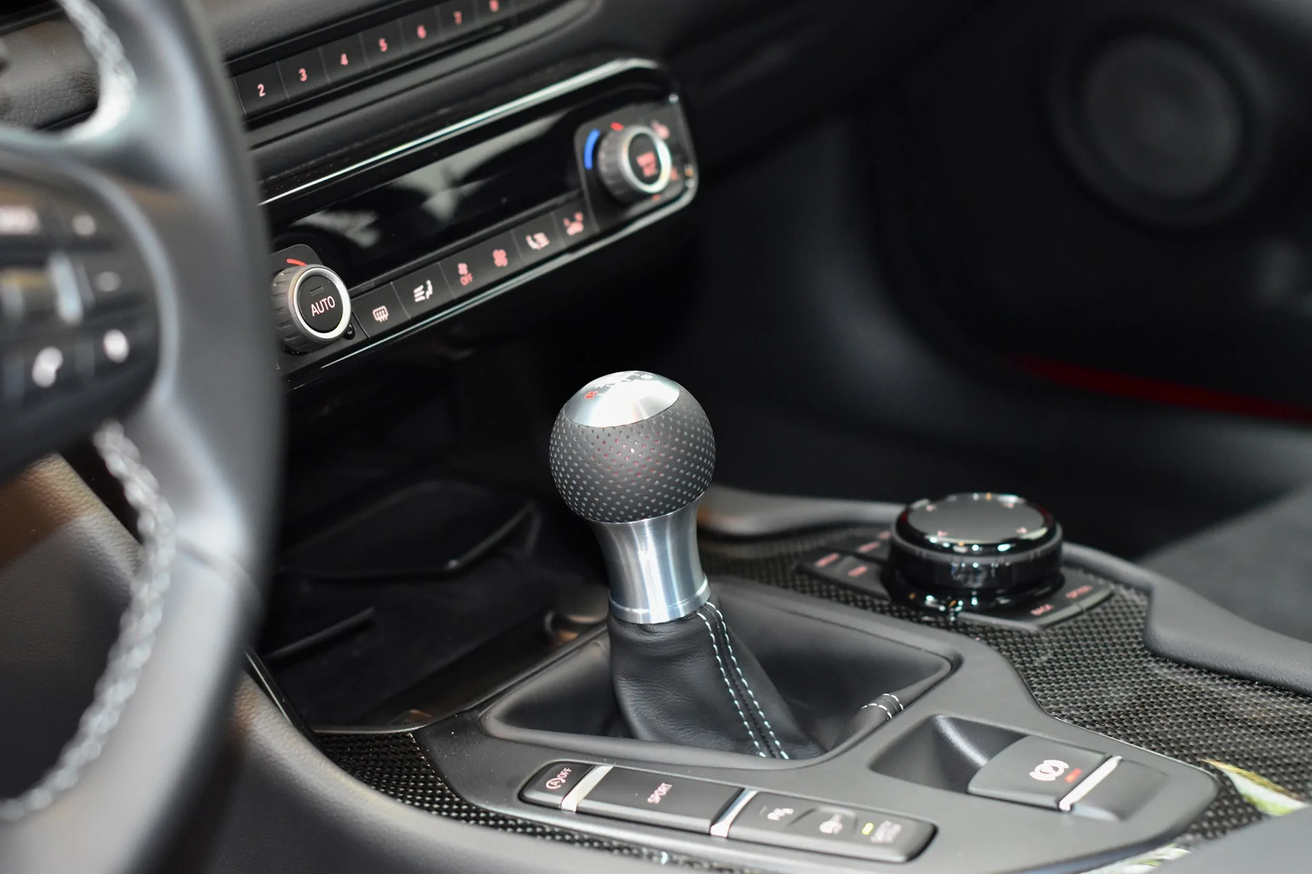

Installed a BFI Alcantara shift boot to match my Alcantara interior. Stayed with the silver stitching to match the rest of the car.
Shift knob is from Billetwerkz. Shifting feels like a night and day difference with a heavier knob.
Does the BFI boot come with a retaining bezel, or do you have to reuse the stock one?

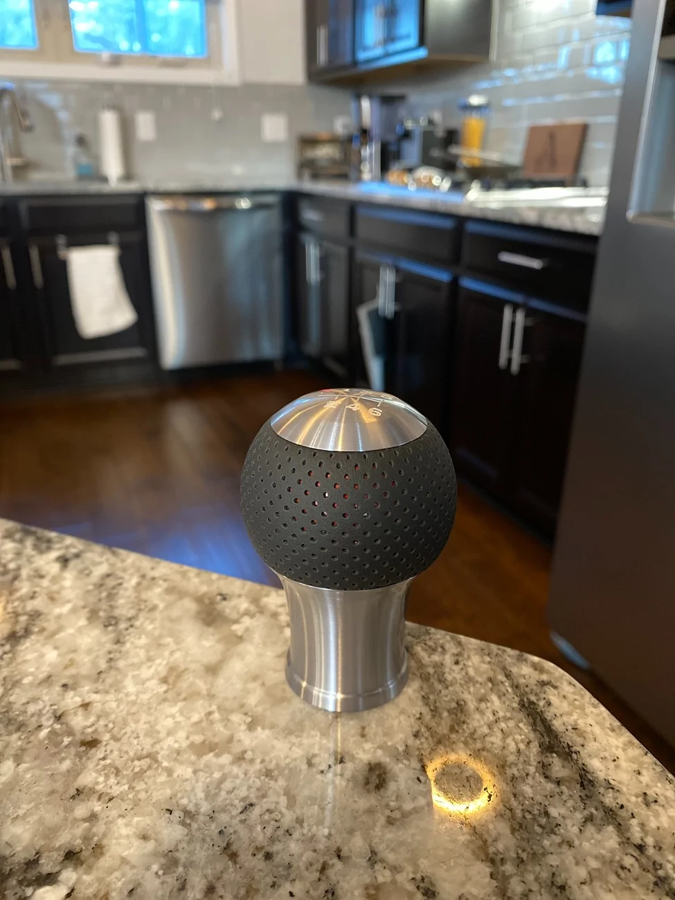

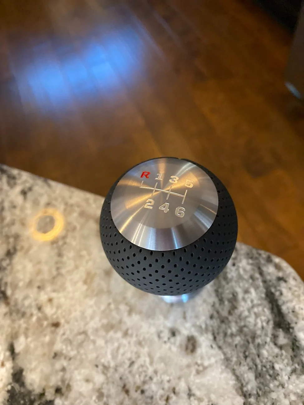

I have their GT1 knob and absolutely love it. They are each handmade and well worth the price. You can customize them however you want; the material, engraving, even the color underneath the leather.
I’m looking at the GT1 as well, almost exactly same spec as yours. What weight did you go for? They have a range of weights (200-300 gm, 300-400 gm, etc.). Were you able to request a more exact weight?

How's it secure onto the shaft? I don't see any set screws, does it reuse the oem bmw clip style?

It doesn't reuse the OEM style clip. It uses a set screw that is hidden on the front of the knob. Once tightened, it doesn't move at all.

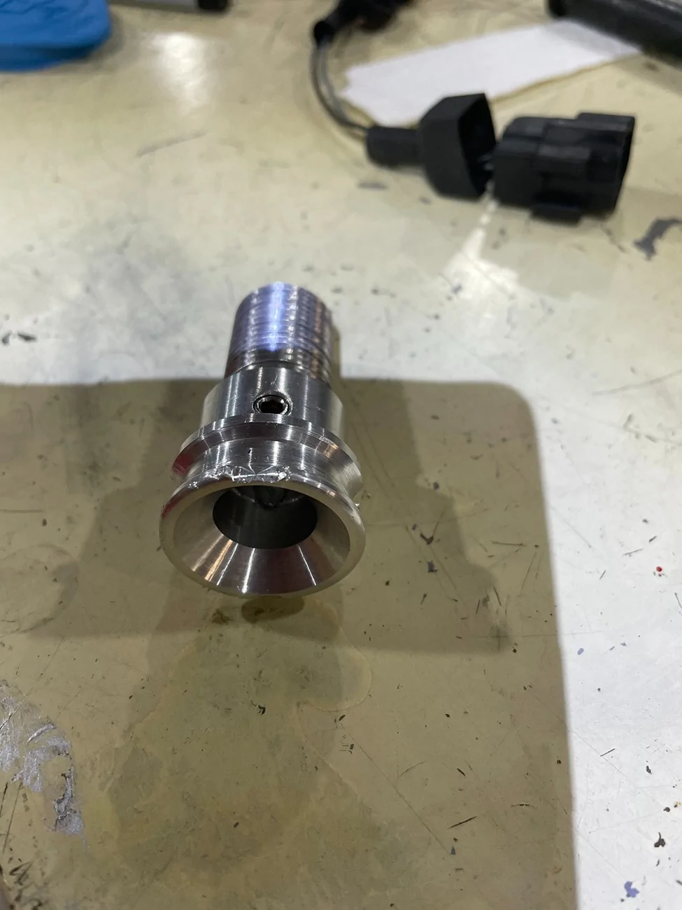

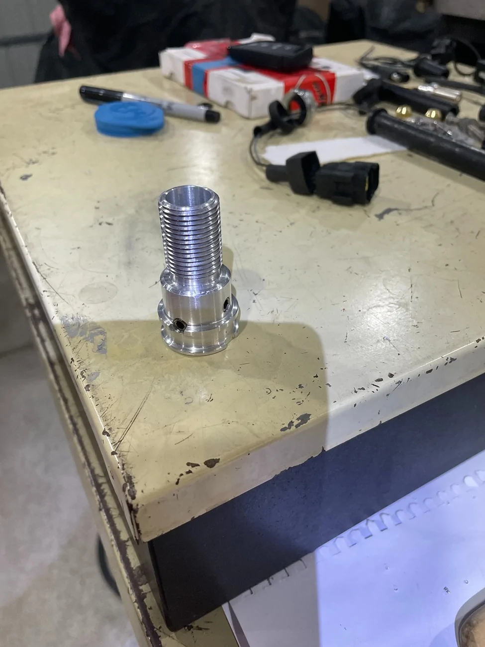

Here's how the adaptor works at least one version. I made this myself based on the Raceshift design but I wanted the shifter height lower so I made my own. The adaptor slides over the shift lever and is held in place by the 4 set screws and the knob screws onto the adaptor. The original slotted end of the lever sticks out the top and isn't used. You can turn the adaptor on the shaft so the threaded knob orientates itself correctly and tighten the set screws. Mine also has a groove for the shift boot to locate in and is tied off with some waxed dental floss to hold it in place.
