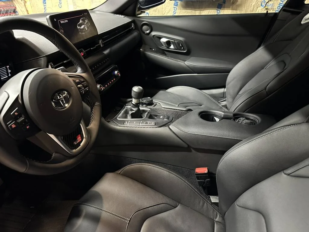

Installed a BFI Alcantara shift boot to match my Alcantara interior. Stayed with the silver stitching to match the rest of the car.
Shift knob is from Billetwerkz. Shifting feels like a night and day difference with a heavier knob.
Looks very OEM+, can you measure the height above the console though? It seems taller but hard to tell.

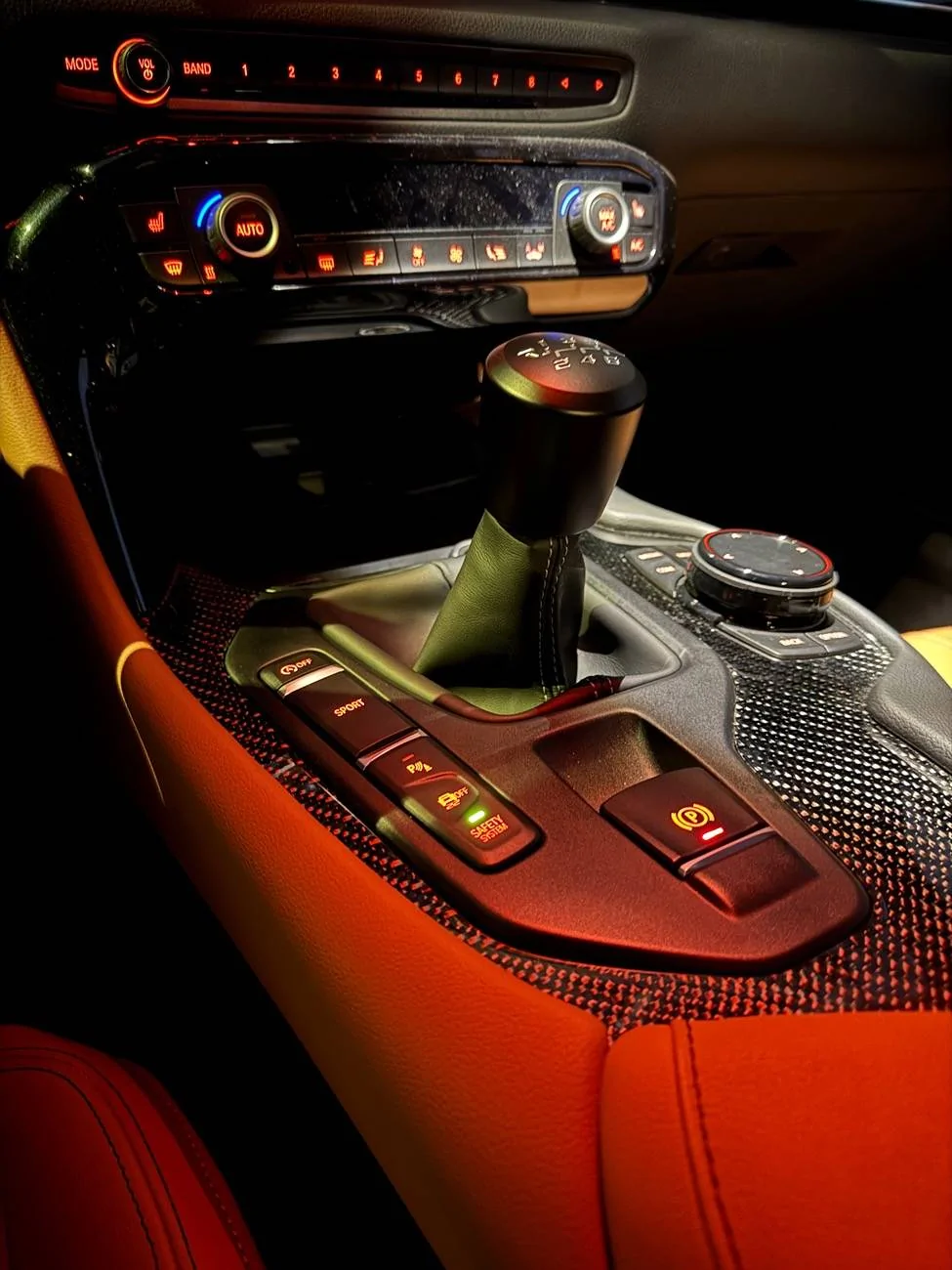

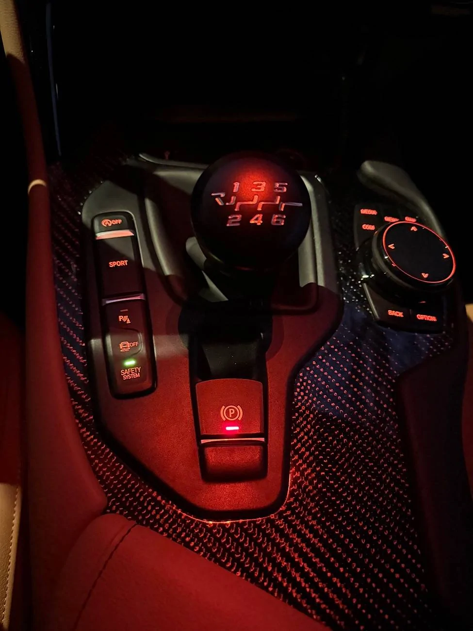

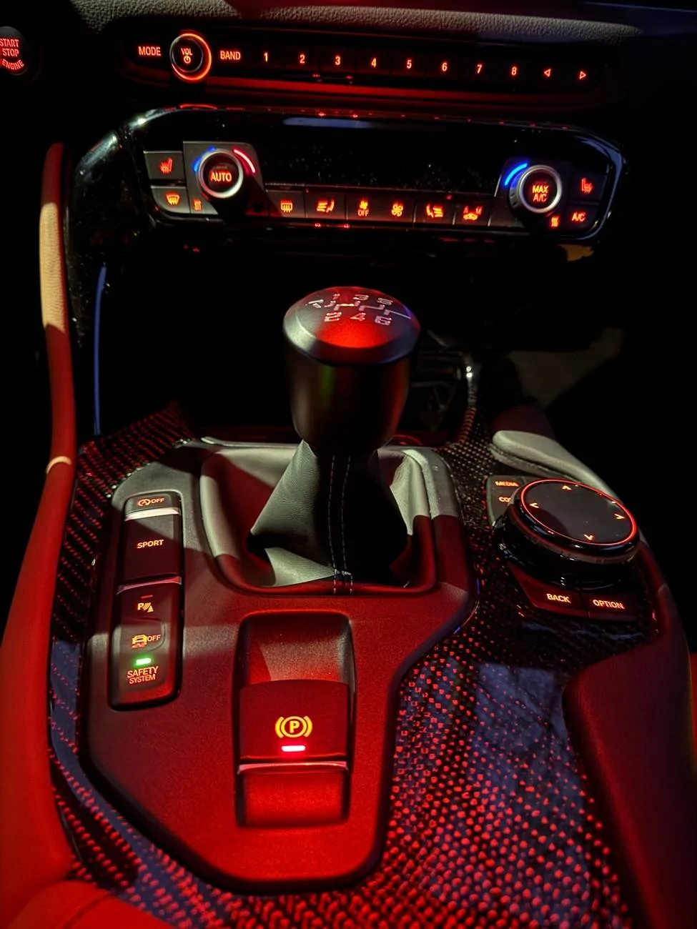

Finally got around to switching to a weighted shift knob today! Raceseng Ashiko. Anyone know where I can find a shift boot collar? I tried to get a Raceseng one but they’ve closed up shop! It seems to be sold out everywhere. Any recommendations for a substitute one?

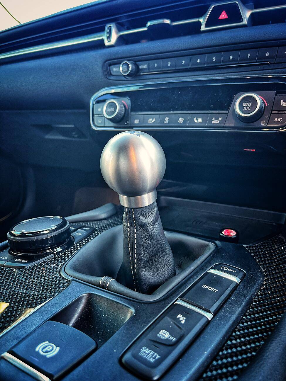

After buying a Racseng Contour and collar (which I'll be putting up for sale in the next few days) I ended up going with a bespoke brushed Titanium sphere with custom laser engraving from WC Lathewerks. The knob and internal retainer weigh in at 380g and once installed, the knob sits noticeably lower than stock, giving better clearance with the HVAC controls. Also, the boot is tucked inside (I used electrical tape to secure it to the retainer) for a neat finish without the need for a collar.
Chris at WC Lathewerks was great to deal with and was patient and helpful as we refined the design. No kickbacks, just solid service worth praising.
The installed knob feels great in hand - that's what she said - and I am really pleased with the result.

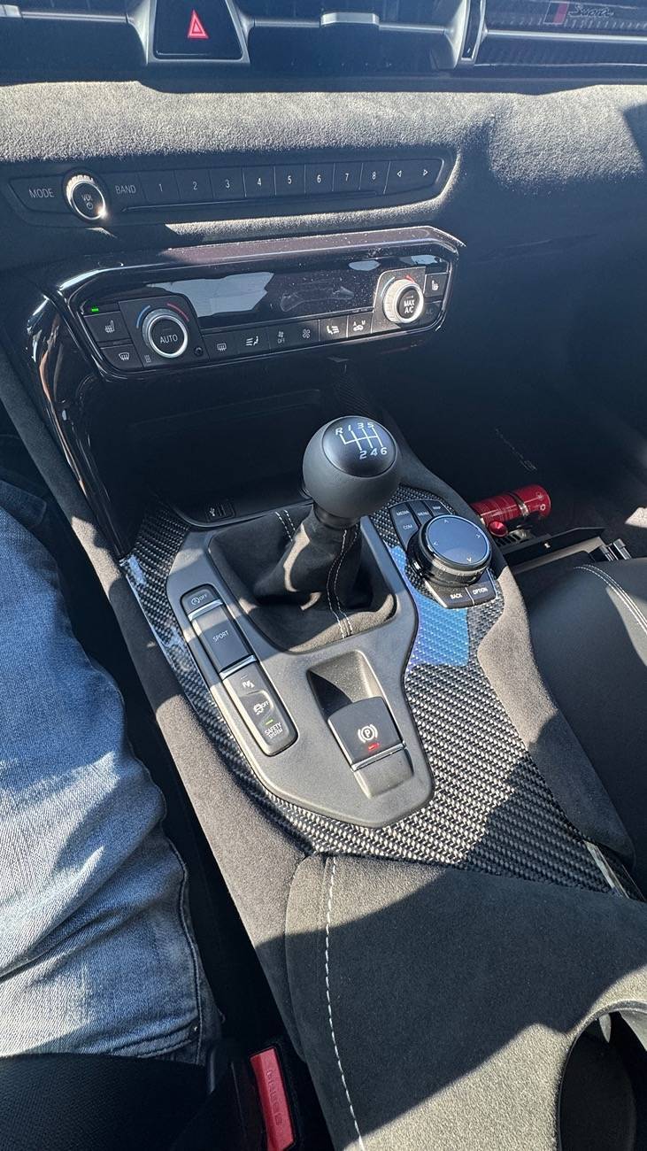

With a heavier knob, does shifting get more vague (ie - less feedback, harder to tell which gear it’s in)?

Not at all in my opinion. The added weight allows the shifter to slide into the gate easier which I believe gives me more tactile feedback. I always know what gear its in based on position feel regardless of shiftknob weight though.
