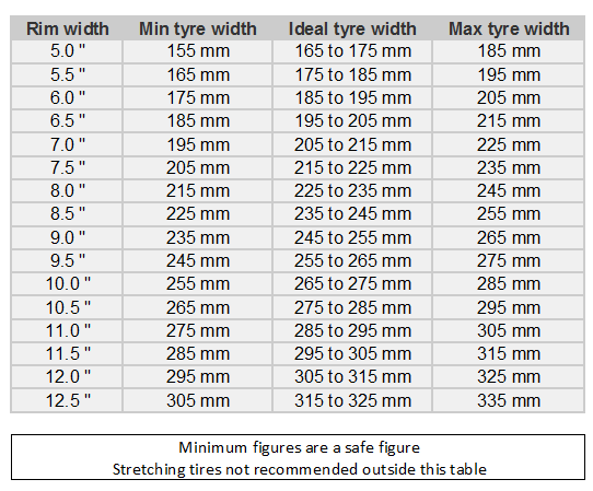

Thanks. You are on Apex 18 /10 squared. Right?
I am afraid to stretch the 275/35 too much on the 10.7 titan and lose too much shoulder due to stretch. I was looking at this reference table and it seems to be kind of ok.

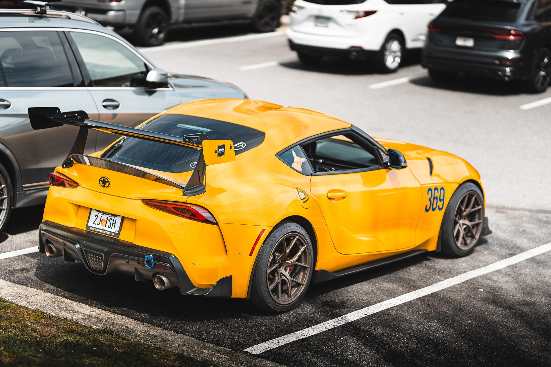

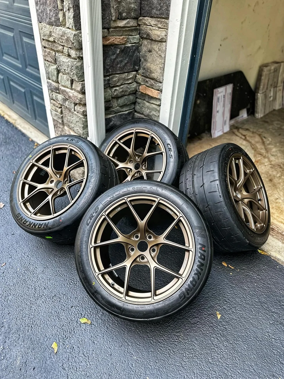

Here is a 275 CRS and 71RS on the same exact spec titan wheels you ordered, peep the fitment. This isn't brain surgery, just get the 275 and enjoy your track weekends.

Not sure what you mean by ā€œlose the shoulderā€? It will still be there, and be much mightier with some stretch versus pinched.
Speak of the devil, that looks like stock height and I'm planning on running 275/40/18 CRS too, at least starting off. How much spacer was needed in these pics? Any rubbing on the setup pictured here?
I'm also finding that Apex is back ordered to hell so I've been looking at T7s as well. I don't have too much against T7. I've run both on my S2000. Though I do prefer Apex as the paint app is better IMO.
For what it's worth I'm aware that CRS and A052 run stupid wide. I've found plenty of pics of their 275s on 11s and they don't look stretched at all. But in person I've also seen V730 and RT615k in 275/35/18 on T7 10.7s and they definitely look stretched. More than I'd like and I run a 17x10 and 255 hot boi setup on my S2000.

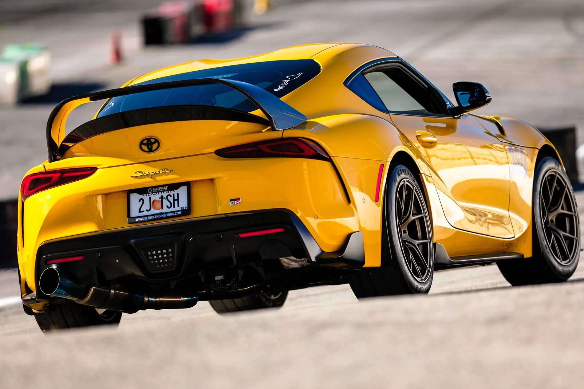

well…
I took the plunge and went with the V730s 275/35 R18 squared on Titan 7s which are 10.7 inch wide.
I also put an order for the coilovers and I have camber plates and end links in a box somewhere. So I will be busy mounting those up and will let you know.

well…
That size V730 will be great on the 10.7 as the Kumhos don't run wide and they have stiff sidewalls.
