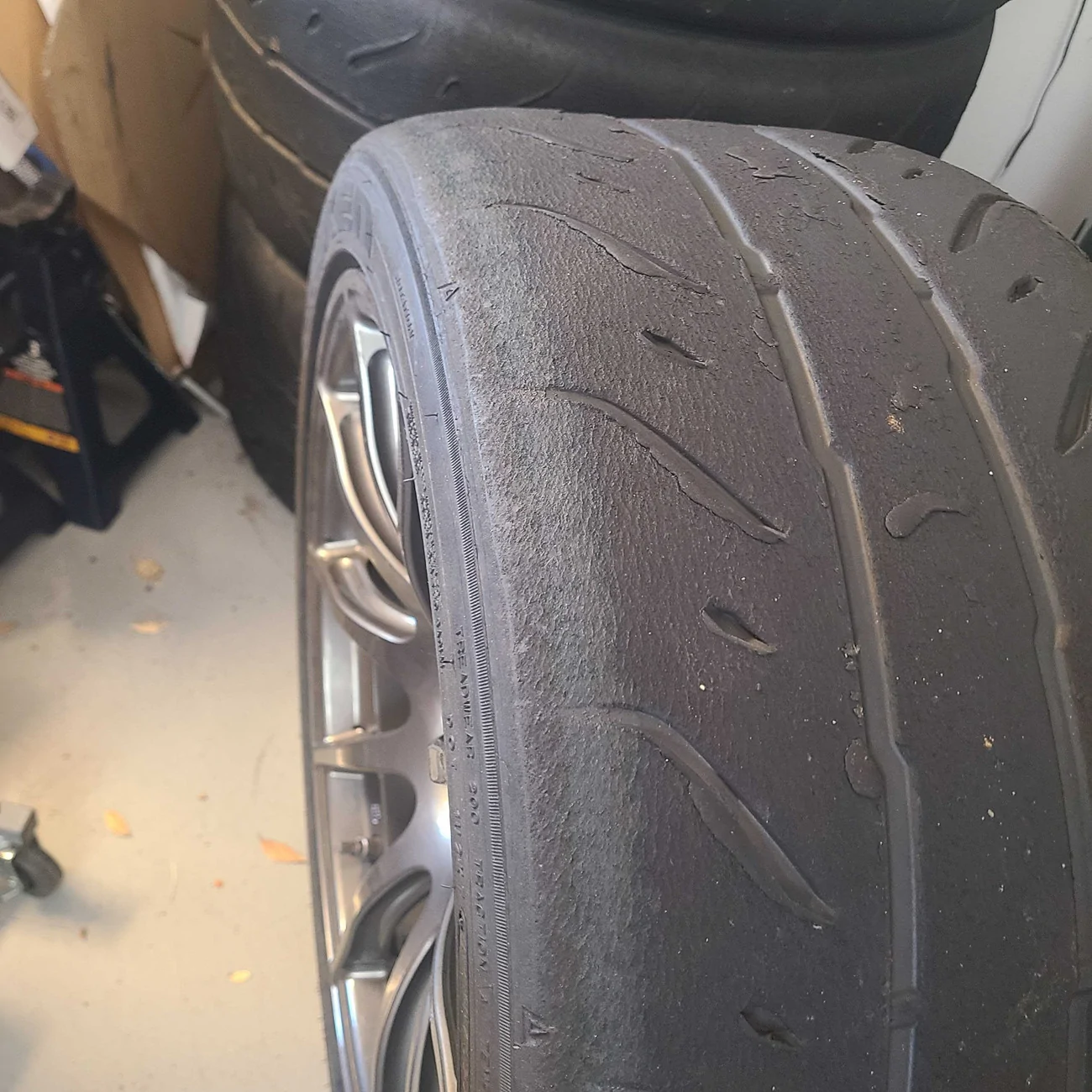

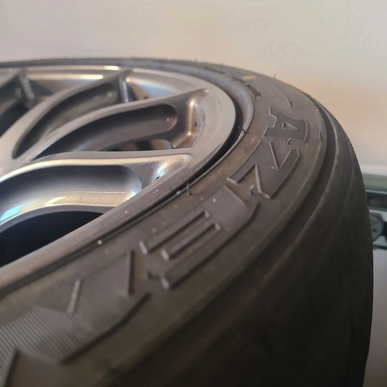

Here's the 275/18/35 RT660s on the 18X10 wheel. It's definitely a bit wider than the wheel but felt fine on track. I might go a size narrower if I use these tires again.

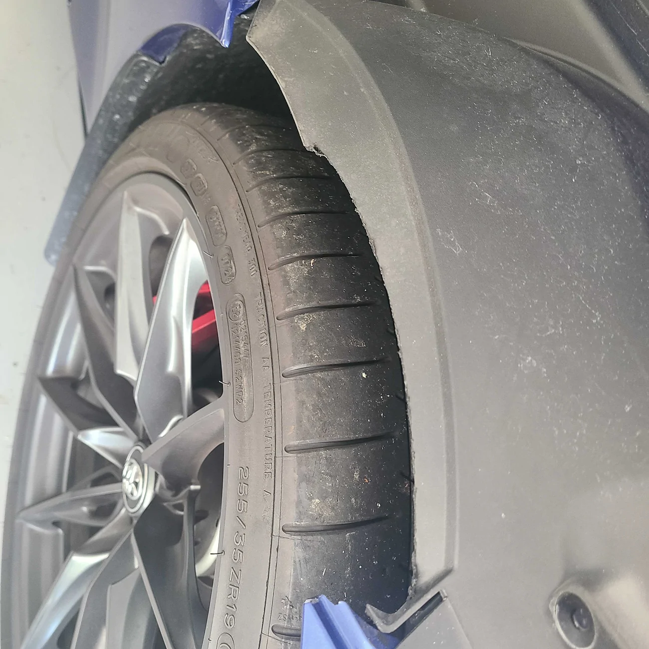

Here's a pic of the fender liner rubbing (probably mostly turn 2 at Thunderhill East):

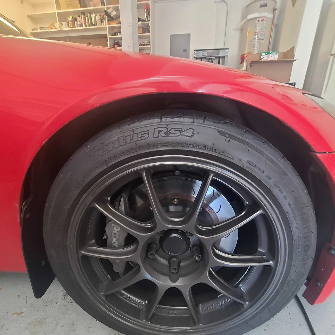

And a bonus shot of the S2K with Wilwood brakes and Ohlins I put on recently.

That looks like the self clearancing my S2000 did to its liners. As long as it's not catching the hood/fender I'm happy.
