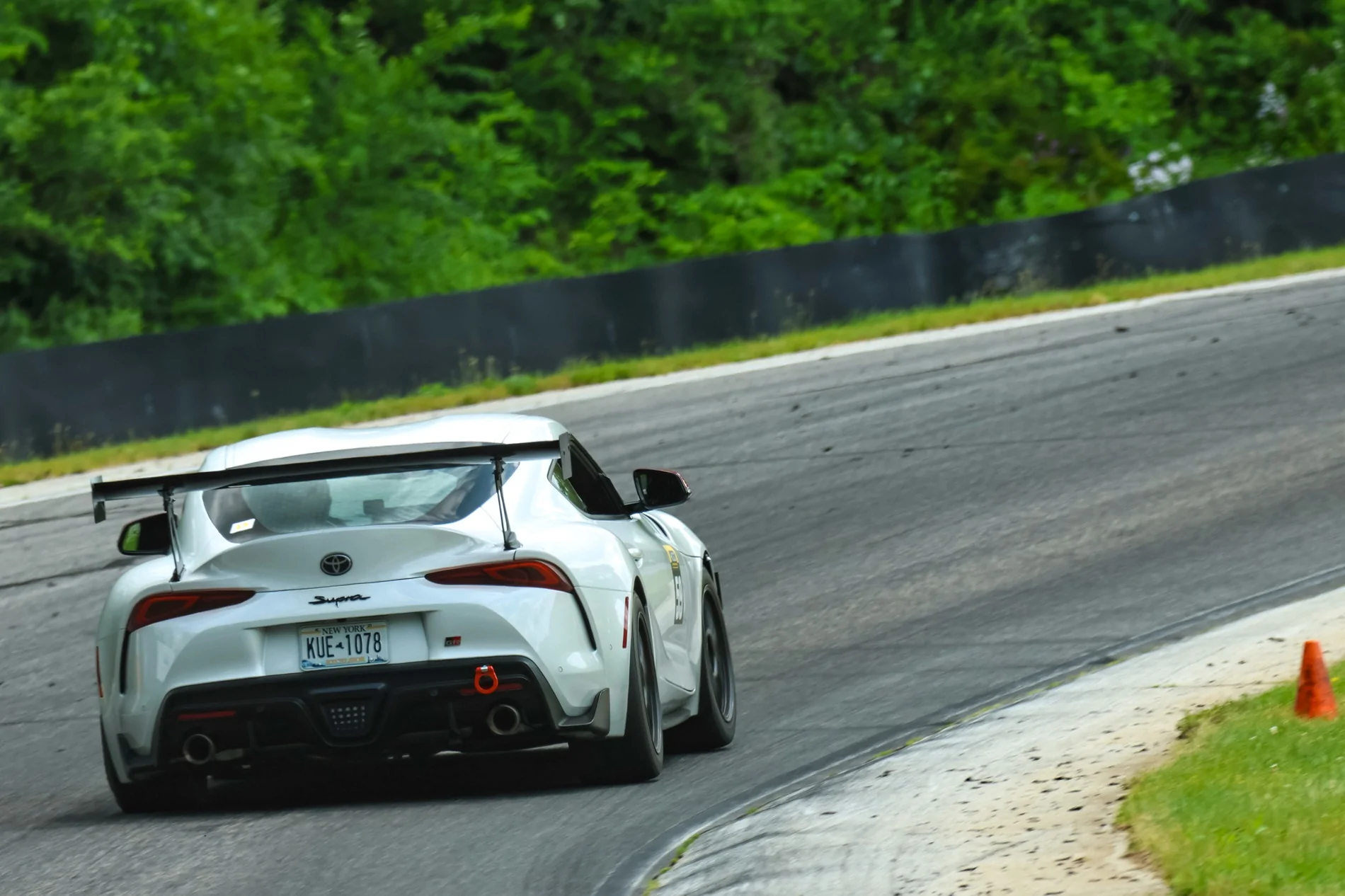

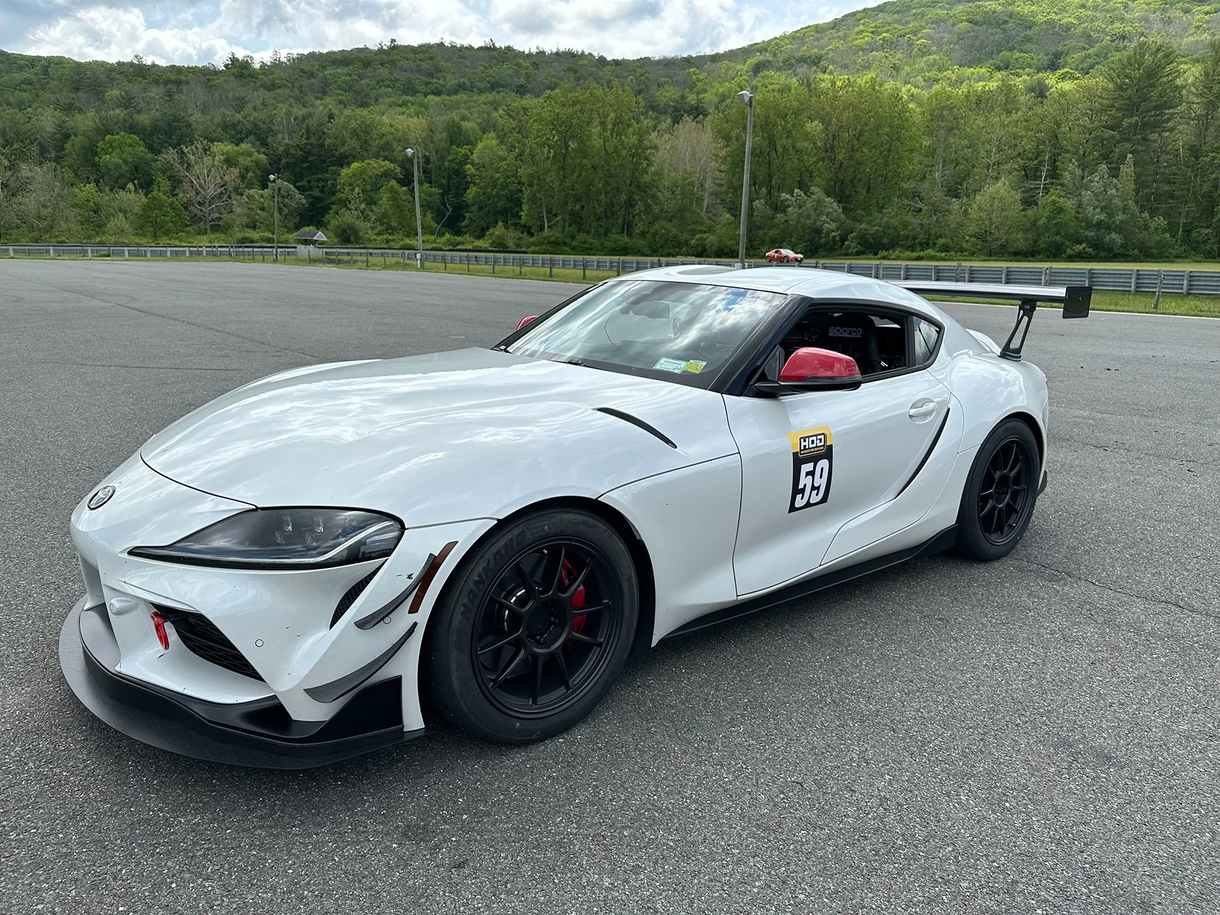

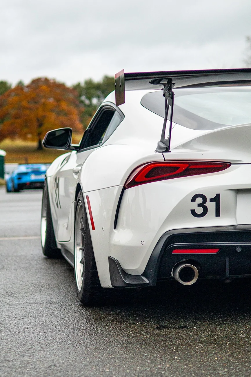

What would you choose between 18x10.5 et35, or 18x10 et30 if using 275/40/18 CRS tires on stock suspension?
Rear fitment doesn't really change OEM suspension vs coilovers. Front is what changes because of the perch. I'm not an expert on OEM suspension front fitment so I would ask others here.
As far as what wheel width the 275/40 CRS would feel better on, 10.5 all day.
Here are some images back when I used 275/40 CRS on 10.5's:
