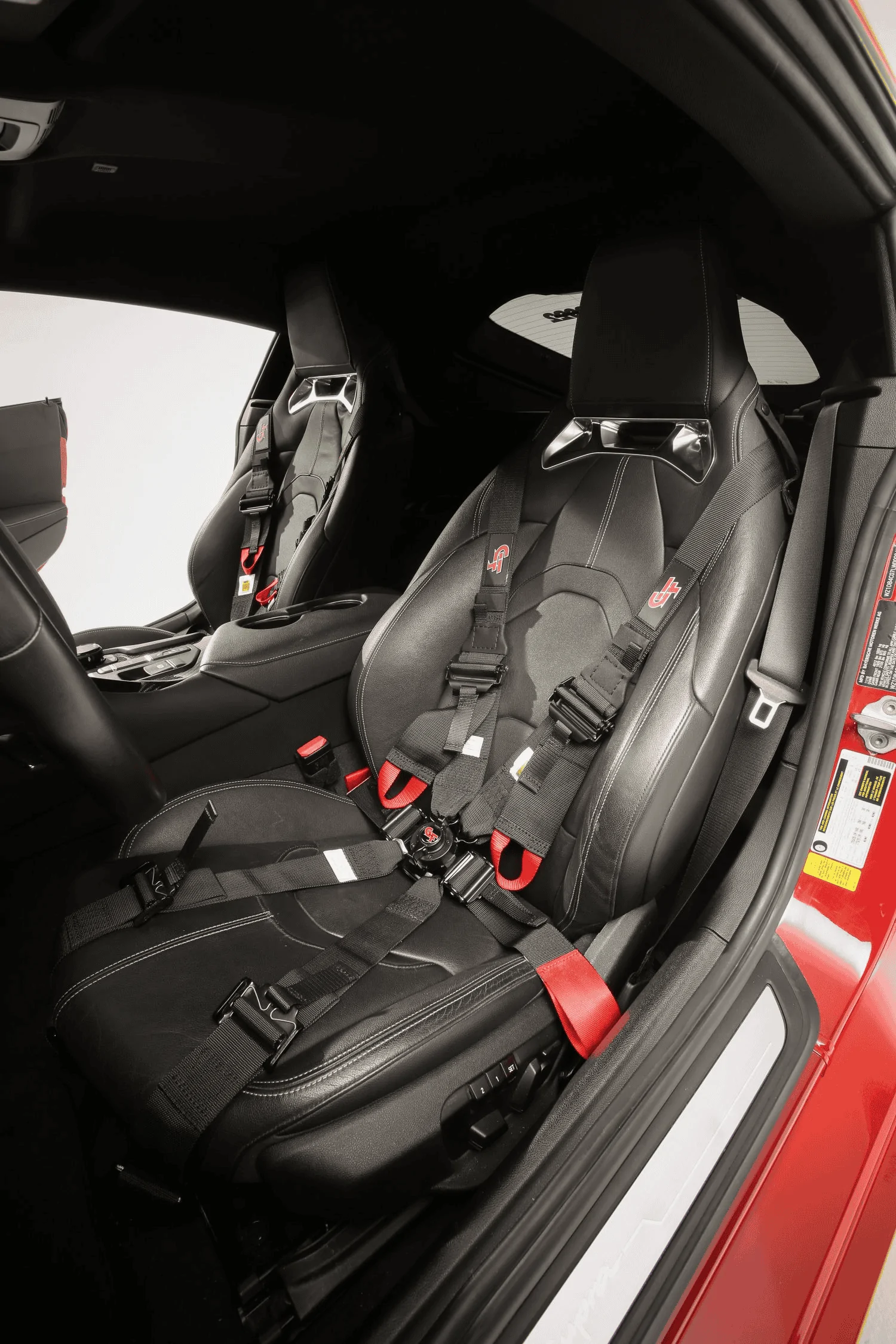

can u leave the oem safety belt and install five point hardness at the same time? it would resolve the ball running issue lol

yes and no.
first, there is no point doing a 5 point and not a 6 point. everything is moving that way.
yes, it is possible to retain the factory 3 way belt.
I do NOT recommend. everyone wants the cool "race seats" but using a 3 point with a proper hi sided race seat you risk additional injury.
not worth it in my book. either do it right or stick with oem seats and belts

Not quite sure why you say that. I just completed an install where I have a 6 point and retained the 3 point belts. I replaced the seat of course - with a seat with proper harness holes. Its not a racing bucket; its the Recaro Sportster GT which you can get with sub hole.
I plan on doing a lengthy write-up in a separate thread. It took me a long time and a lot of work to get everything to fit but I'm very pleased with the results. I've done this also in 2 other cars (Lotus Exige, Porsche GT3).
My motivation - 3 point to drive to/from the track and around town. 6 point for the track. The Lotus and Porsche had kits that made the install easy. The Supra - well, it wasn't too hard to get the parts but the mounting bolts/screws and lining everything up was a jigsaw puzzle in like 4 dimensions. It took me a while but I'm very pleased with the results.

got it. but the only retaining oem safety belts are for daily driving. i wouldnt use that instead the six point harness on track tho.

I think you misunderstood what he was saying. I believe he is saying using a OEM 3-point with a racing bucket on track isn't the best idea.
I also have both the OEM 3 point I use on the street and a 6 point that I use on track.
