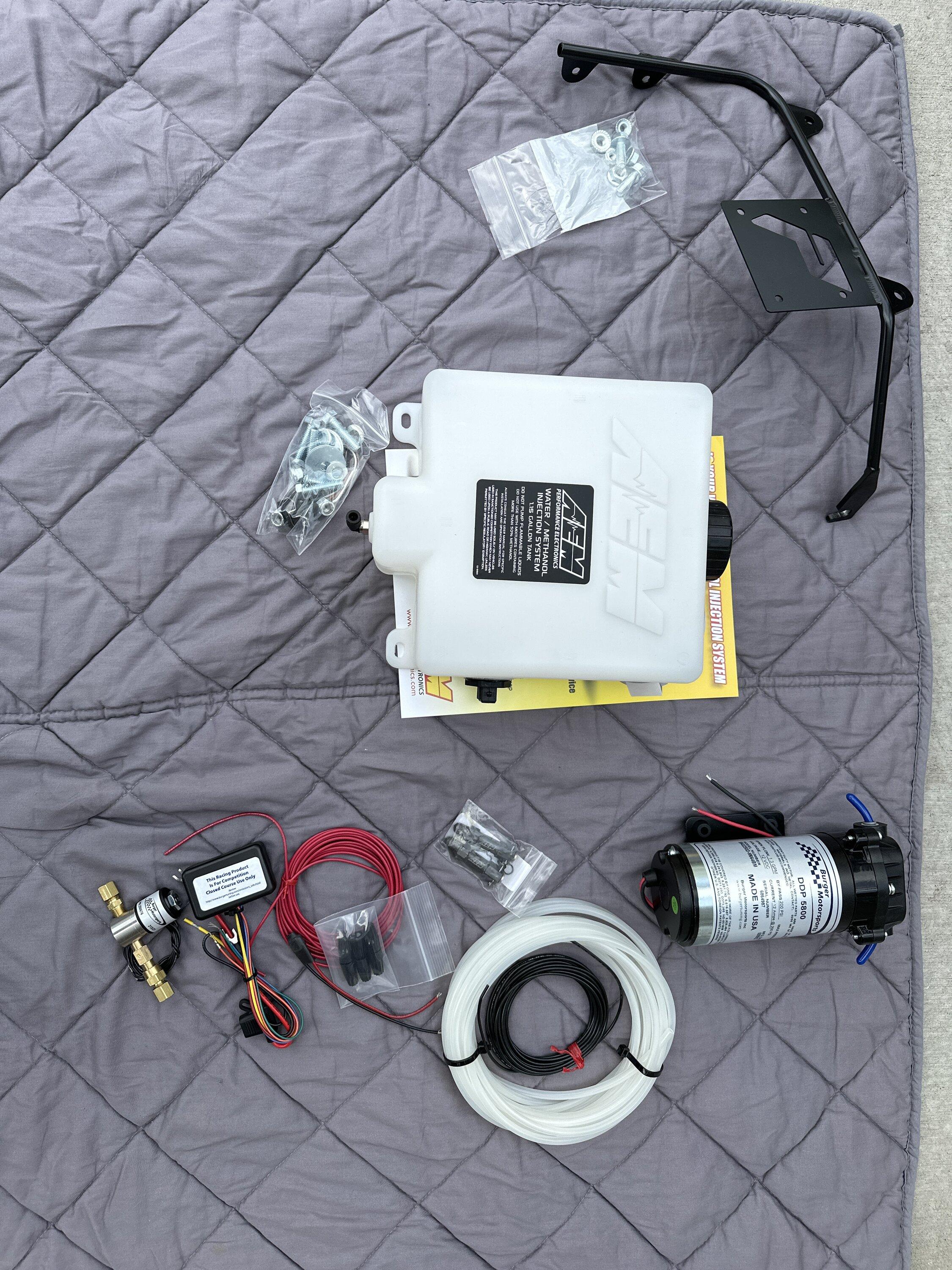

Awesome. Couple of questions regarding the Meth. Which kit is this? What options such as tank, bracket, injectors etc.. Does this link up directly with the JB4 or is there some other controller or fail safe you have to buy? Did you install yourself or have someone do it? Any comments regarding the quality of the kit like fitment, ease of install, quality of instruction, etc.. Any impressions of transitioning to meth (like how much a slave are you to having to check and make sure you have some meth in the tank before you take the wife out to dinner or risk blowing up the motor).

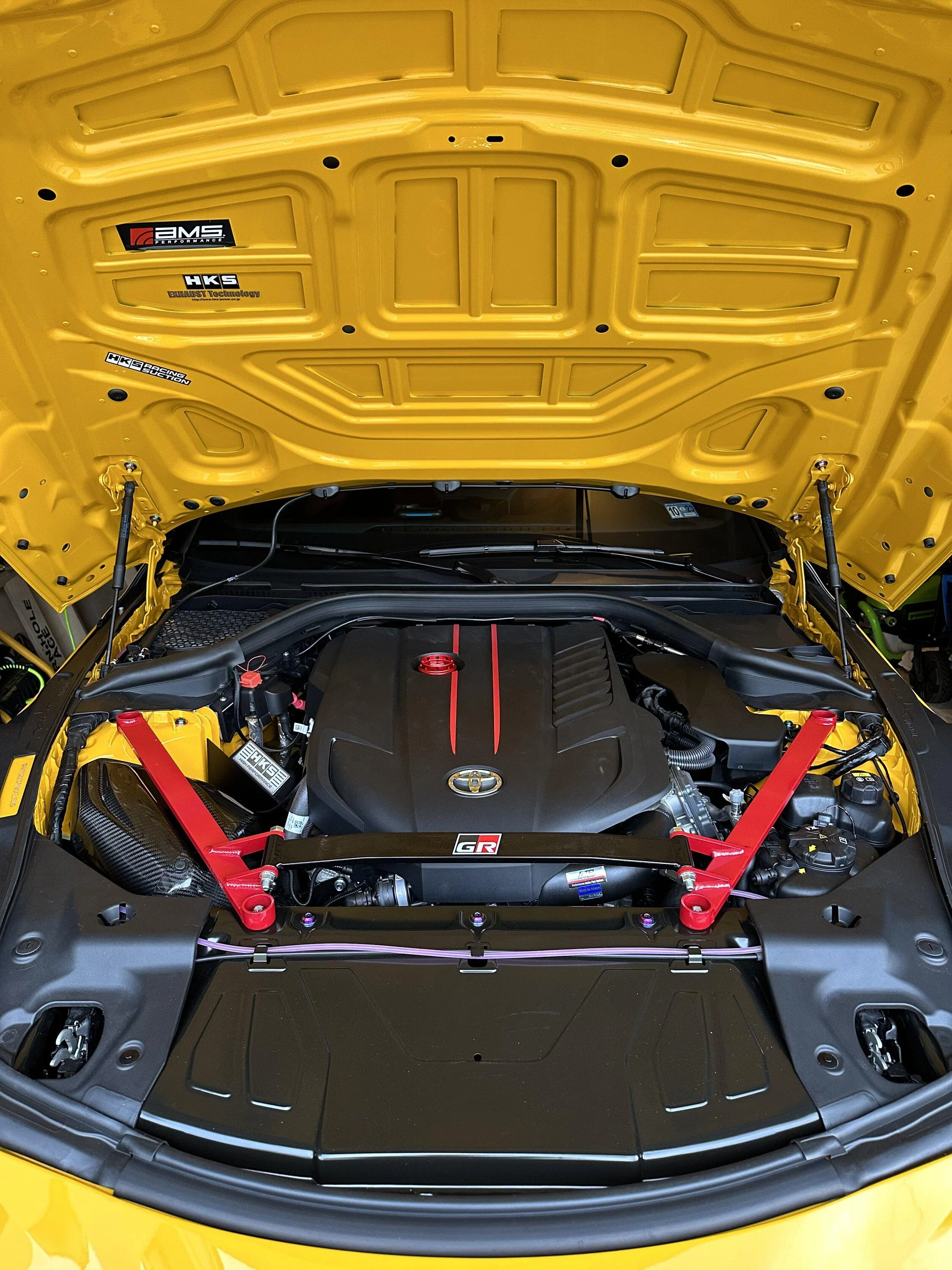

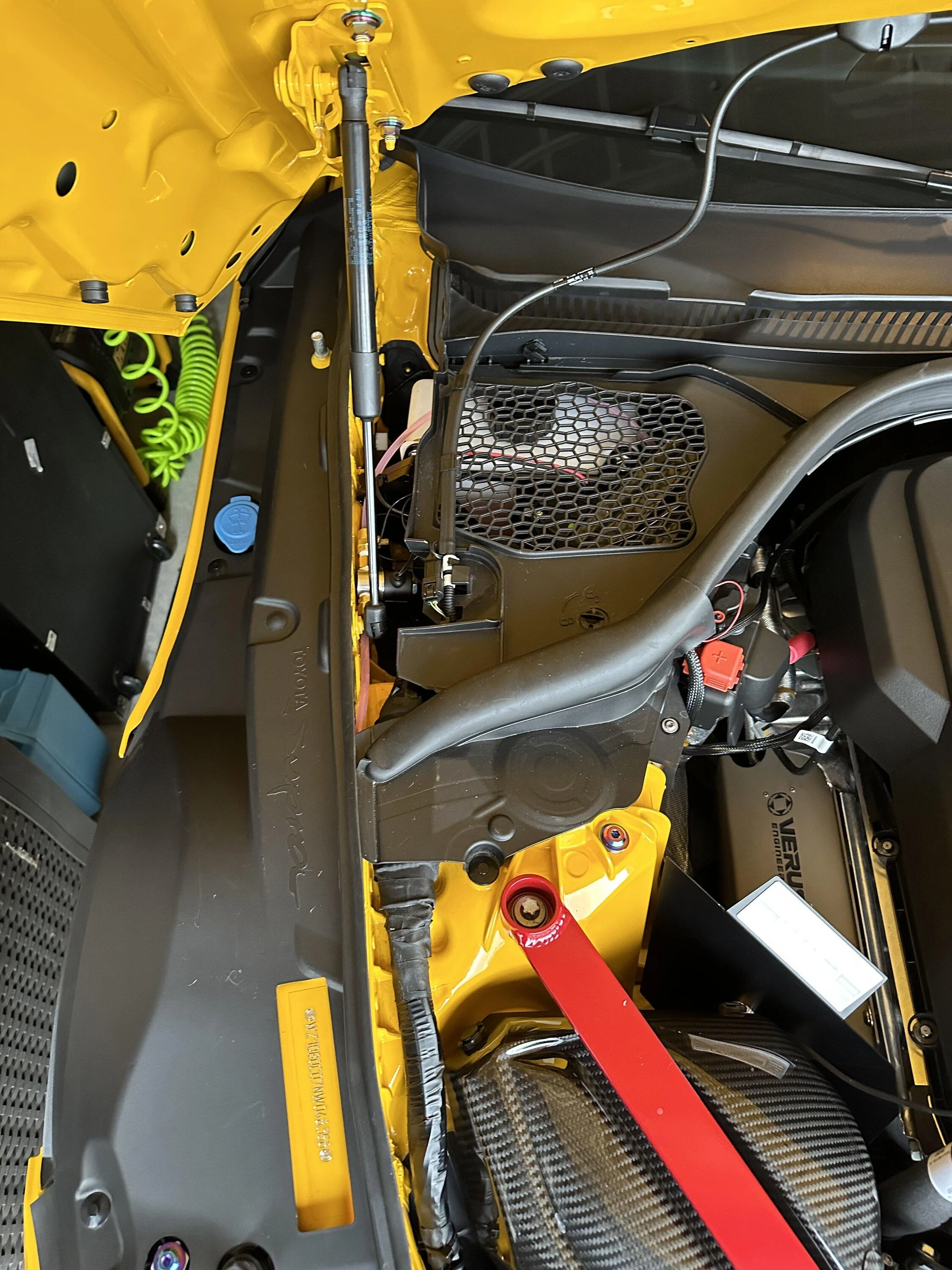

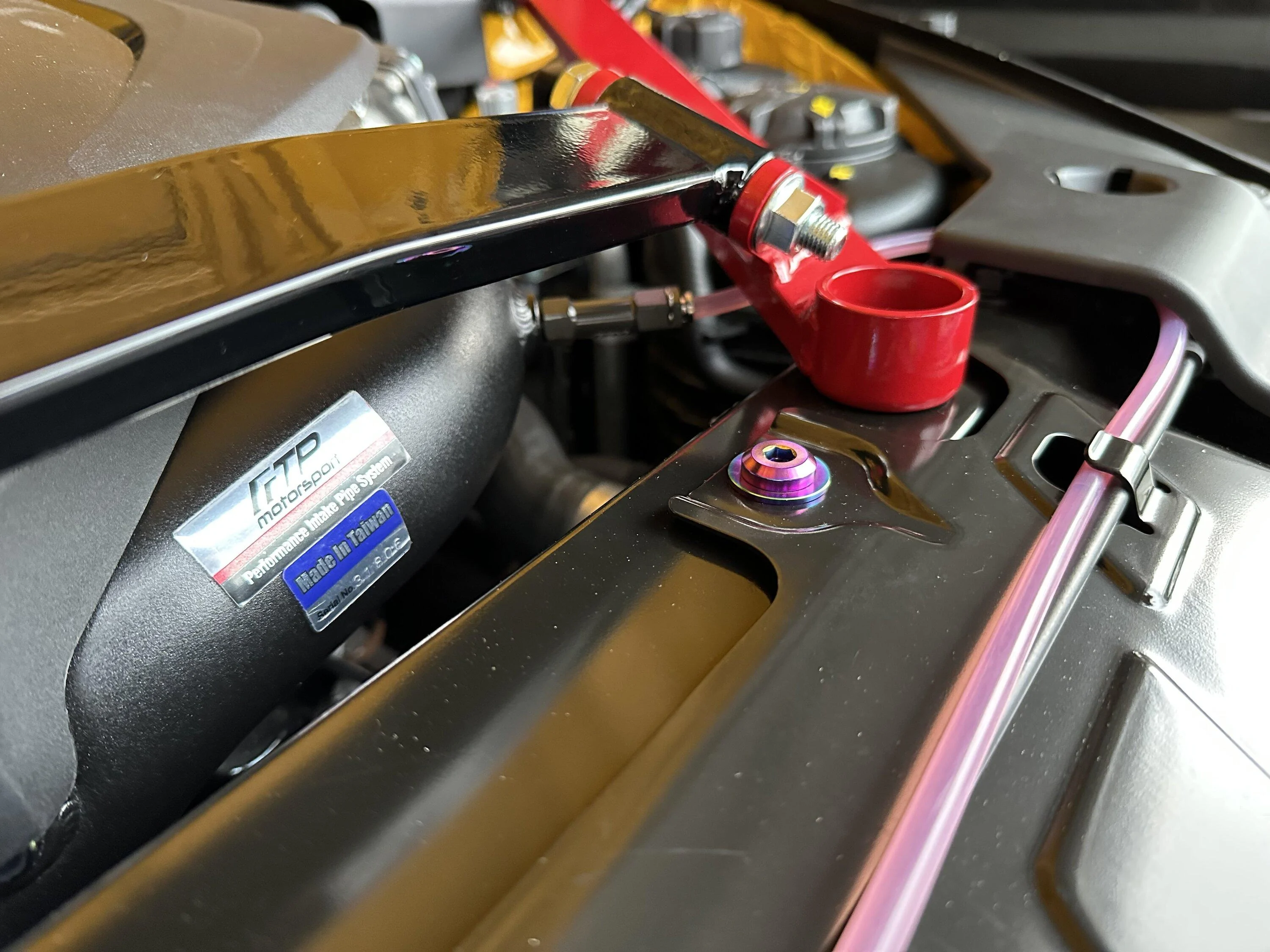

get with @Jesse DaBears, he is the owner of 1FS. the kit is comprised of high quality parts from a couple different manufacturers to make the best kit for the JB4 (IMO).. Yes it links with, and is completely controlled through the Jb4! We (jesse and I) have just began revising map6 w/ meth, so I haven't even gone through much yet. It injects on hard pulls, if you're not pushing hard it won't run. The install was moderately simple, just take your time.. It fits in the passenger side vent area like a glove! (Also, there are failsafes in JB4 if you run out of meth.. or you can just drop to map0)
1FS Stealth WMI Kit includes:
AEM 1.15gal tank
2x AEM V3 injectors (I'm only using one)
BMS pump, lines, solenoid, and FSB controller(for jb4 integration)
P2uned bracket
All hardware (I had to drill the bracket slots slightly bigger to accommodate the included bolts for attaching the pump)
