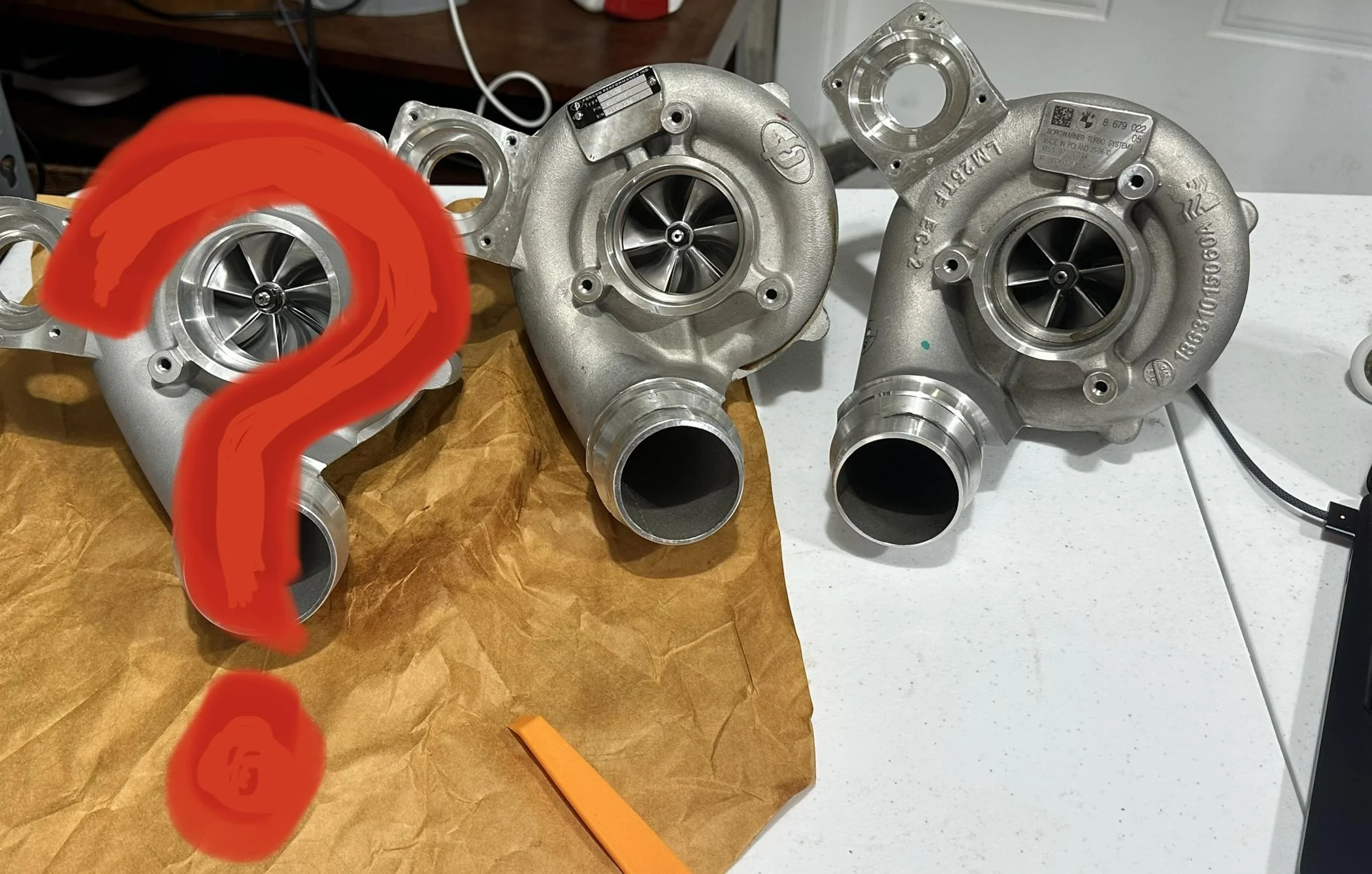

Just a little teaser… will talk about it in 2 weeks ;)

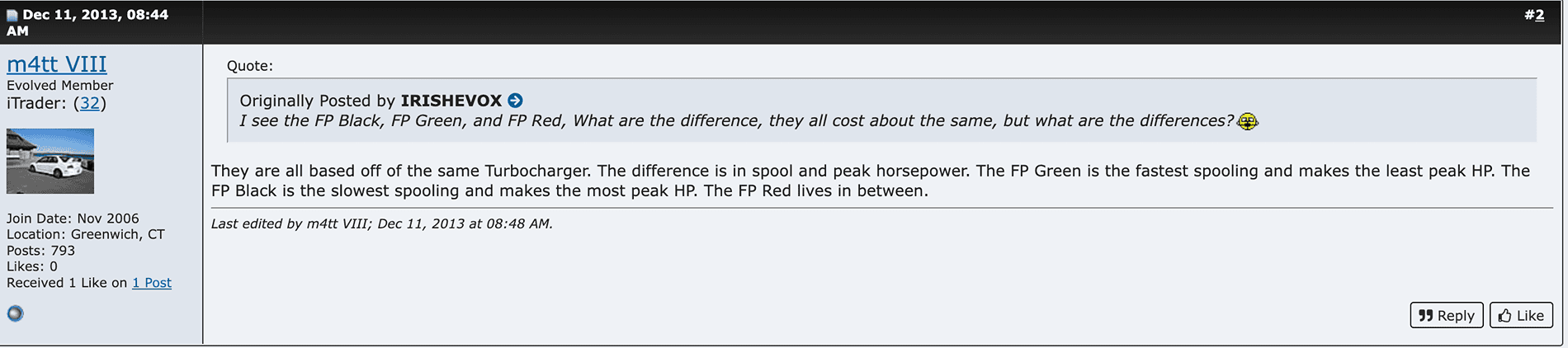

I'll chime in. It made less power to the wheels than Stock turbo + downpipe even with port injection (1050cc injectors). It wouldn't even break 500whp over E50.
I've done some research and figured out what FP's objective was for this kind of turbo.
A guy from the EVO forums explains the different kinds.
Seems to me that there was no conclusive R&D done for the Green and this explains why the results are so poor. Yes, i'm experiencing a quicker spool but it can't hold anything above 24 psi. They were talking about an FP Red that was ready to be tested(and supposedly would perform well) but they have since ghosted me upon getting my feedback. ?
In regards to my post further up, i'm willing to bet it was more of a placebo effect for me. The car felt faster but again, that's because it spooled faster.
