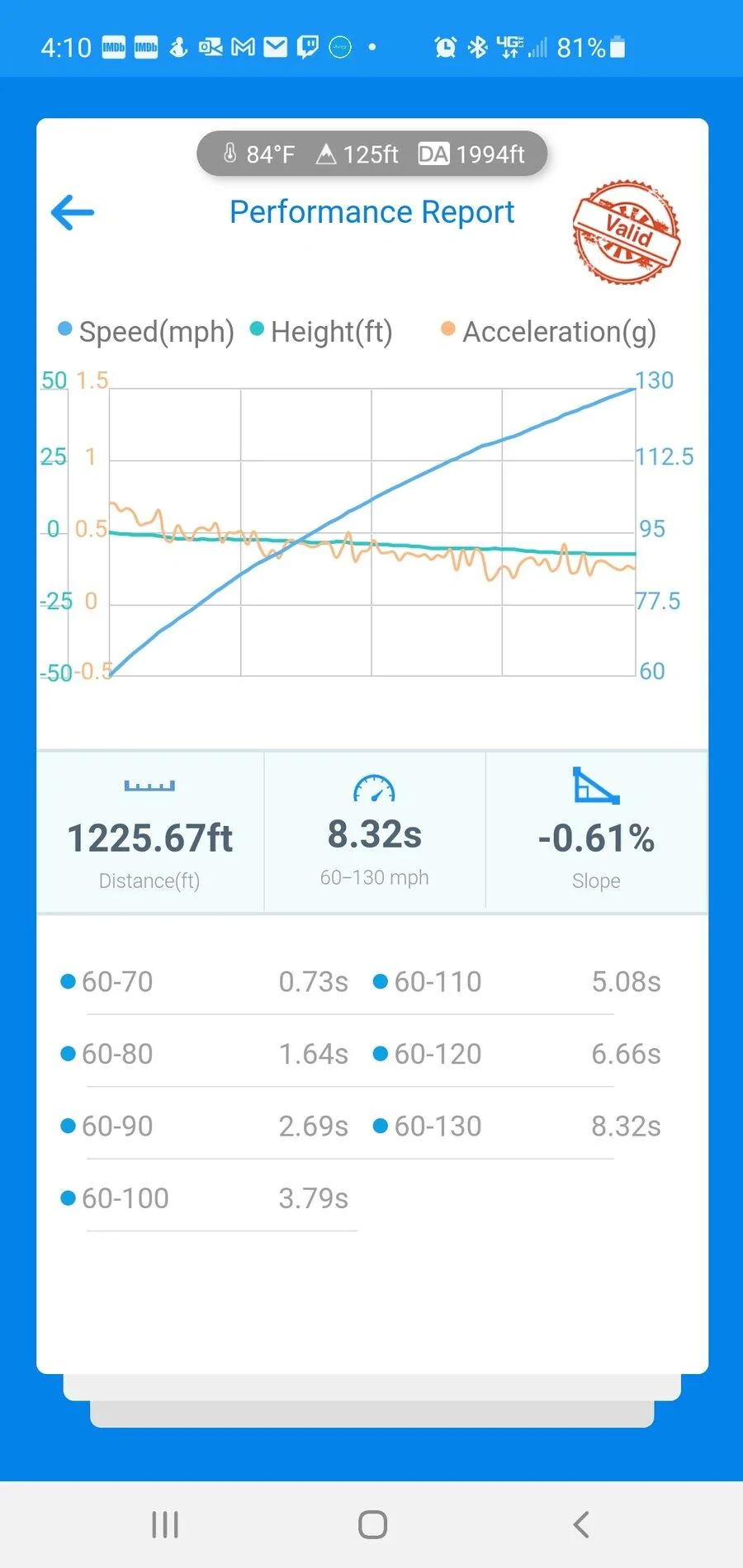

MHD, custom tune revision 6, E40 blend. Tuner just said we can up the boost a bit more as well. I'm very happy with this. The car ran 3, back to back 8.3 second 60-130's.

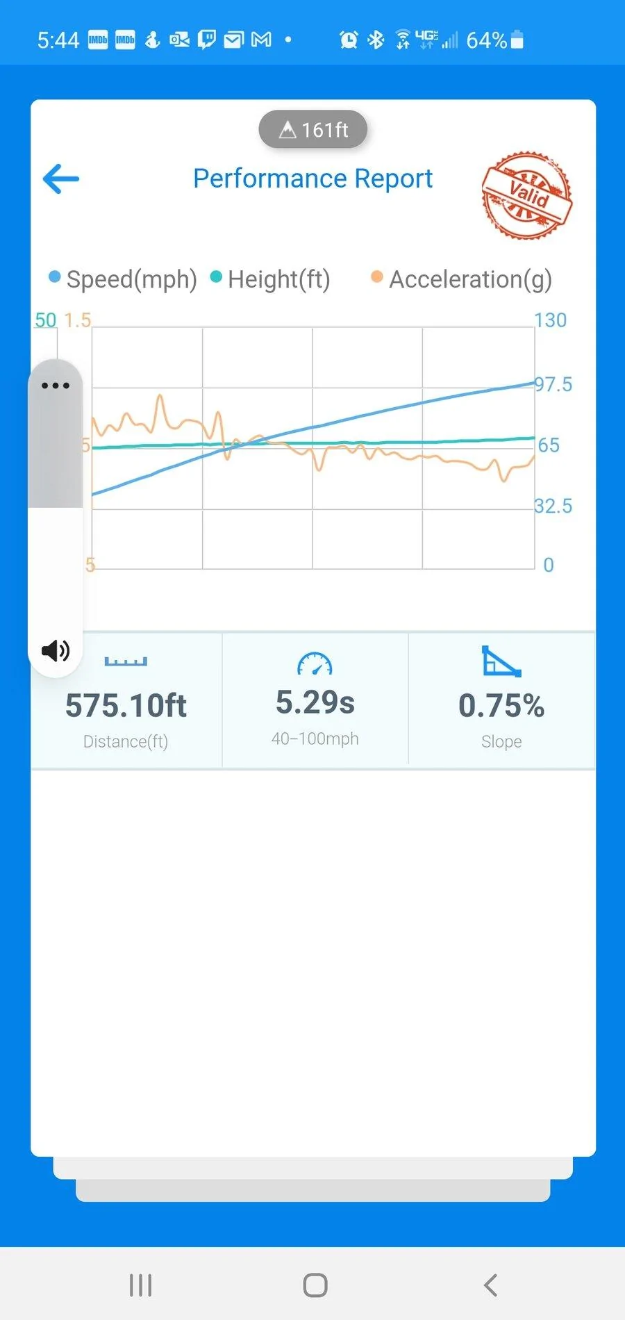

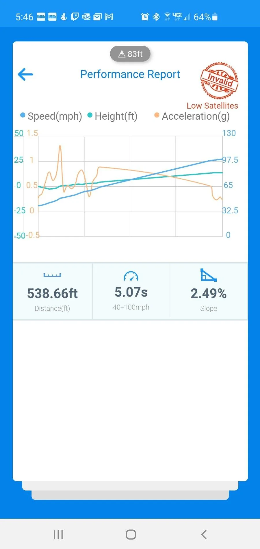

Also ran grabbed these 40-100's while I was out today. It's odd how "low sats" can invalidate a run, either that or the slope being 2.49+ caused it. I live in the middle of fking no where lol, nothing but farm fields and back roads.

5 seconds 40-100 is insanely fast especially uphill. Look at the acceleration graph, too. If you can't get a good satellite read you'll have crazy numbers like that.
Yea I gotcha. Well the average valid runs I have are all around 5.25-5.35. The car is certainly getting quicker with each MHD tune revision. I can't wait for the next revision with "more boost". Currently only at 20-21psi.
