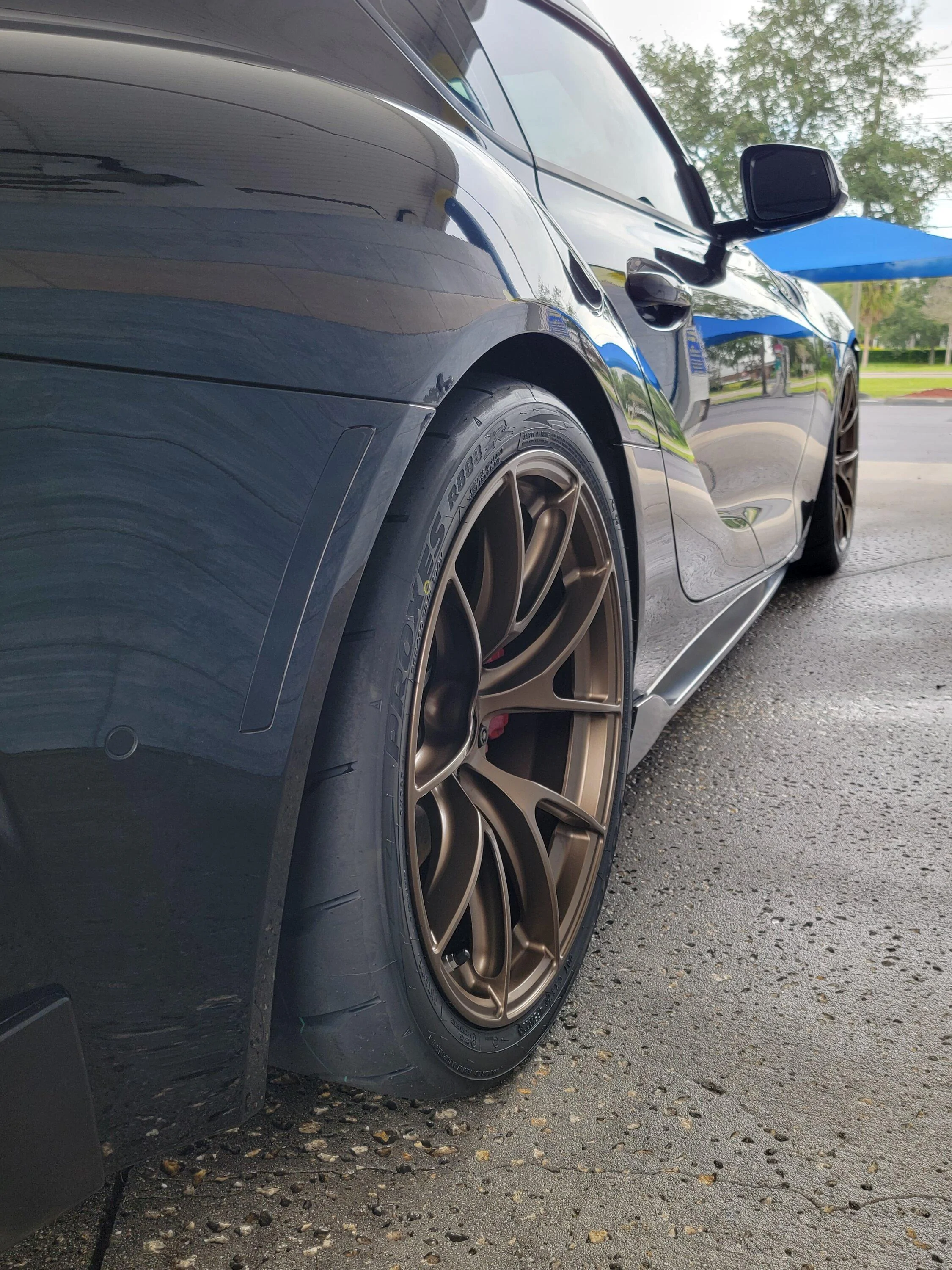

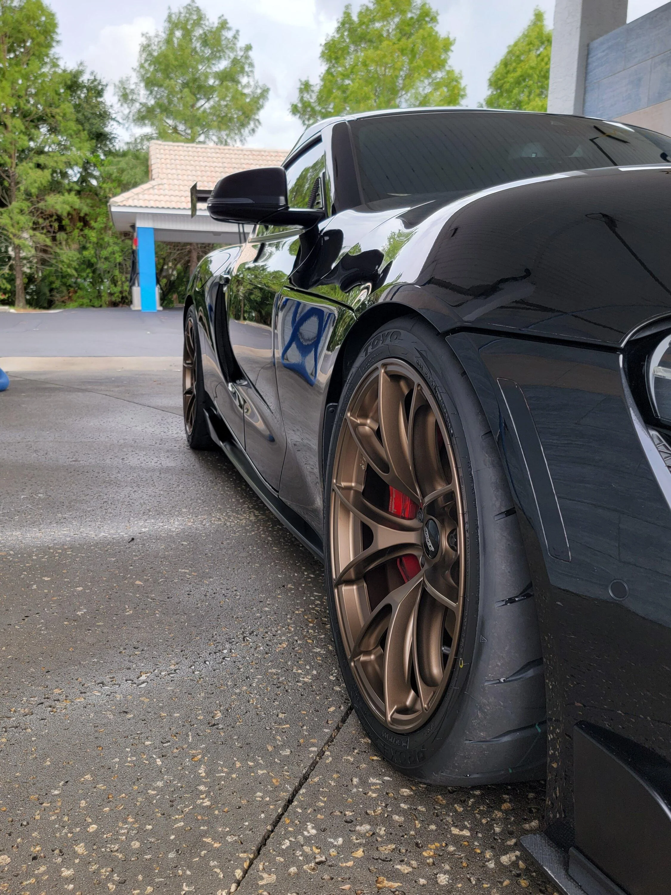

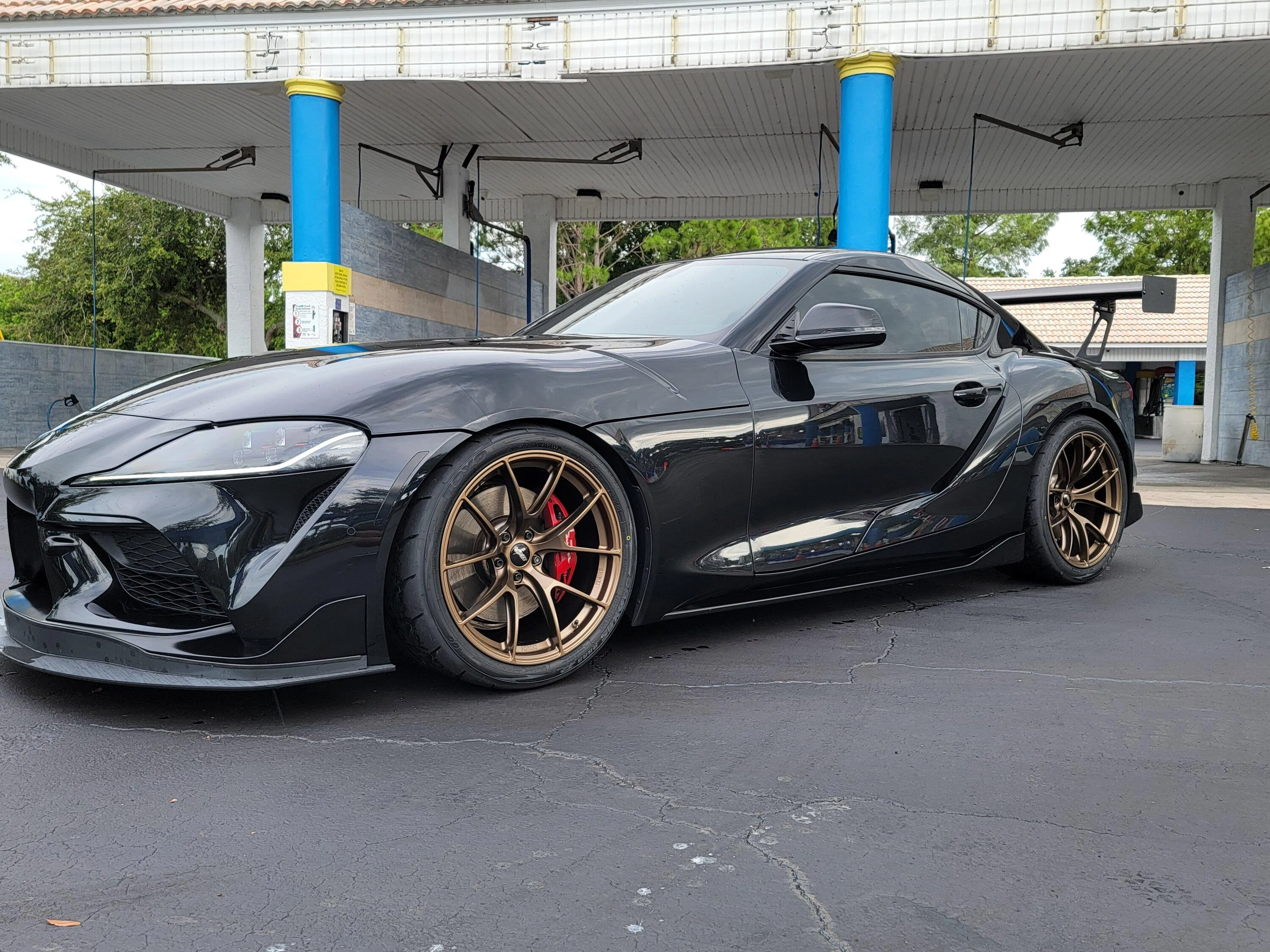

Just got my wheels in today! And 1 out of 4 tires lol stupid fed ex. More time to use what little is left on the oem tires I guess.

19 x 11 VS-5RS 40 offset square
Toyo Proxes R888R 295/30/19
HKS height adjustable spring
Verus camber plates
-3.4 degrees camber
lowered 1" on the front, .75" on the rear
No spacers
Damn, these look epic on your supra! Mind if I add this to the 11" square fitment thread and our Photo library? Happy to credit your social media or forum accounts when we share the photos!
Any rubbing under suspension compression?

Thanks and happy to help others know what fits so add away. Ig joe_liska

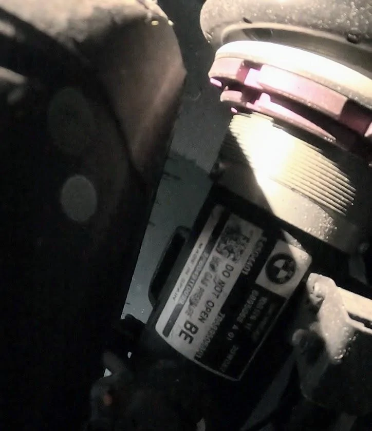

That's what the inside looks like. Haven't noticed any rubbing on compression. As others have mentioned it does contact the fender liners at full lock. So parking lots can be fun.
