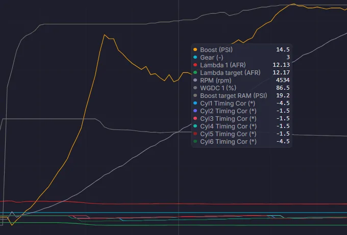

sorry what turbo is this? a 6969 like the log says? 86.5% wgdc for 14.5 psi at 4500? I would check for boost leaks my friend :) This can cause corrections as the turbo will overspin for your target boost.

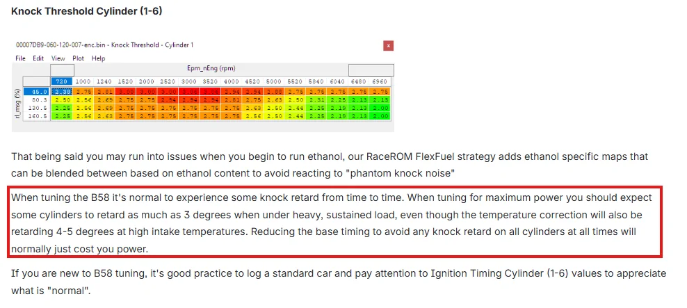

While I agree you don't want corrections, you are forfeiting a lot of power if you reduce timing till there are none.
Per ECUTEK B58 Tuning Guide :
My general rule of thumb is: No more than 1 cylinder correcting at same time, and 3 degrees or less. Occasional single cyl corrections (as long as its not always the same cylinder) usually mean the car is right where it needs to be.

What’s up Adam, thank you for your response! I follow you on IG lol. Anyways, I did a smoke test, I did have smoke pour out from my inlet that connects to the Crankcase Ventilation hose, it is fixed now. With it being upstream from the compressor, would it even possibly affect it that much? I forgot to mention, tuner said that he has me on "Boost by gear" and capped me at 20 psi on 91 oct. Also, if that's the case on timing corrections, would my 91 oct log would be considered "bad"? I'm pretty stumped since on my e40 log, 3rd gear pull seems fine but when i shifted to 4th, my timing correction values are all over the place.

I was replying about the 91 log, but I checked e40 off your datazap page too. Doesn't look like a boost leak there, I just hadn't noticed how high your DA is until now.
For the 4th gear corrections, I would fix the following:
  • adjust rail pressure to not overload the hpfp and put a bunch of drag on the exhaust cam
  • raise oil pressure to improve vanos exhaust tracking
  • increase the IAT timing correction factor (this is probably your ticket)
  • richen AFR
  • Use MHD+ boost control and PID because why TF are tuners still not using it. Smooth like @Traxion logs
Yes. Don't get me wrong, its not imminent danger. Certainly not up to my standard.
Most people's OTS logs look like thisšŸ˜‚

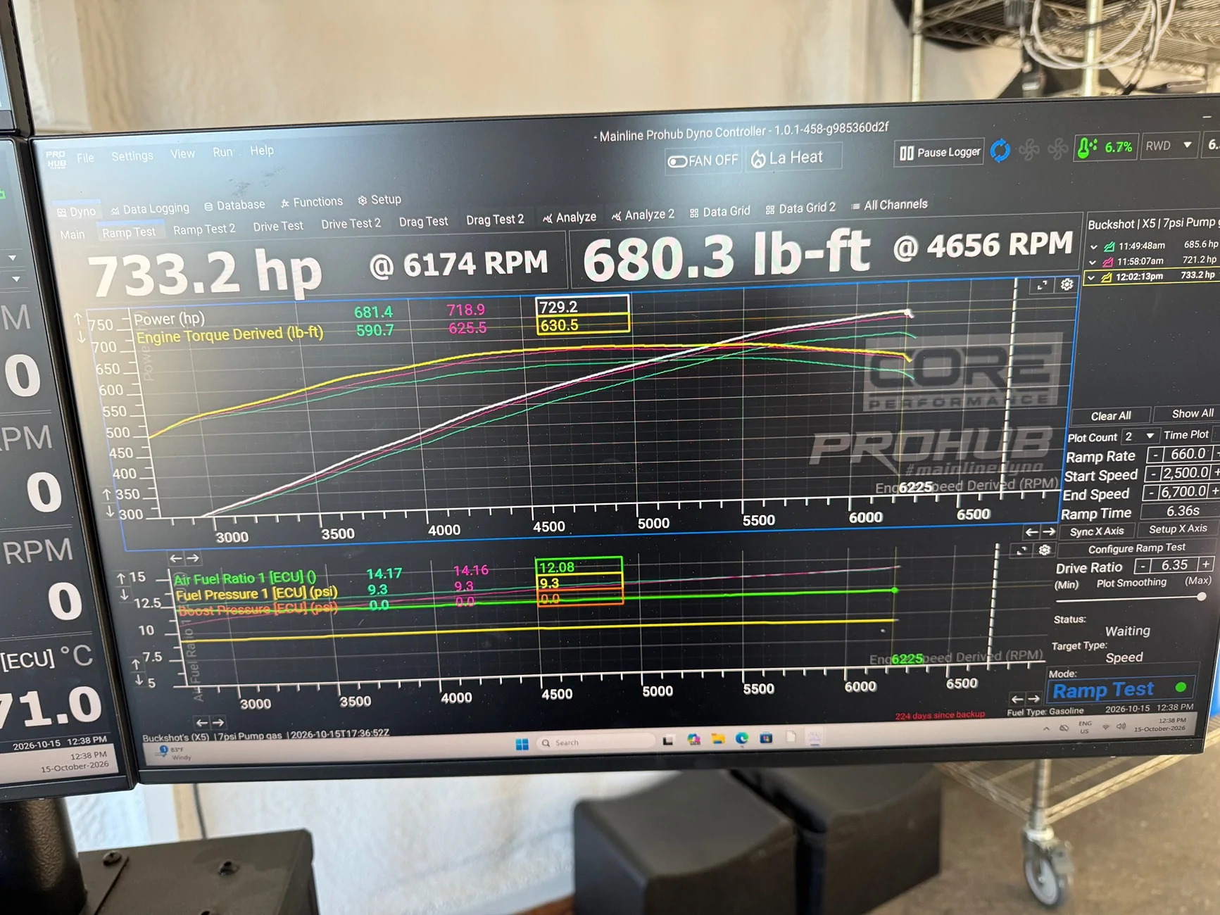

exactly why I didn’t reply to that….
example of a car I tuned today. Look at the top right. Pull one was my base map. Pull two was adding 2 degrees of timing. Pull three was 2 more degrees. Even though it made more power, it had corrections and did not make a big jump in power. Which is why I bumped it back to the same timing as the second pull. Zero corrections. Every tuner does things differently though.
and this is coming from someone who normally does a bit higher hp cars…
