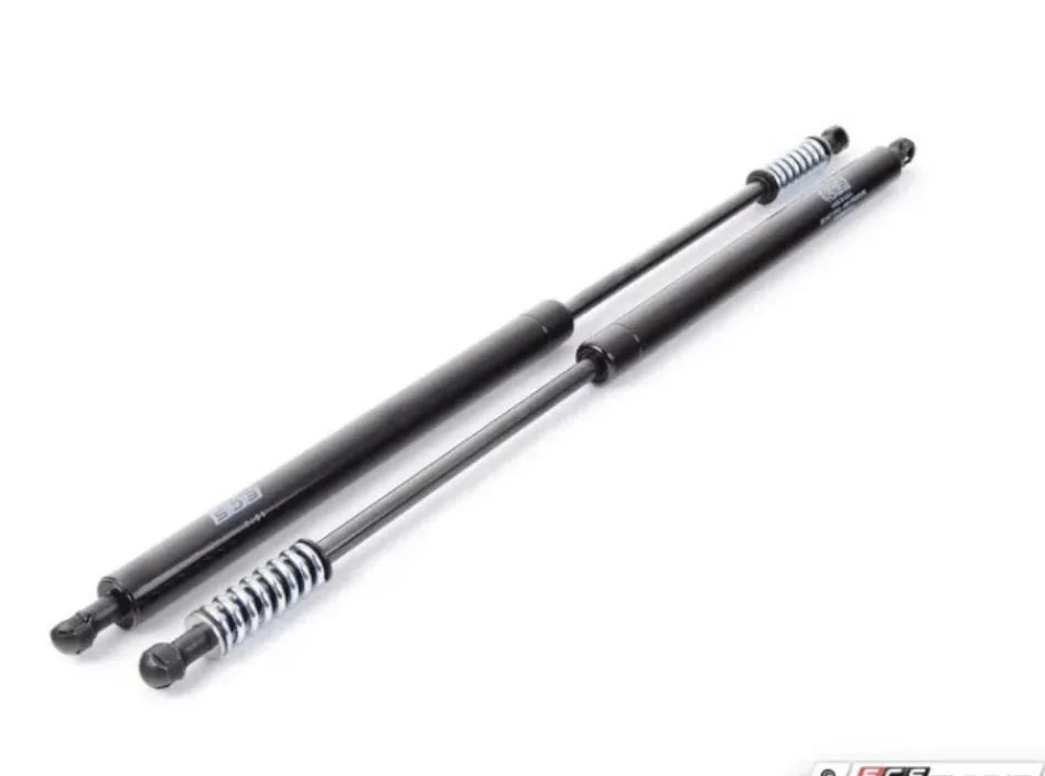

These below would do the trick. Others and perhaps same company may offer these. The small spring allows for the initial inertia lift.

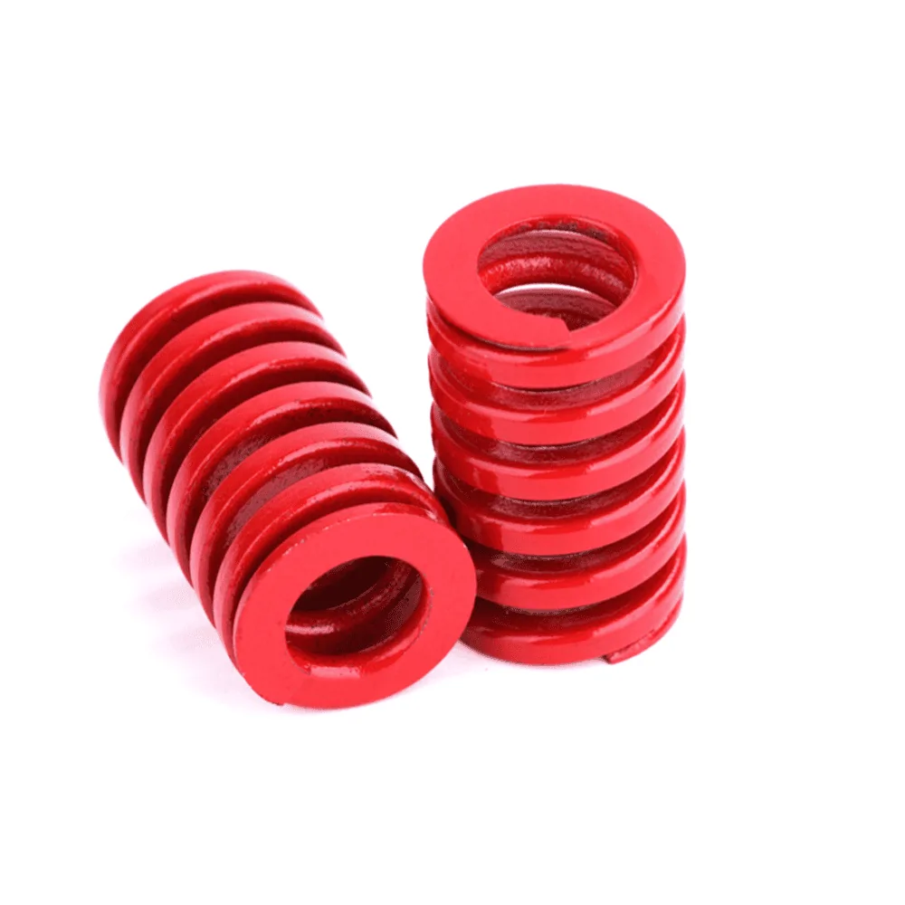

(eBay) Tesla Model 3 Die Spring (13mm diameter)
(eBay) Tesla Model 3 Die Spring (US Seller) (13mm diameter)

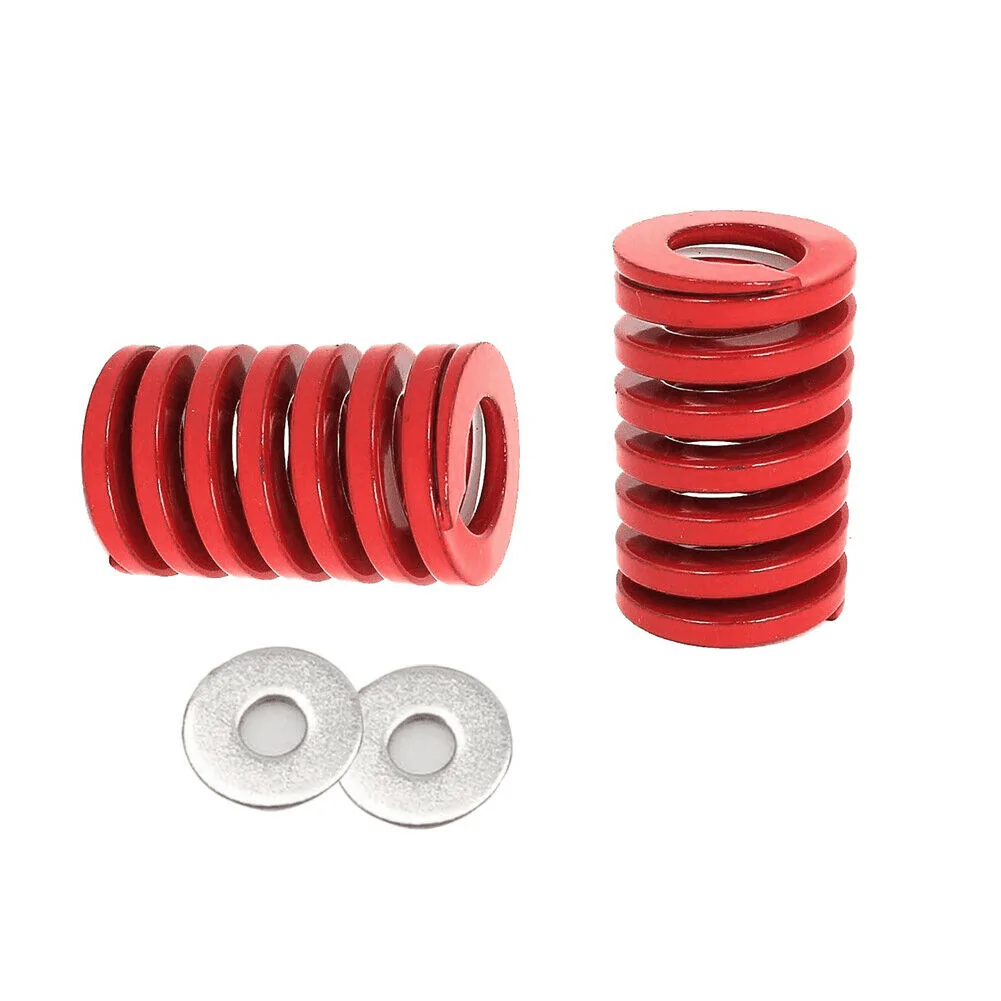

(Amazon) 2.36"/60mm Die Spring (Prime) (16mm diameter) (No Washers)
(Amazon) 3.15"/80mm Die Spring (Spring) (16mm diameter) (No Washers)
I may try this with the OEM struts. Seems to work for Tesla 3 owners. Unfortunately their struts only go up 13" extended length. Otherwise could've just bought those lol.

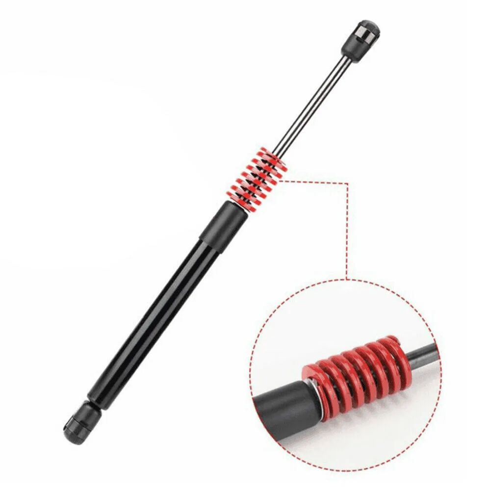

Installation Video. This should be all we need. I will order later today and post results.

I have these two in my cart and will probably get some washers from Home Depot or see if someone has some laying around.
I went with higher duty spring and some 97lb struts. Watching Andrew's video, seemed like 120lb was still a bit much (end of video, the trunk was jiggling). Hopefully my combo works.

Okay… I purchased a helper spring from Ace Hardware… to complement the stronger support arms… Bingo!
