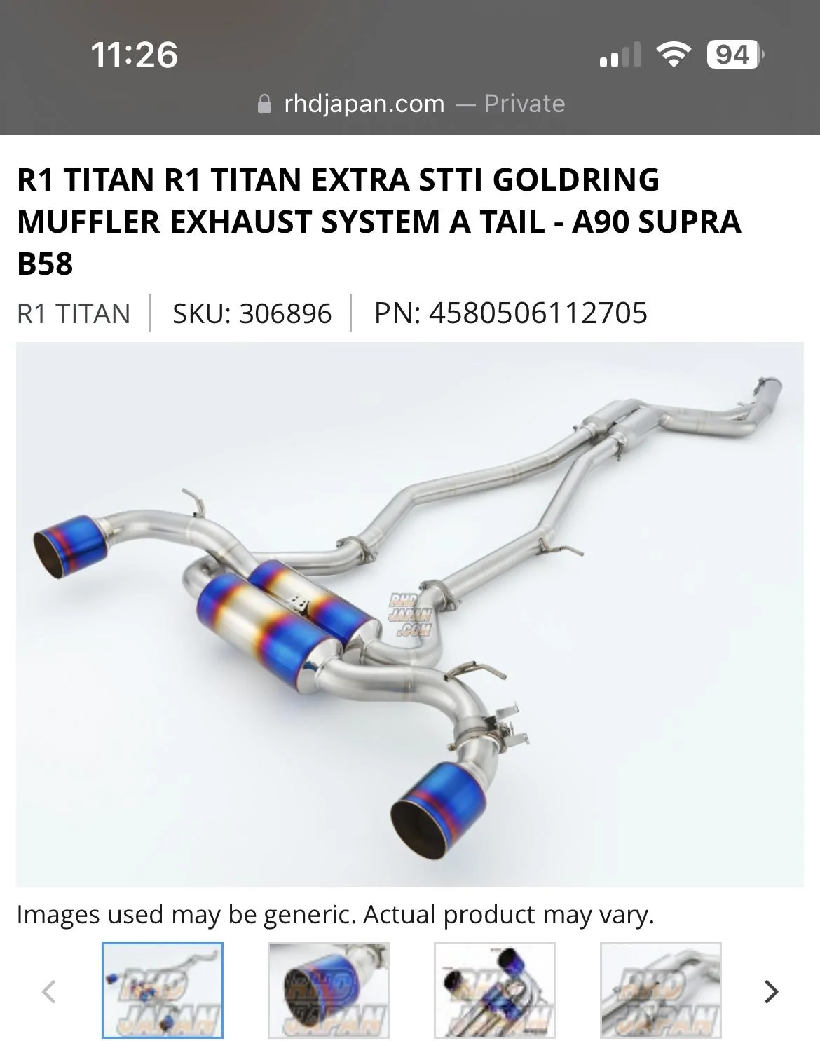

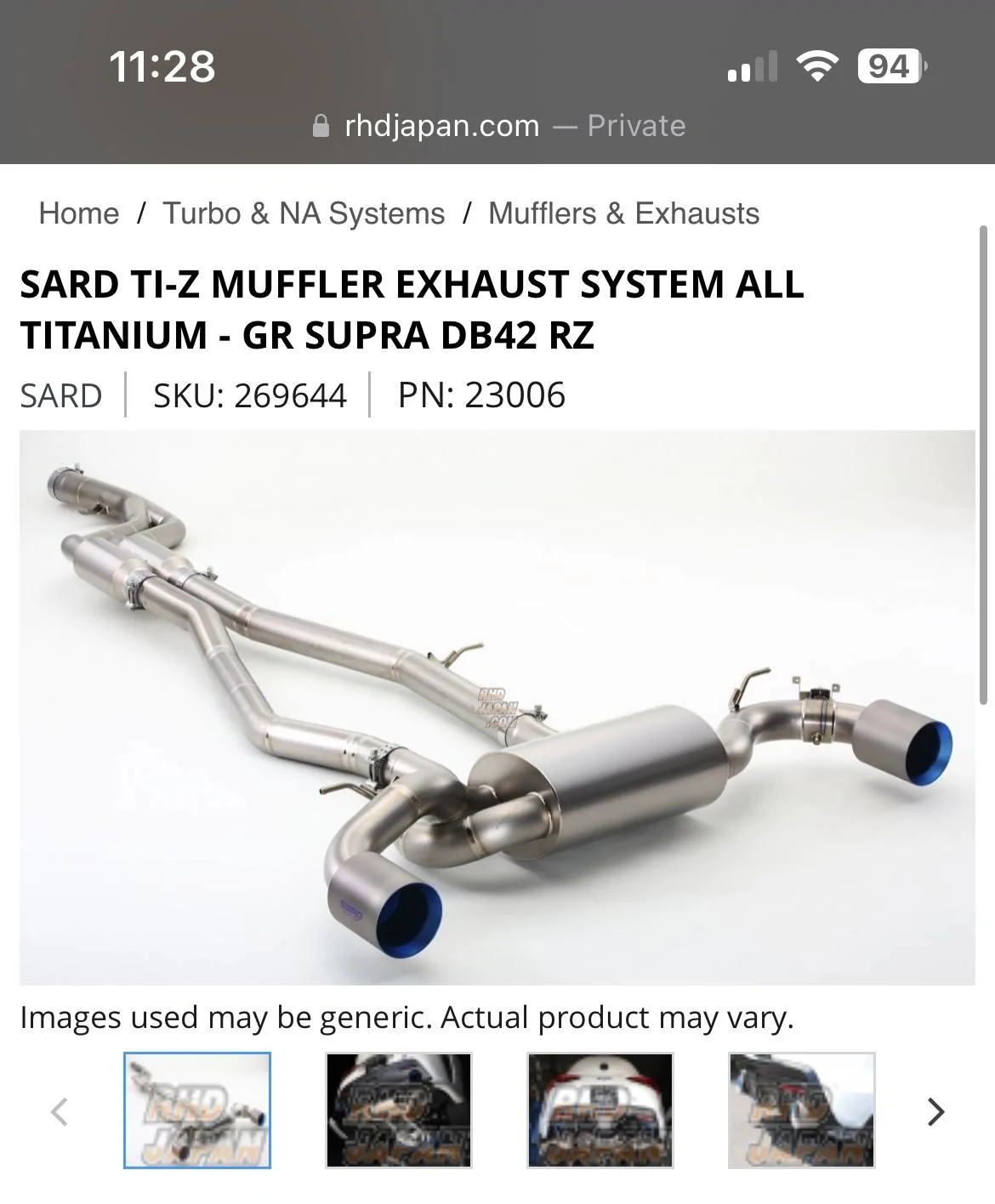

biggest concern with these I have seen is the cracking along the welds, sound good tho!
It does not surprise me to hear this. Titanium is extremely difficult to weld. Joints need multiple stages of grinding and acetone cleaning to remove surface impurities. After tacking the joint, you need a very long argon back purge time to flush out atmospheric impurities that could compromise the joint--time is money, and so is the argon. You can only weld in roughly 1" segments at a time, and the cooling bead must also be shielded with a trailing argon shield.
Just as an example, the titanium welds in the SR71 Blackbird project were cracking because one of the technicians had a screwdriver with cadmium in it. Welds also cracked because municipal water had increased chlorine content to control summer algal blooms, and the tools being cleaned with tap water had enough chlorine left to compromise the welds.
Any time the weld seam has any amount of color that was not added artificially through anodizing, there's an impurity in the weld and it will eventually crack. But it gets worse: the material impurities of anodized titanium can also cause welds to crack. So these beautiful rainbow titanium exhausts (not Boost Logic) are pretty much destined to crack at the welds eventually, starting first with brittle anodized layer and then with the metal itself as the titanium dioxide anodization layer made the underlying piping less flexible.
The best way to weld titanium is with electron beam welding (EBW), which roboticizes the entire welding process in an atmospheric vacuum. Oxides cannot form to contaminate the weld and you can get the seams done very quickly. But these machines cost six digits. Laser beam welders behave similar, except the part is welded inside a box that has nothing but argon for atmosphere. These machines cost high five digits.
Many exhaust companies are not going to pay for the most foolproof titanium welding implements. Anytime you see a report of a titanium exhaust cracking at a weld, it typically means that that corners were cut.
All of this is to say you wouldn't catch me dead spending a single penny on a titanium exhaust. The right degree of trust is virtually unattainable for something so expensive.
