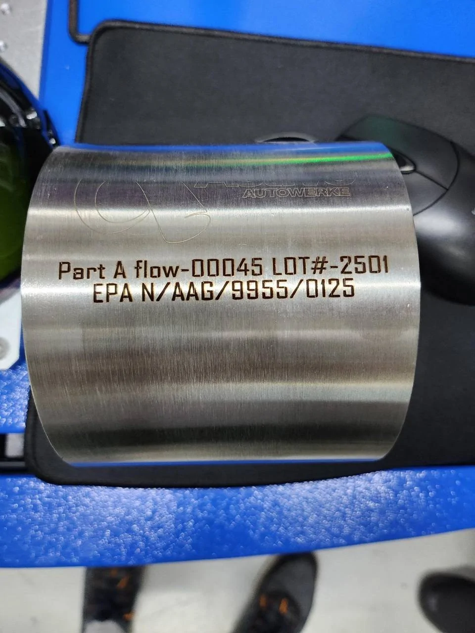

Looking back at this thread, I see nowhere that XPH is claiming that the down pipe itself is EPA approved, just the cat (As pictured). So I kinda read it as the converter itself is EPA approved approved but the application is not? I may as well leave the OEM pipe in place since I am not trying to make huge power.
But since you can't buy the cat alone, you have to replace the whole DP to get it, the EPA claim is kinda misleading, IMO.

Hey XPH, you might want to remove this statement from your website, you're setting yourself up for some serious EPA scrutiny:
  • Federal law prohibits tampering with emissions control devices; this product is compliant with EPA standards.
Secondary cat is 100% an emissions device. It's been removed from this product and replaced with a straight section of tube (test pipe), that's tampering.
Under federal law, catalytic converters may not be removed
and replaced with "converter replacement pipes' by any person.
The 1990 Clean Air Act Amendments even prohibit private
individuals from installing "converter replacement pipes" on their
own vehicles. Anyone who installs such pipes would violate section
203(a)(3)(A) and (B) of the Clean Air Act (Act).
https://19january2017snapshot.epa.gov/sites/production/files/documents/exhsysrepair.pdf
I get what you're saying here. Catalytic Converter is EPA approved, but is the downpipe with the EPA approved catalytic converter approved? The wording here is important for potential buyers.
Either way, I am in Cali so it doesn't matter to me lol. I know for Cali, people get confused all the time and buy an EPA approved cat for a replacement but will fail smog inspection because CA requires a California compliant EO Carb Number too.
