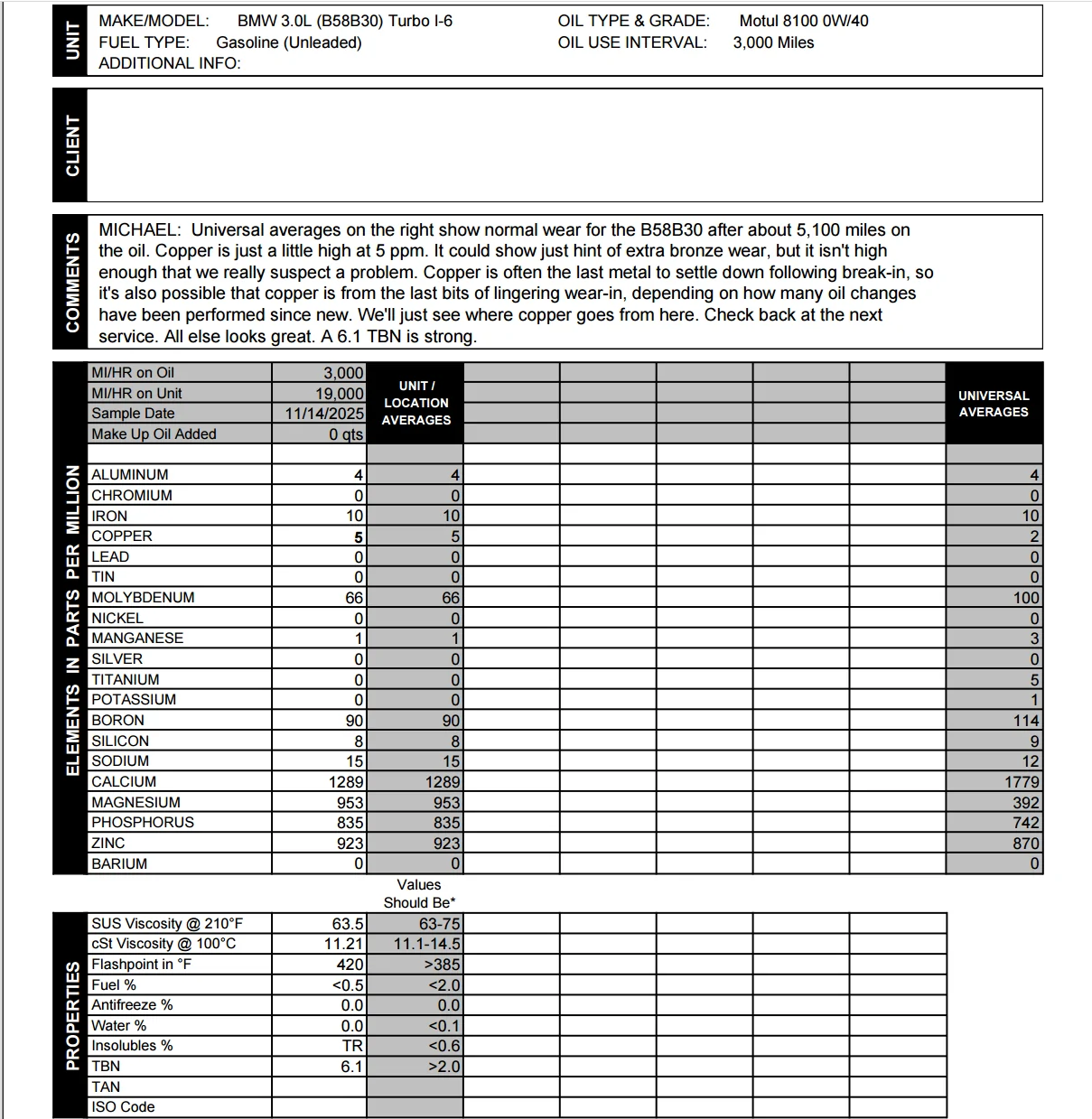

Oct 28, 2024
391
628
Austin
Your mom is my ride
Here's my first/baseline black stone. For context this oil change cycle was over the hot Texas summer. I daily drive the car, no track days - but I drive rather aggressively; full send touge runs, toll road showdowns, parking lot donuts, etc. So far so good. Nice healthy engine.
