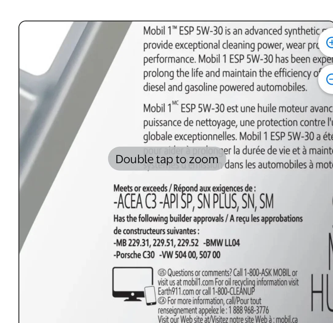

Thanks for adding that in. The LSPI resulted in the reduction of the Calcium (a detergent) in the oil.
I would stick with the TOYOTA recommended SN grade oil and stay away from SP grade oils unless they are backwards compatible with SN and SL oils. SN+ oil was an interim grade oil while SP was written and tested.
SP was written to address LSPI , SAP’s, which destroy the catalytic converters and clog the particulate filters in the exhaust. Supra’s in the USA do not have particulate exhaust filters. And timing chain wear because car manufacturers don’t want to update the material, double row the chain, or modify the lubrication process. Sounds like the GM 6.2L disaster. Just change the oil and don’t address the root cause of bad engineering.
While SP grade oils have 1% or less SAP’s the SP grade oils also have significantly reduced amounts the critical anti wear additives zinc and phosphorus. Also responsible for rendering catalytic converters non- functional. From the few VOA’s I have looked at there is a 10-20% reduction in these anti-wear additives. It also appears some manufactures are adding more Boron into the oils to make up for the lower ZN and PO. I am in the process of understanding the increase of Boron in the oil.
Again, I would stay away from SP oils unless they are specifically labeled SP, SN+, SN and even SL. Or have a VOA in hand to compare to the SN grade.
New grade oils don’t necessarily mean they are better oils for the engine. In my opinion SN+, SP oils are not better for the engine, they address oil additive interactions with the catalytic converter and particulate exhaust filters, bad engineering, and the environment -so they say.
