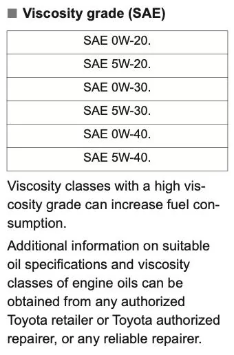

Really just depends on not only the dealer but if Toyota calls for checking what oil is in the engine if there is a failure. It does technically states in the owners manual that they only recommend 0w20 and 0w30, however, there are other oils that are approved in bmws owners manual running the same engine.
It really would be up to the manufacturer if they were to deny or approve a claim. It's always your call when changing something on the car since things can get denied over very stupid things and I've seen it happen before

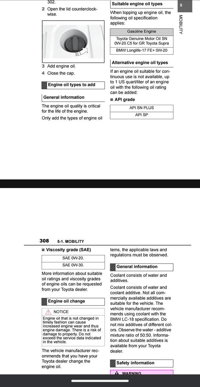

Per the manual, 0W-30 can only be used as a top up (up to 1 quart)

Warranty question. With the Toyota manual explicitly calling for LL-17FE 0W-20 oil, if one were to use an LL-01 or LL-04 oil and have engine failure what are the chances of a denied warranty claim?
Stock engine here and doing more and more track days in the Supra, but still trying to maintain that warranty :D
This question is nothing new. I’ve known a few dealership owners & brought this up before. I was told they usually (but not always) inspect oil level, condition and review your maintenance records. That’s it. The burden is on the manufacturer to prove the oil caused the problem. The only way they are sending out the oil is if they suspect improper oil caused the failure. As long as you meet the minimum specifications set by the manufacturer, you are good to go. What Bryan and many other are using, exceed the manufacturer’s specifications. It’d be hard to prove Motul (or similar brands) have shitty oil. And there’s no way they are wasting their time with that - if you’ve been changing it regularly. Yes 0W-40 is superior. But it ain’t cheap either.
