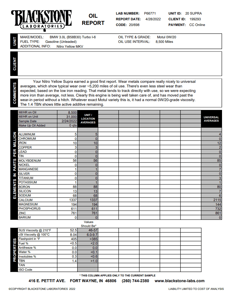

Fourth oil change, however (due to reasons...) this was the first analysis. Stated oil interval is 8500 but it was probably closer to 9000 - I forgot to write it down and was too lazy to dig up receipts to calculate exactly. I would definitely say the factory 10K period is absolute maximum possible and not for most... however, still a nominal amount of additive remains at just under 9K miles. Note that I'm using Motul 0w20 (LL17) not the Toyota GR formulation which might have more additives? In any case, I'm going to continue with 7500 as my target period since it's just my DD and no track use at all. 35K miles, zero oil consumption ever, and no problems outside alignment issues since purchase... nice!

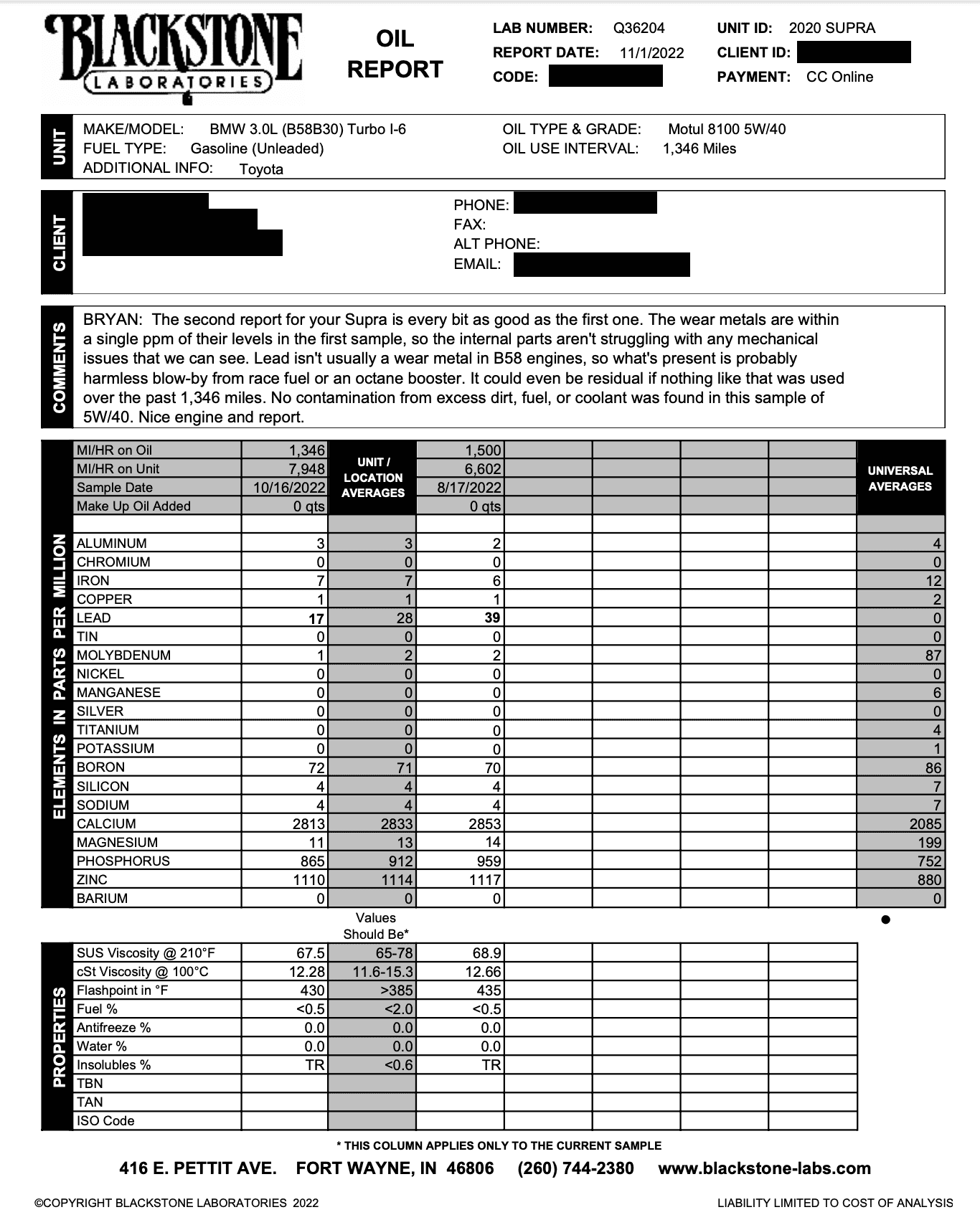

Forgot about this thread.
Here are my two reports, the latest being after 20 track days on the car. The car was on track since a little over 2,000 miles and probably has more track miles than street miles.
100% stock power wise down to the oem air filter.
I've been using Motul 8100 X-CESS GEN2 5W/40

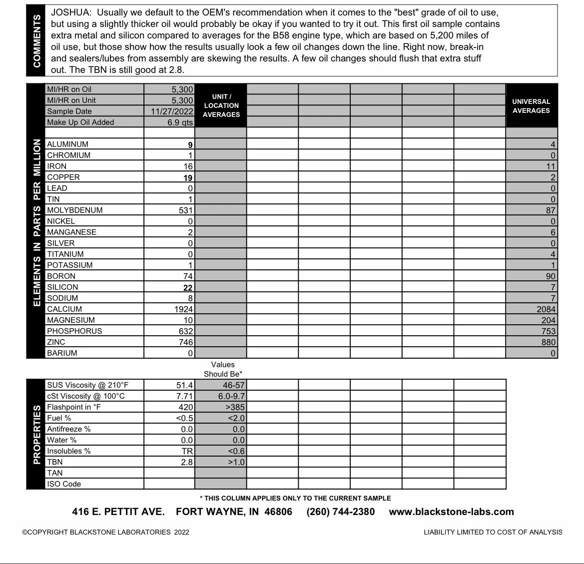

Car 1st oil change w/ original factory 0w-20 oil.
Actual mileage on oil was 5,600 miles.

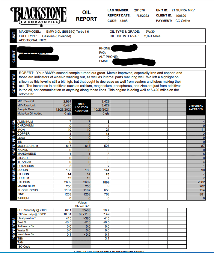

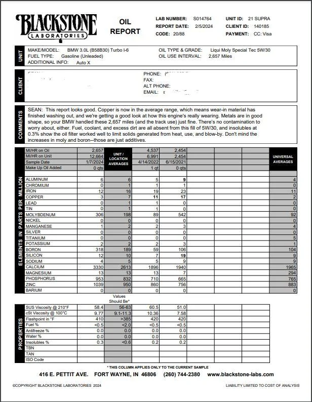

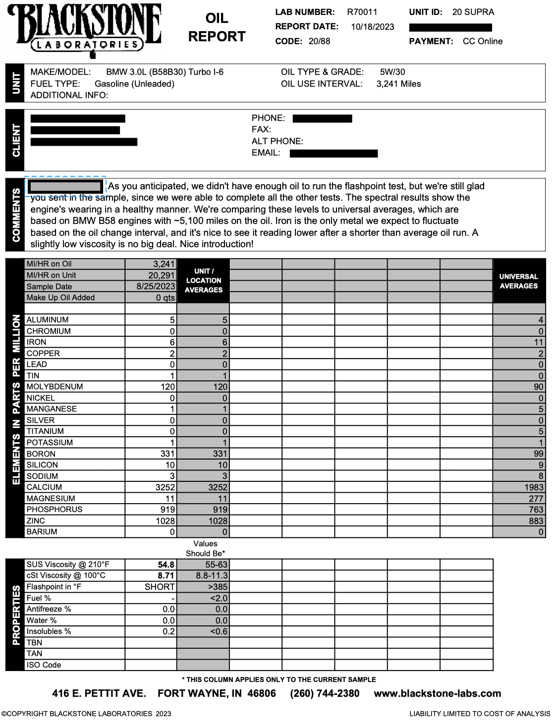

Adding my latest to the data pool. 3,200 Miles on the oil on a DP+93 tune car (with 20k miles) in FL. Early oil change only to get me back on regular, round number oil change/service intervals.
Tuned since 13.5k miles. Liqui Moly 5W-30 from 17k miles (i.e. this report).
No concerns!

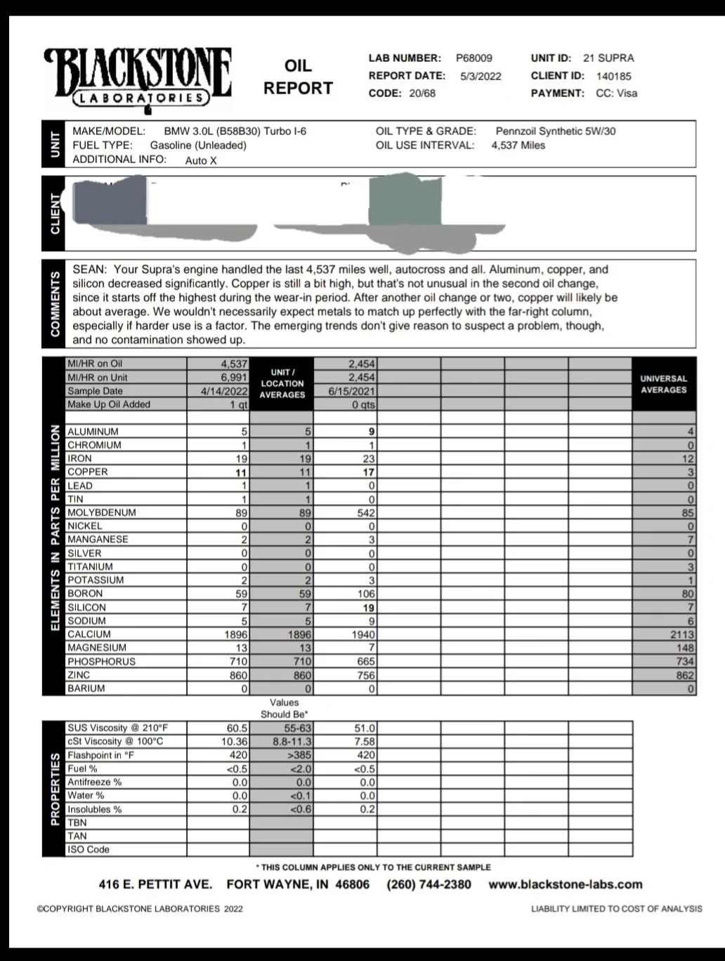

Here is my latest report. 4 big track days and 1 auto-x event on this sample.
