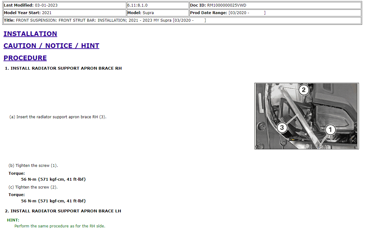

Anyone know what the stock bolt torque spec is? I briefly checked before removing them and the shock tower bolts clicked at 70 ft/lbs, so they were tighter than that. That seems like a lot of torque for those bolts
41 ft lbs is the factory spec
