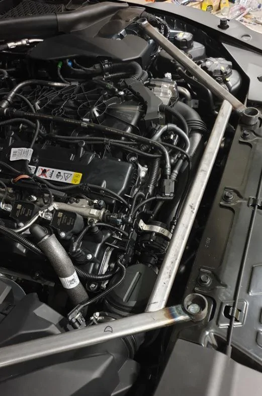

I'd say so yeah, but I made them both separately and did the initial cutting/welding with it all on the car. So its not like I just made one and then duplicated it. So there is the chance they could be slightly different, but the angles and distances etc that I did measure, seemed to be the same.

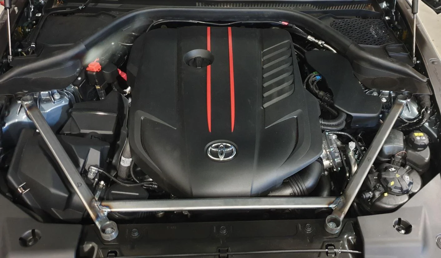

Is there enough space to weld in a cross brace closer to the strut towers granted that the engine cover is removed?

I'm going to look into this when I make the next one but yeah I think there would be just about enough room. Having said this, I spoke to my engineering friend and he said its probably more useful at the front because at the rear you've already got the whole firewall connecting from side to side not far away.

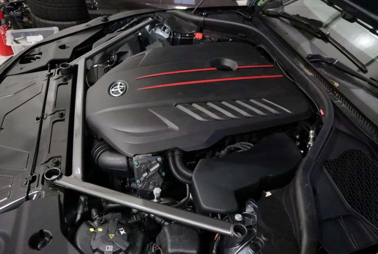

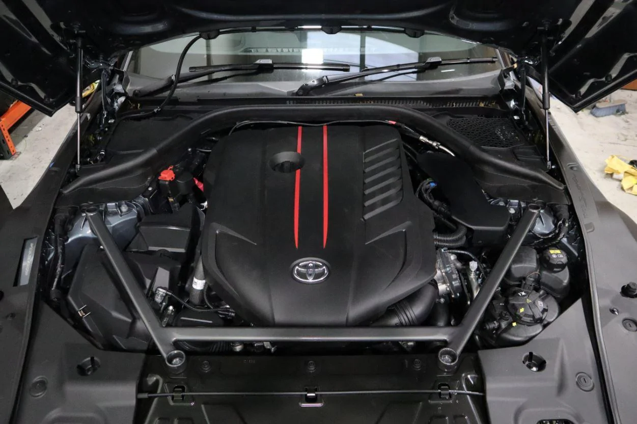

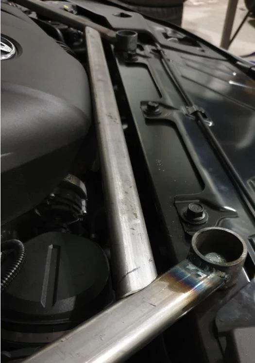

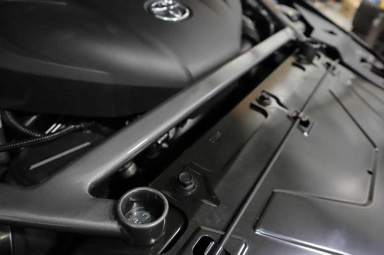

Got it back from powder coating today so I guess this is finished now. As you can see I smoothed over the welds on the top side of the cross beam cos they were so ugly lol probably loses a little strength but this first one was more of a practice piece anyway and I'll use it as a base to make an improved version from some time in the future.
Once I've made a version I'm happy with and I've run it on my car for a while, I'll see if anyone else wants me to make one for them (probably be like half the price of the Cusco one)

A great finished product. The strut brace looks extremely good.
Great choice of color. Very well done for the time and effort put into it. Thanks for sharing the end result.
Kindly share the difference in handling once you get some miles on your car with the strut brace.

Wow this is awesome. If you ever decide to make a few for sale, please let me know!!

That brace looks oem!! amazing craftsmenship would love to see your next product development
