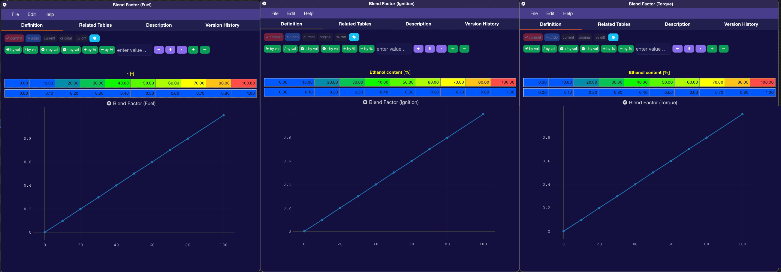

Multimap is ACN91, 91, 93 and stock. You can switch between all those from the steering wheel.
All four of those map slots have flex fuel enabled. If you run flexfuel it flexes to whatever Ethanol you have in there, if you have a flex fuel sensor installed. Timing, torque targets, boost, fueling all scale accordingly. You could even run the stock map slot and it would interpolate to higher timing, torque targets, boost and fueling as you put more ethanol in. Flex fuel does not "Switch" to other map slots, it interpolates between whatever map slot you have selected and the full ethanol map slot.
It uses these gradients, or whatever custom gradients you make. You can make it non linear if your tuner wishes.
They also offer individual E30 and E50 maps for people without flex fuel sensors installed.

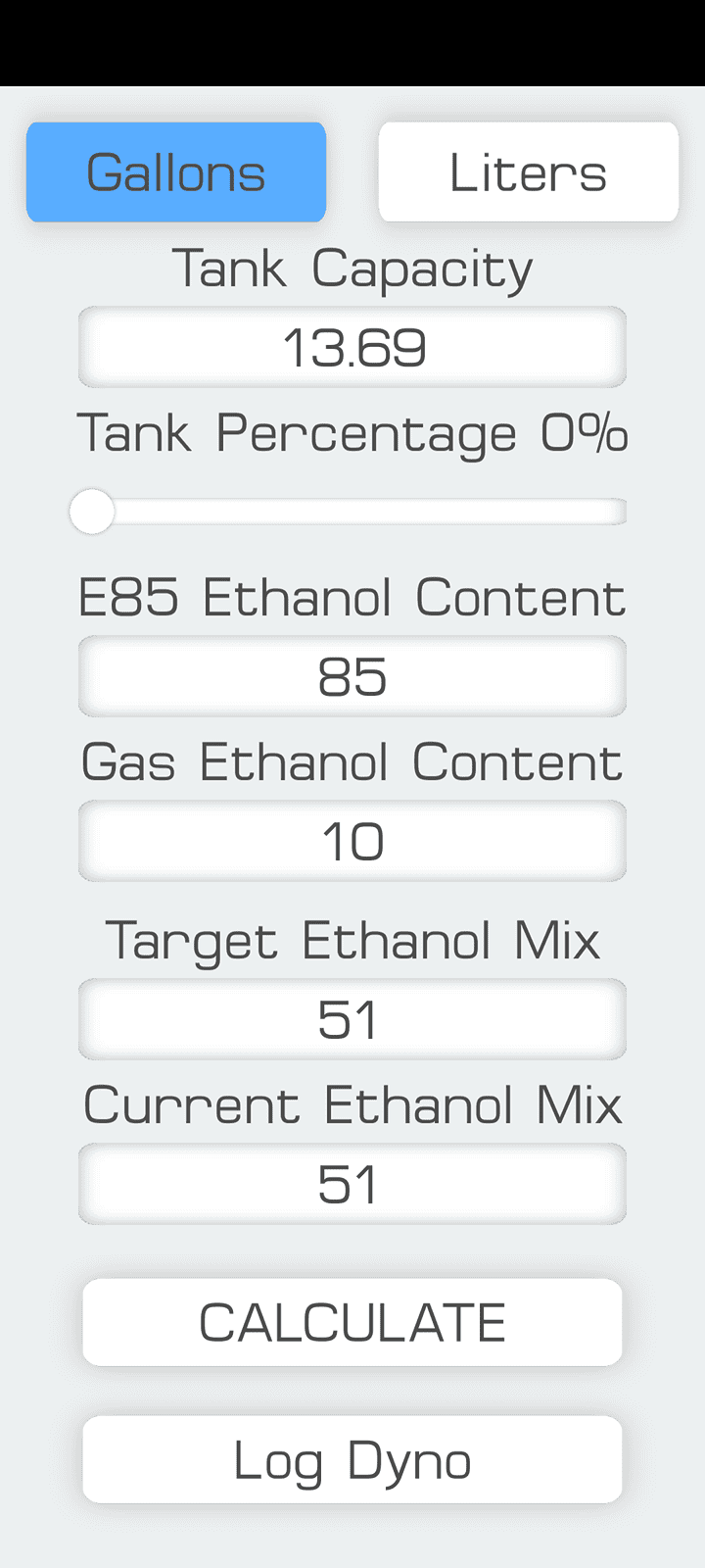

hey newbie here, I just bought my first flexfuel sensor I will be installing later on this week. can anyone provide a step by step on fueling for e50 on a stage 2 93 ots map. for example do I still need to use a tester before fueling, or is there a certain amount of gallons of e85 I should pump with my 93, any other tips that you have would be greatly appreciated
- Get yourself a calculator app (I use 'e85 blend)
- learn how to get into the "secret" menu in your cluster which will show you the amount of fuel left in your tank
- do the math using the calc app and it will tell you how many gallons of e85 to put in and how many of 93 to reach E50

I’m assuming I wont have to test the E since I have the flex fuel sensor ? Thanks for the help btw!
If you are stock fuel system - e50 is as high as we should go. So as long as you put in that you are targeting e50 in the calculator app.. you shouldn't have to test it, as you will only reach e50 or less. The reason to test would be if your local pump is putting out less than e85 and you keep winding up under e50. Mine luckily is always putting out e85 so i always hit e50 using the calculator.
I hear from a lot of people though that their station is more like e70 sometimes.. so if your pump is putting out something other than e85 you might want to test it so you know what to set the E85 ethanol content setting to in the calculator so that it will tell you the proper mix to put in. I rolled the dice on my local station and lucked out :)
