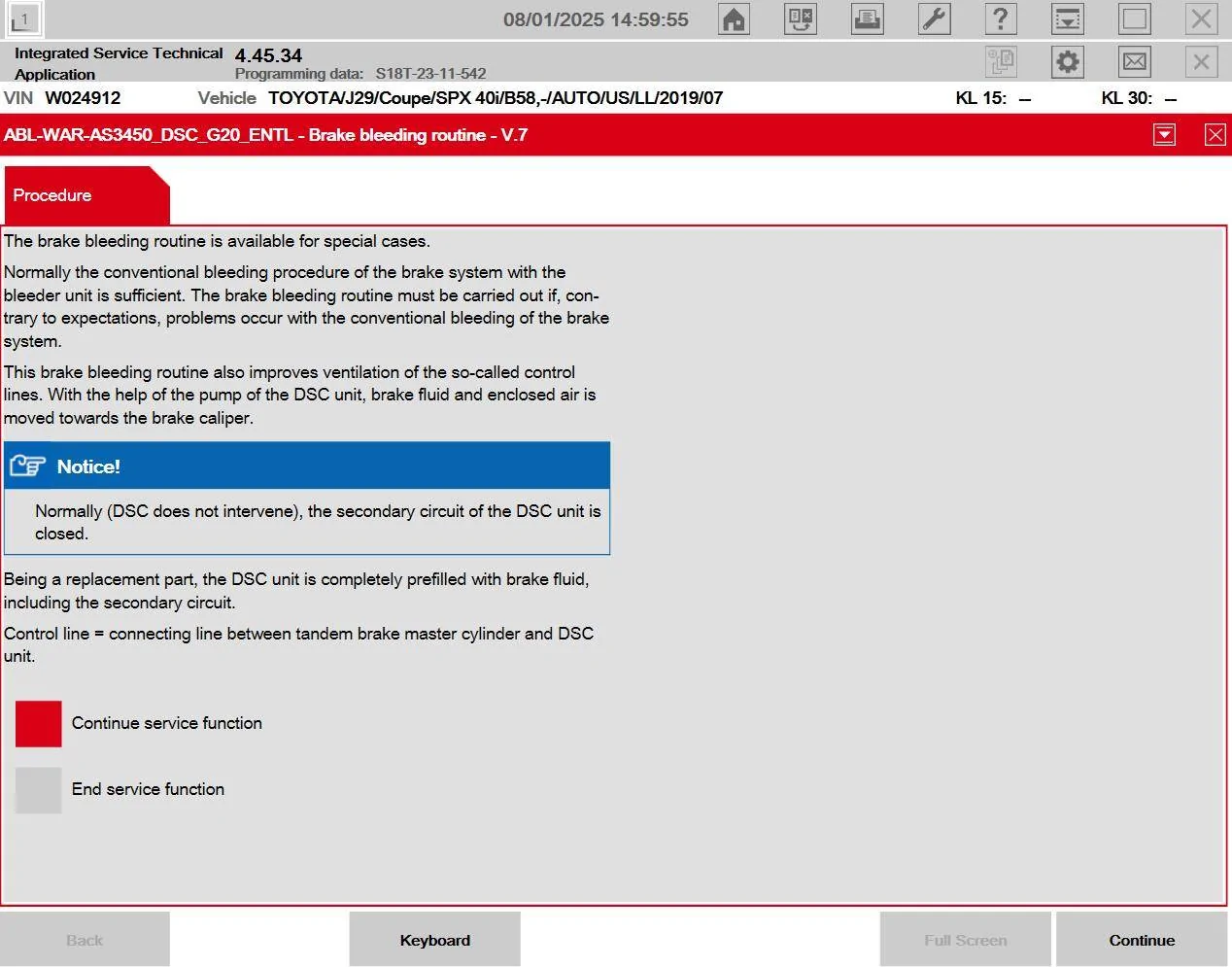

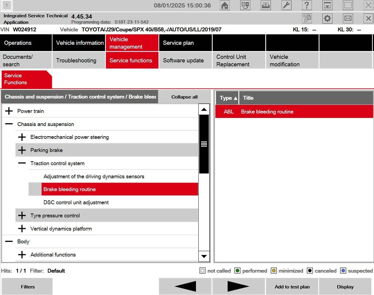

It did. I'm not 100% sure it was necessary even in my case, but at least I know for sure we're good now. Like I had mentioned, I swapped to stainless lines and the pedal was going 80% to the floor before engaging the brakes, which I've never had happen before using my power bleeder on any of my cars, so I freaked out a little bit. I didn't feel comfortable driving it at all, let alone trying to engage ABS out on the road by stomping the brakes. After doing another bleed right before starting the ISTA procedure, I saw a ton of bubbles come out finally, so honestly that probably took care of most of it. But I still went through the procedure for good measure.
All that said, like everyone has mentioned several times, it's highly unlikely you actually need to do the procedure unless you really messed up and ran the reservoir dry, I just wasn't sure if something funky happened when I replaced my lines. I also want to do a bunch of updates so I wanted to learn how to get ISTA going.

Recently swapped to a BBK and also needed ISTA to flush the ABS solenoids. Brakes were mushy crap without it. $70 license + power bleeder required. Pressurize power bleeder to ~15 PSI.

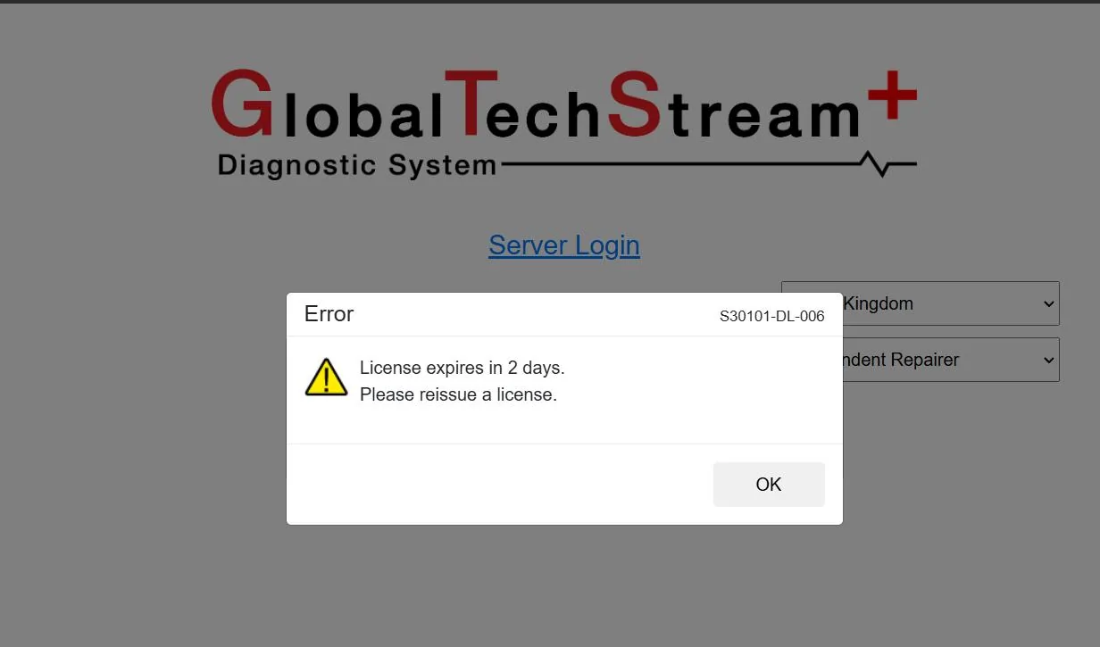

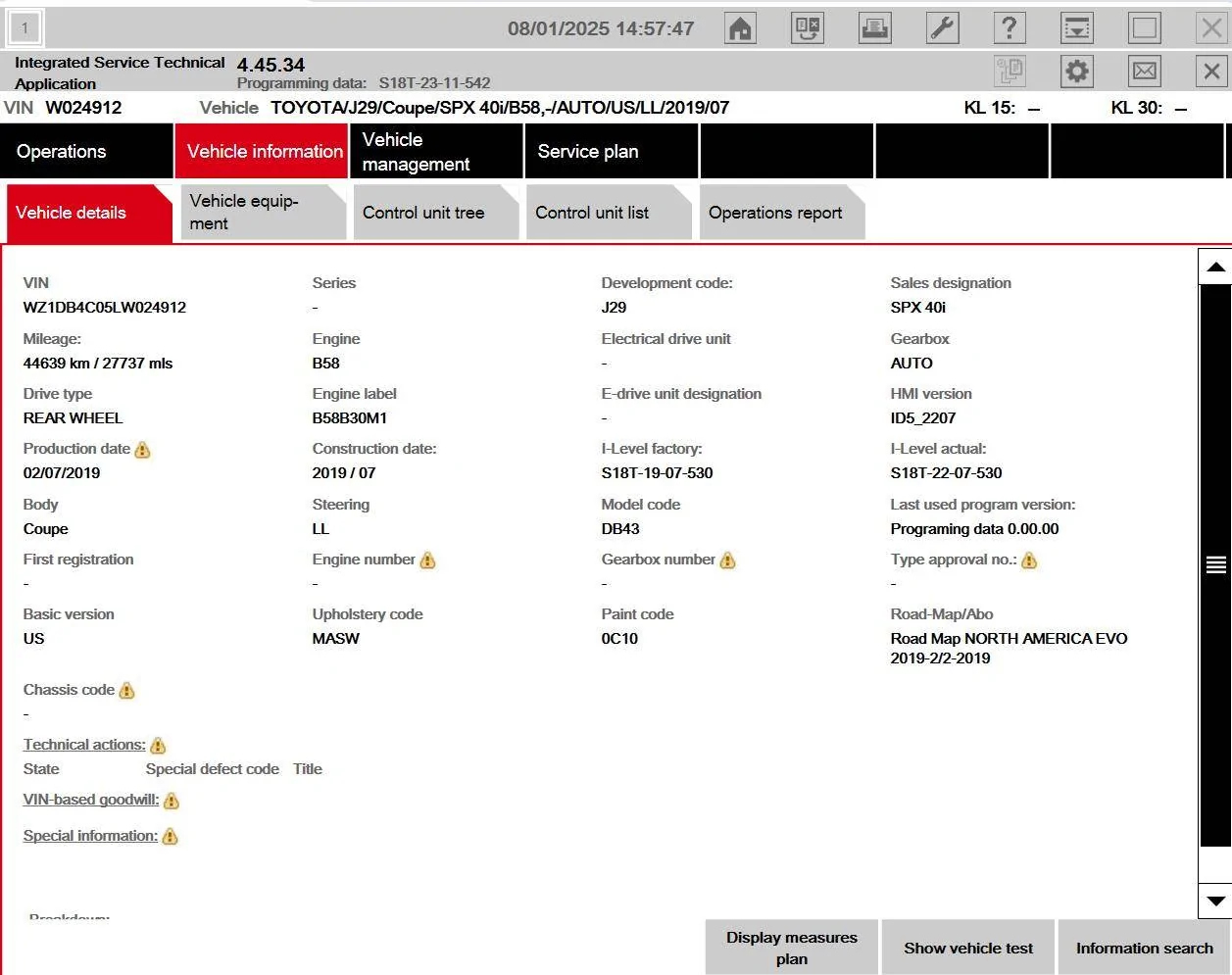

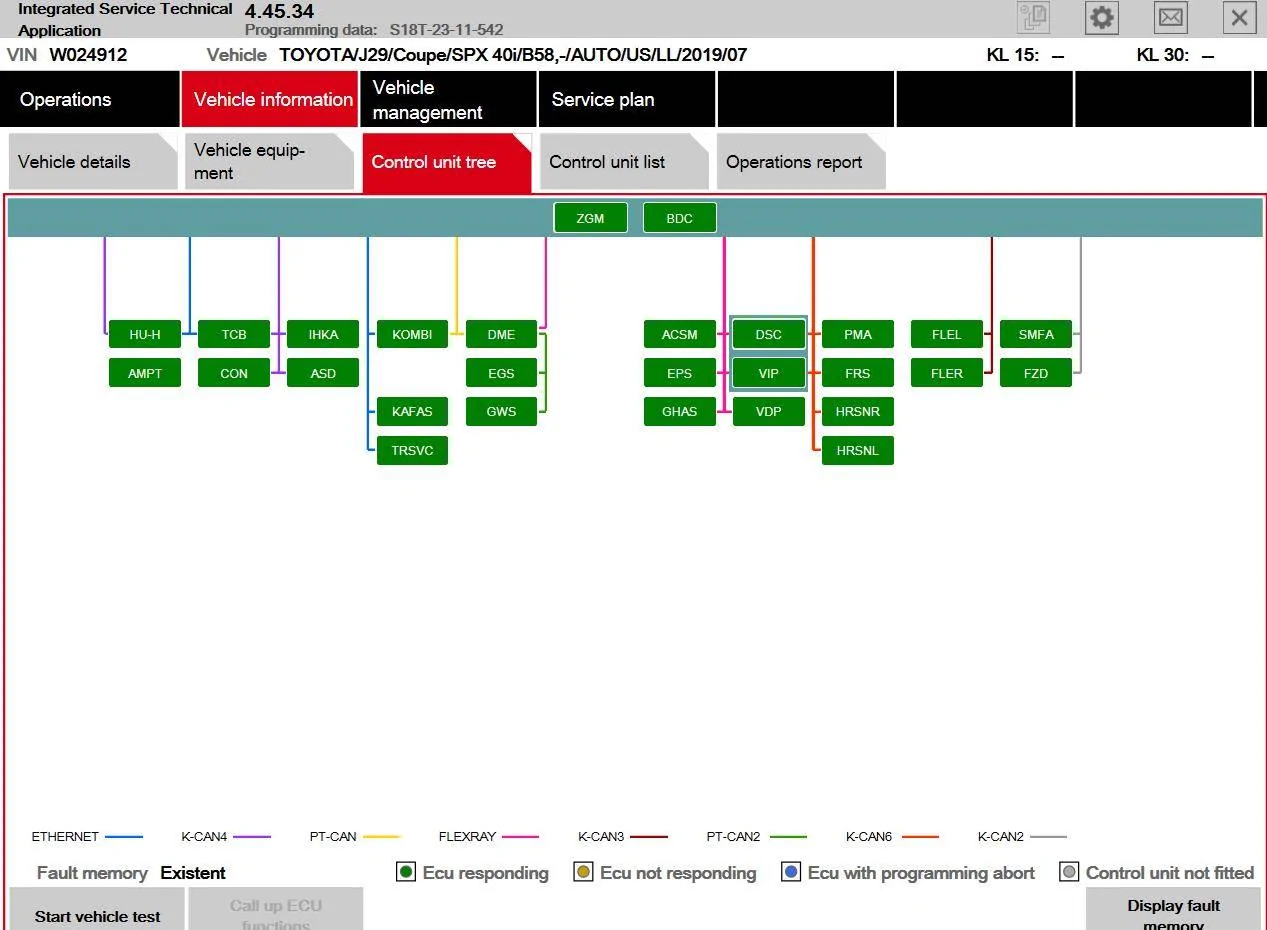

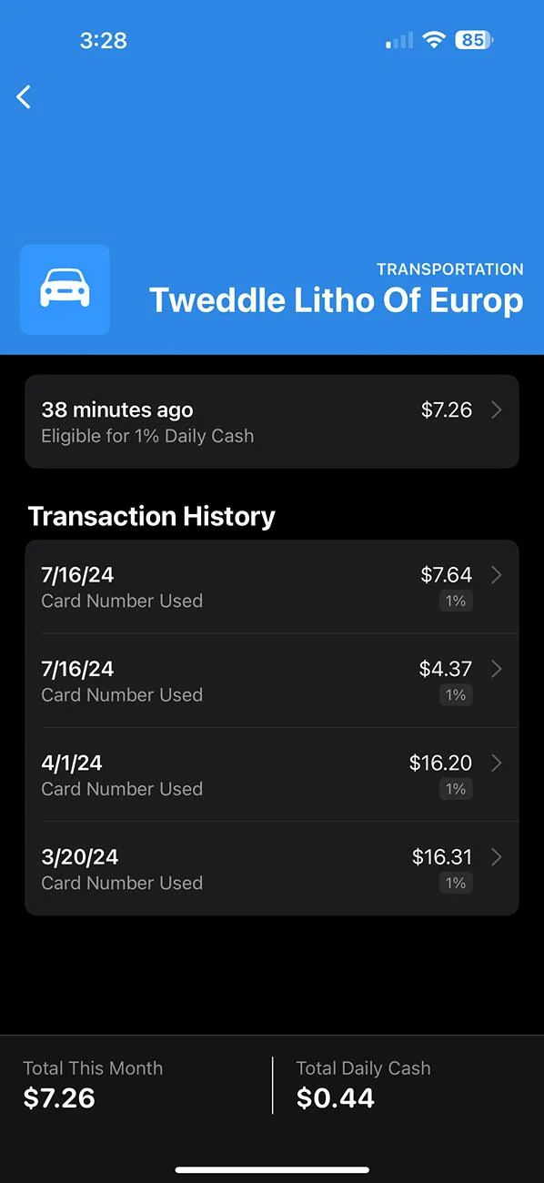

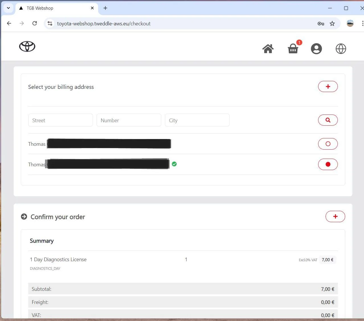

My wife needed a laptop so i pulled out the laptop I bought just for ISTA and decided to try it out again just to make sure. Cost 7 euro ($7.26 at today's exchange rate) for the license then went right in. Screen shots are the charge on my apple card the March 20th and April 1st were 7 day license, the 2 for July were me adding the wrong item to cart the $4.37 was wrong and had to buy the 1 day license at $7.64. The receipt to show what I bought, 1 Day Diagnostics license. Screen shot from GTS showing my license (not sure why it says license expires in 2 days). Screen shot showing connected to my car and then screen shots showing me getting to the brake bleed process.
Not sure what Toyota ISTA the guy DL on my laptop but for me luckily its roughly $7 to perform my brake bleeding.
I did change the brake pads and bled the brakes on a friend's car and after bleeding even using the pressure bleeder the pedal went to the floor. I thought I was going to have to bleed the brakes with ISTA, but we tried it with the car running and that worked perfect. So, if anyone is having issues bleeding brakes and the car is off. Try doing it with the car running, because 4 cycles with a pressure bleeder and the pedal just sank. 1 cycle with car on and it worked great.

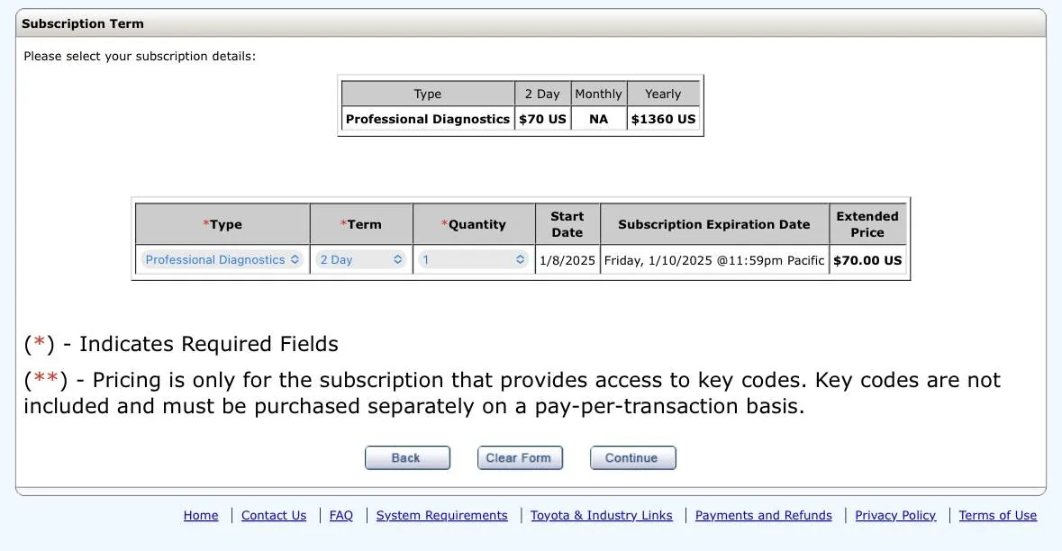

That’s pretty interesting. The only difference is that you’re in Europe and on the .eu website. There wasn’t a one day option for me for one thing, the minimum is a 2 day “Professional Diagnostics” license which costs $70.
Hell even the “Standard” license cost $25 for 2 days, but that won’t get you into ISTA.
8,753
17,161
I did mine all through the EU site and I live in NY. :) I think the guy you quoted lives in Las Vegas.

Yeah im In Vegas, I paid for a service of some guy in Africa from diag-tools and he worked on it over 15hours. I paid for the US TIS 70$ but that didn’t help us back then. Nothing he could do would get any of the US versions to work. Got a EU version and that worked. Idk what he did, or what he DL on that laptop,( I bought it and left it 100% free from my normal computer because I didn’t know if I could trust someone overseas on a PC that has my info and work/business info on it) But he was professional and everything worked in the end.
maybe someone that knows about this stuff can figure it out, but I have a bookmark to take me straight to the EU site, pay my 7 euro, then click on the GTS program log in after I pay my license, then click the ITSA program. All I’ve done really is the brake bleed, look at info on the car, I don’t wanna dick around and start something that may update my DME locking it and having to get it bench unlocked again or doing something else And bricking the car completely.
