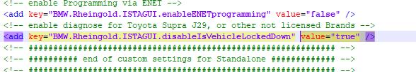

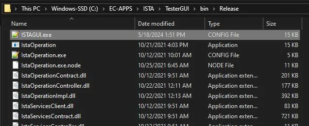

Now if you do have the regular ISTA already or find it online to download and have the problem that you cannot get the supra to connect to ISTA, this is what you do. Go to where your ISTA is downloaded and follow this path. and edit the ISTAGUI.exe with any texteditor
Search for this string of code
the value, at least for me was set to false by default, change it to true and reset, the bmw ISTA should now be able to read the supra through enet cable.
