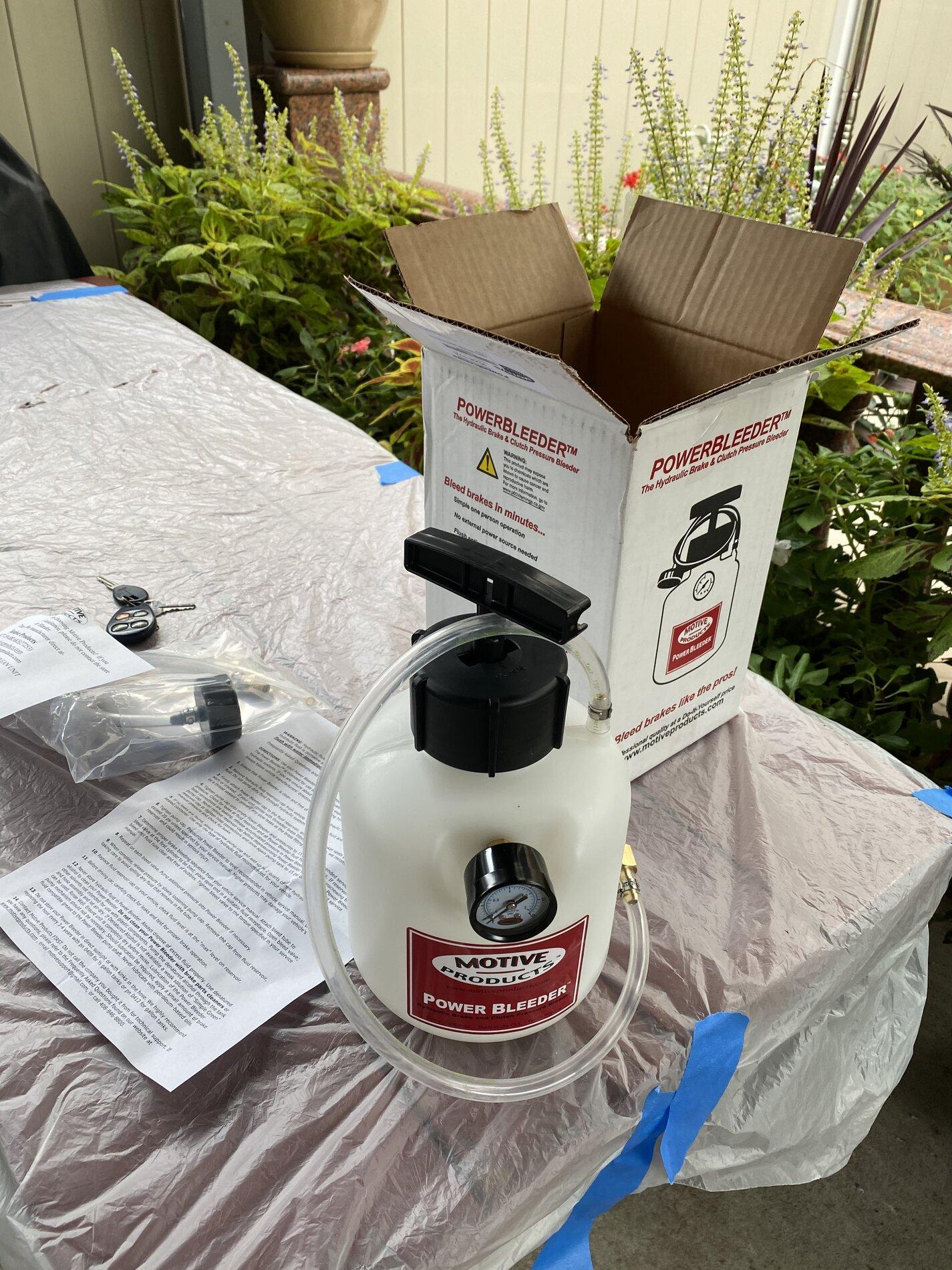

Is it safe to say this can be avoided by using a power bleeder? Or would the ABS still need to be activated a few times to get in cleared?

Has anyone used a power bleeder? What pattern should be followed?
Same as any car. Always start with the wheel furthest away from the master cylinder and work towards it. So pass rear, driver rear, pass front, then driver front
