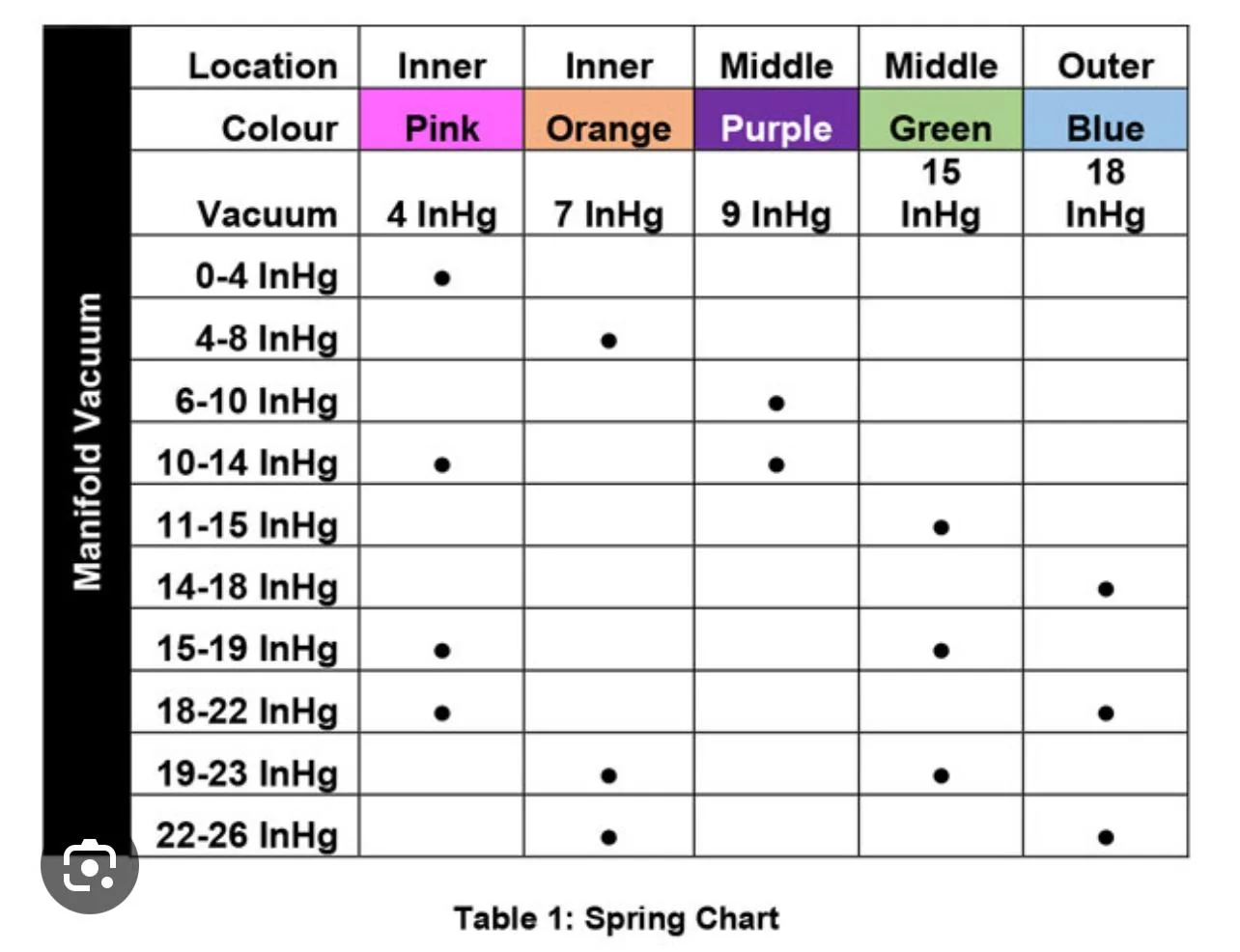

Believe this is the RacePort spring chart
Wondering ? if the Pink one should be 1-4 InHg (vs. 0-4 InHg) to match your reading and so it doesn’t open up on anything less than 1 InHg? And if this is the case, looks like there aren’t any springs available in that range.

RacePort Change Springs:

I noticed this after the install, anything under ~30% throttle the bov is cracked open. It was mentioned earlier in this thread it has the pink spring installed which is the softest spring. B58 produces very little vacuum at idle bc of the valvetronic, so soft spring makes sense. However it is possible that during driving as the valvetronic value changes so does the amount of vacuum produced which is higher than the spring rated at.
I’m gonna log vacuum at part throttle and after lifting under full boost to see if this is true. Spring options listed below if a stiffer spring is needed.
TurboSmart Spring kit:
• Pink Spring (Inner -4 InHg)
• Purple Spring (Outer -10 InHg)
• Orange Spring (Inner -8 InHg)
They also offer a blue spring (18 InHg) separately.

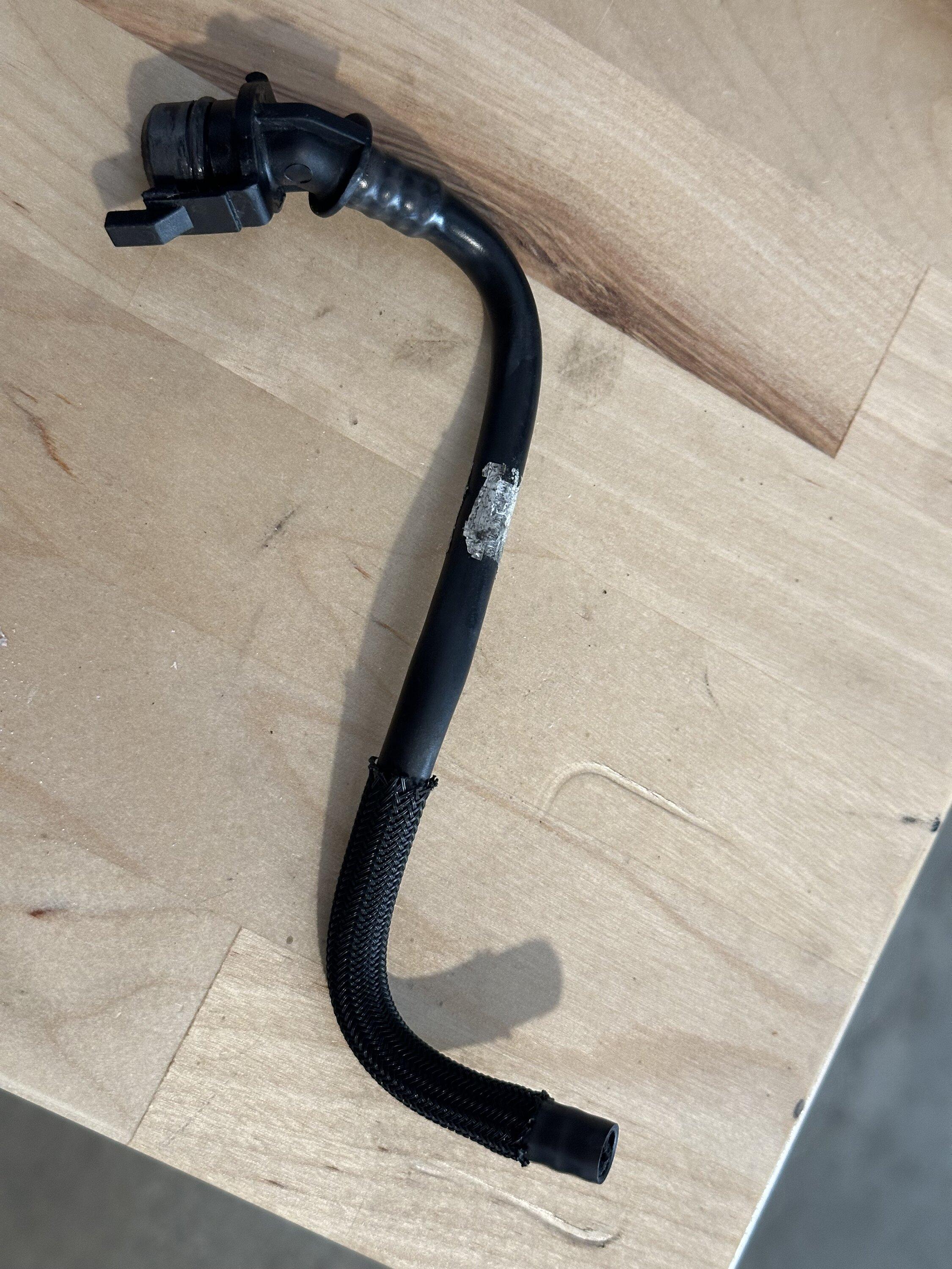

This is where my head is at as well. A stiffer spring may be what’s needed to allow the BOV to operate correctly and not open at part throttle, but I’m considering just sending it back and going back to my old setup. On my M340i, fitment isn’t the greatest. Everything, including the electrical connectors, was a very tight fit, and I’m not able to connect that line that connects to the right side of the turbo inlet pipe:
(Not sure what exactly it’s for, I just know it’s already a pain in the ass, and with this charge pipe it was impossible to even reach the spot it connects to, let alone actually connect it. I’ve tried it with the stock one, CTS, and Dinan. Ended up snapping it off trying to connect it, so if anyone has the part number so I can order another one, that would be awesome.

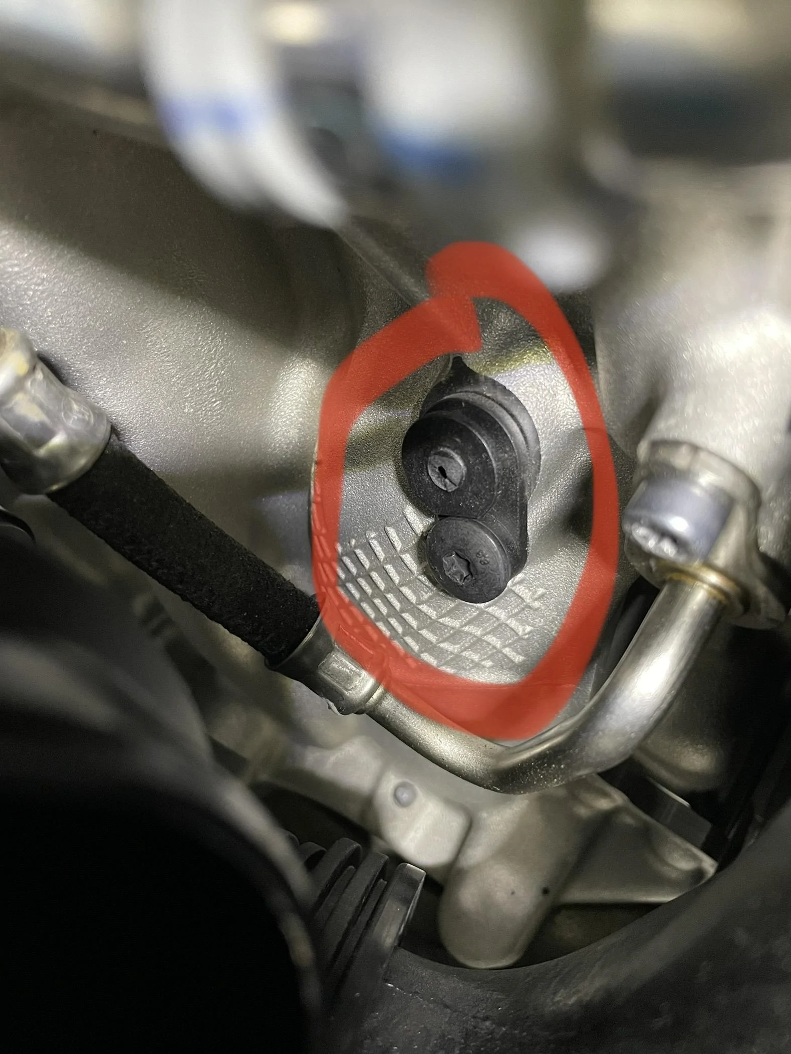

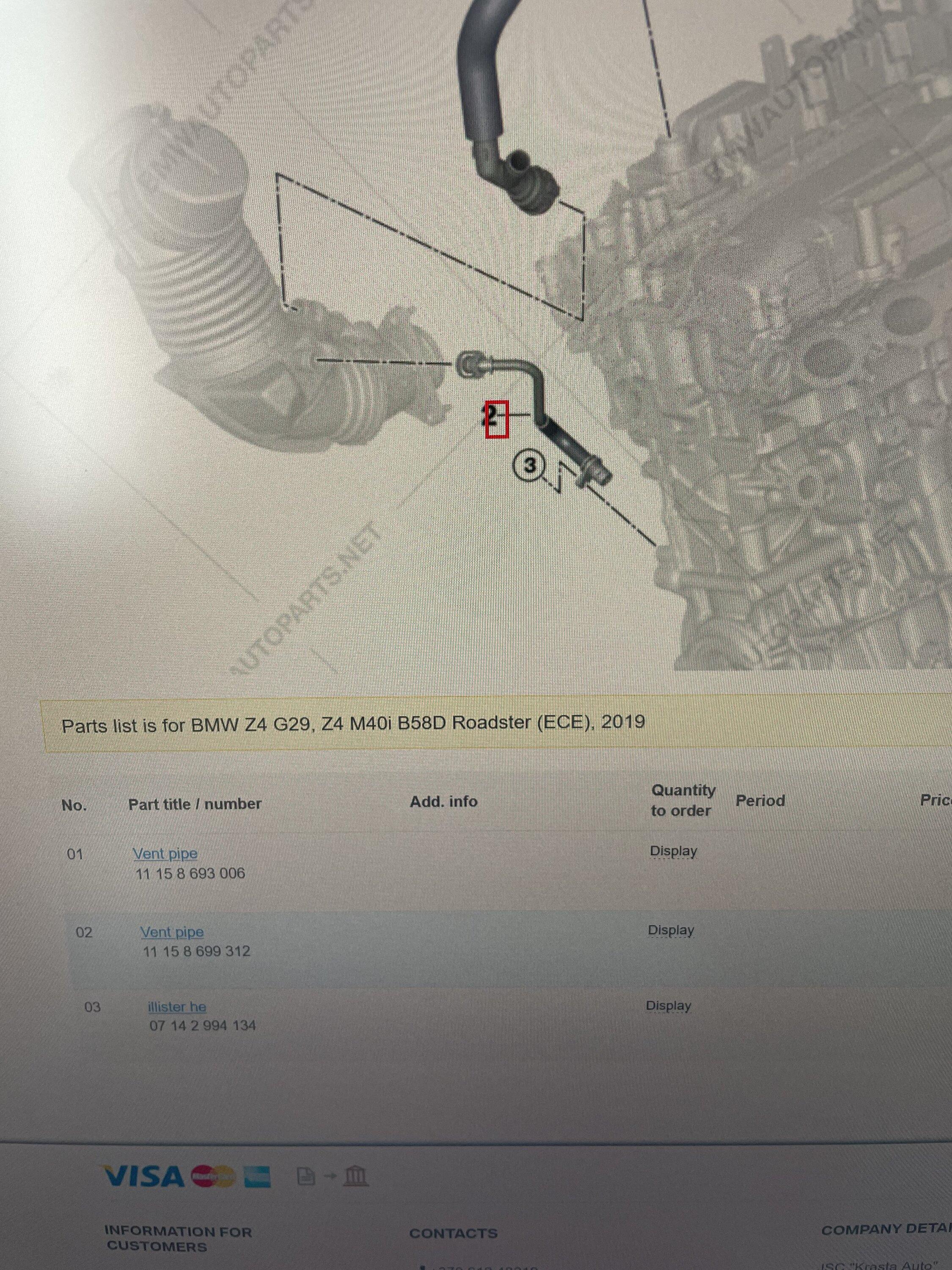

That is the vent pipe. It’s really stiff and easy to break..
I attach the part number and the place on the block where it belongs .

Would have to agree that on partial throttle BOV is opening and car does have a tiny bit of lag when your barely on the throttle. We're currently using Pink spring which is rated for 0-4 InHg, think we need to run something like 1-4 InHg or a 2-4 InHg so BOV doesn't open up on partial throttle. However looking a their Spring Chart, I'm not seeing any other Spring that would work based on @GreyMadder 's mechanical/digital boost reading (1-4 InHg) for that vacuum line.
