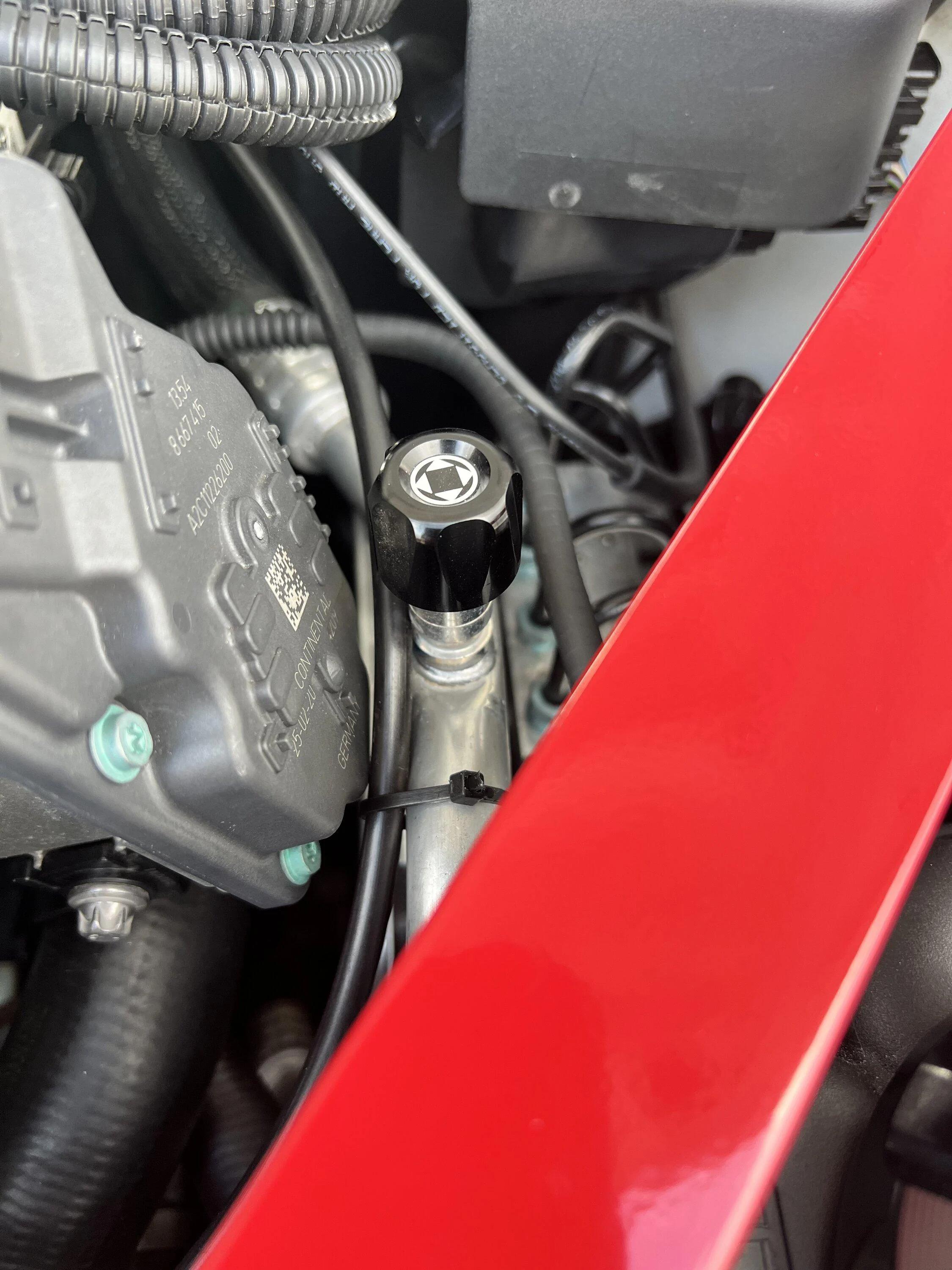

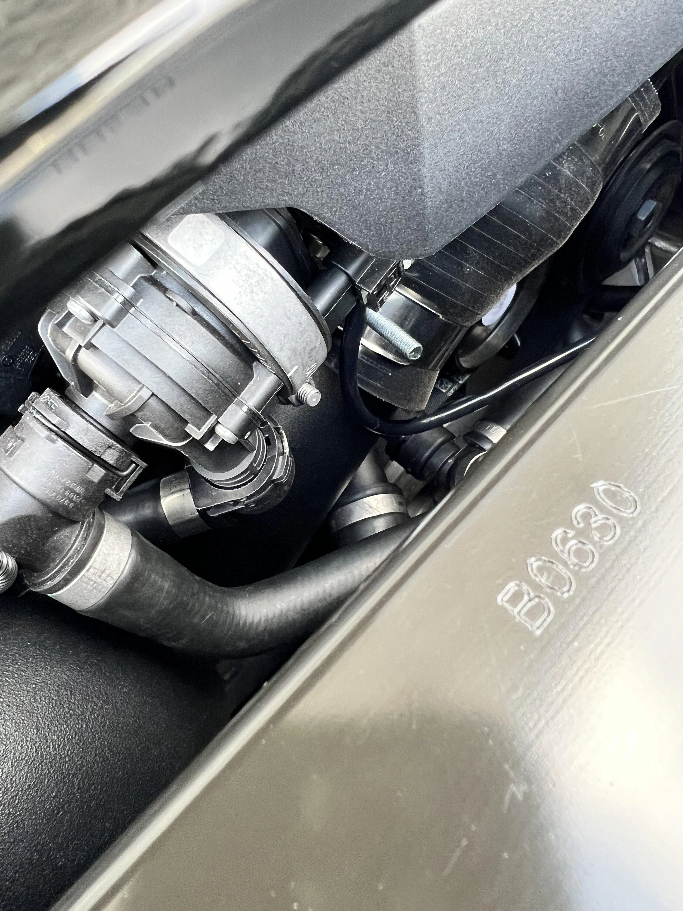

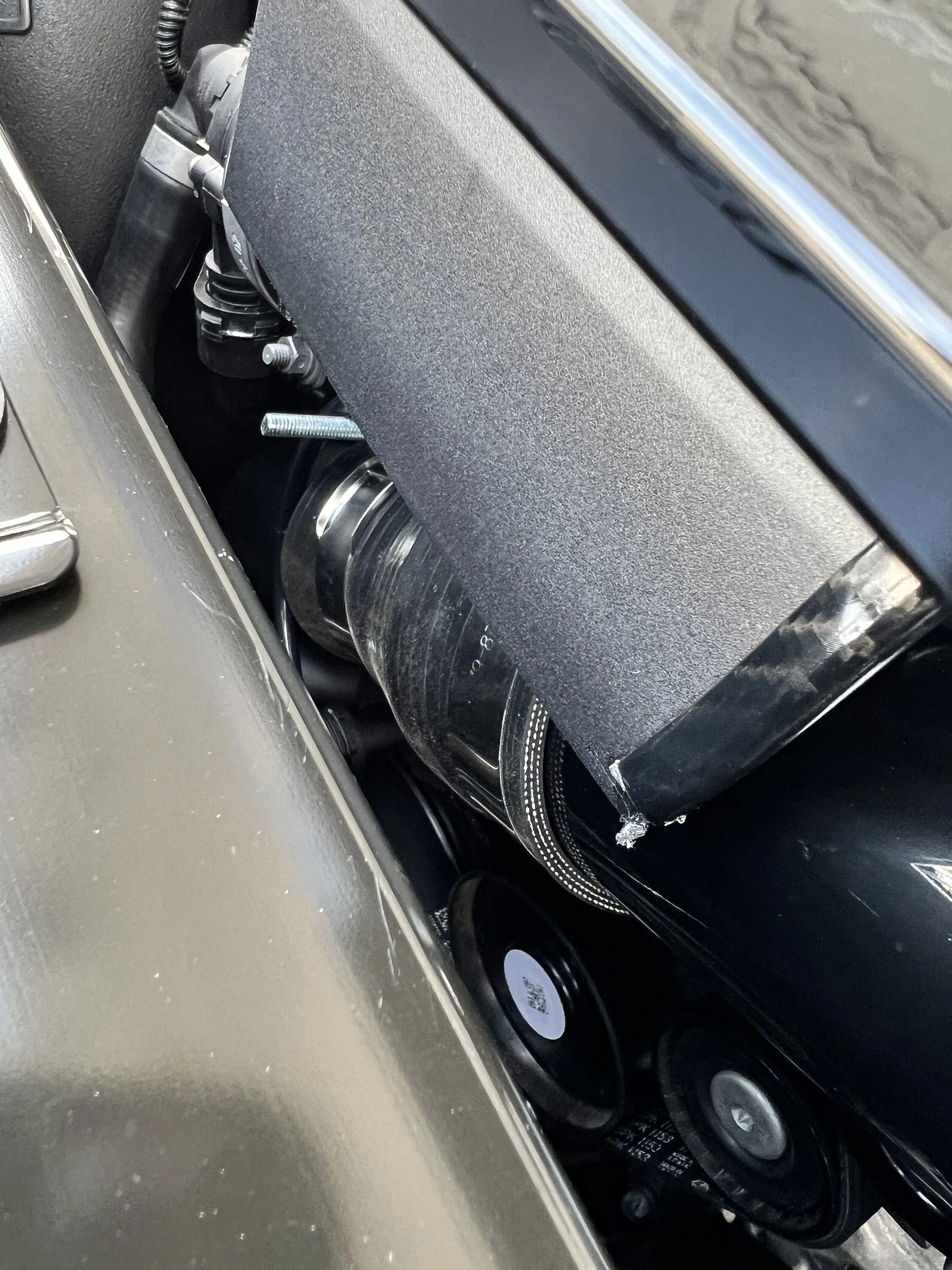

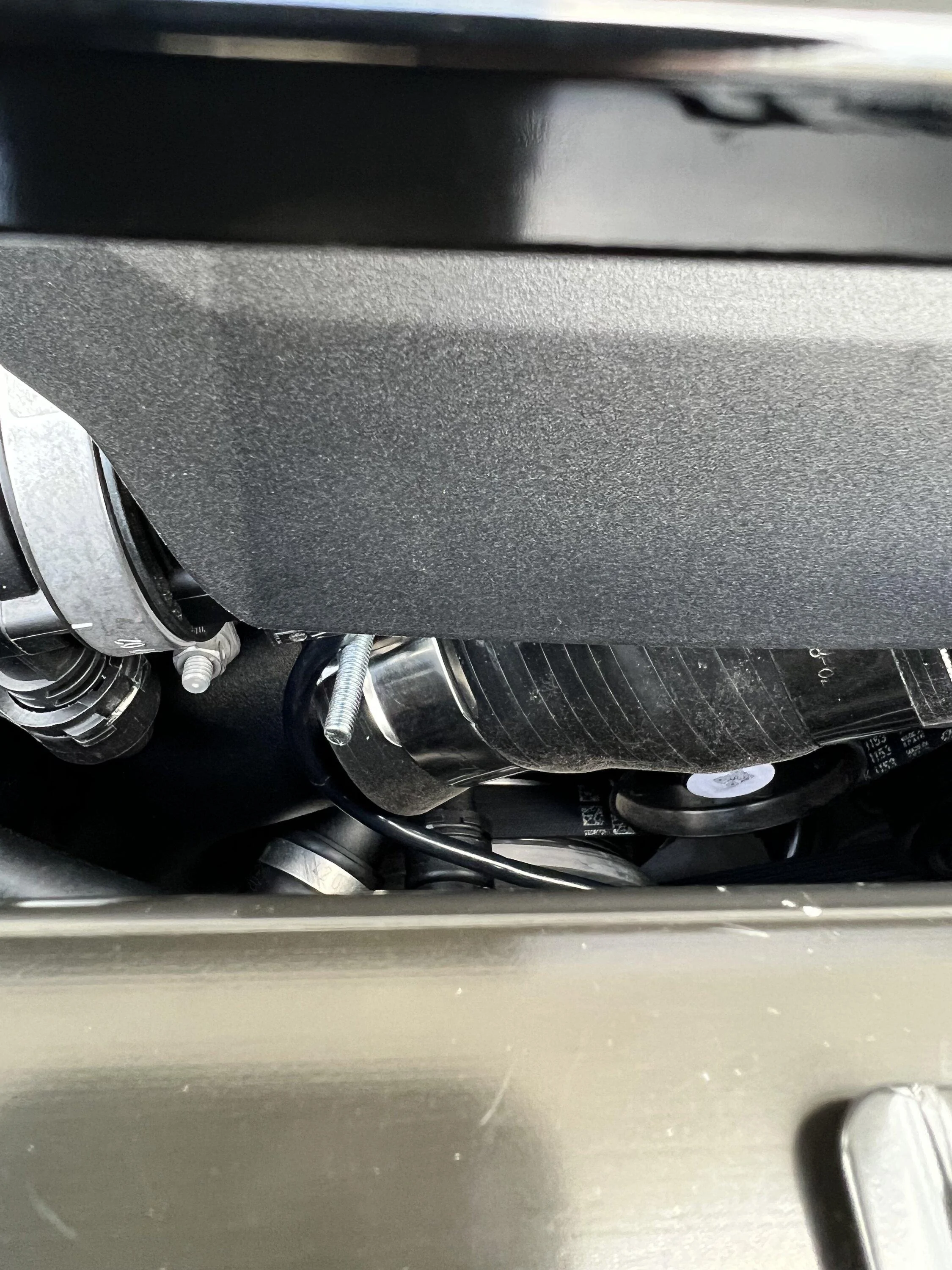

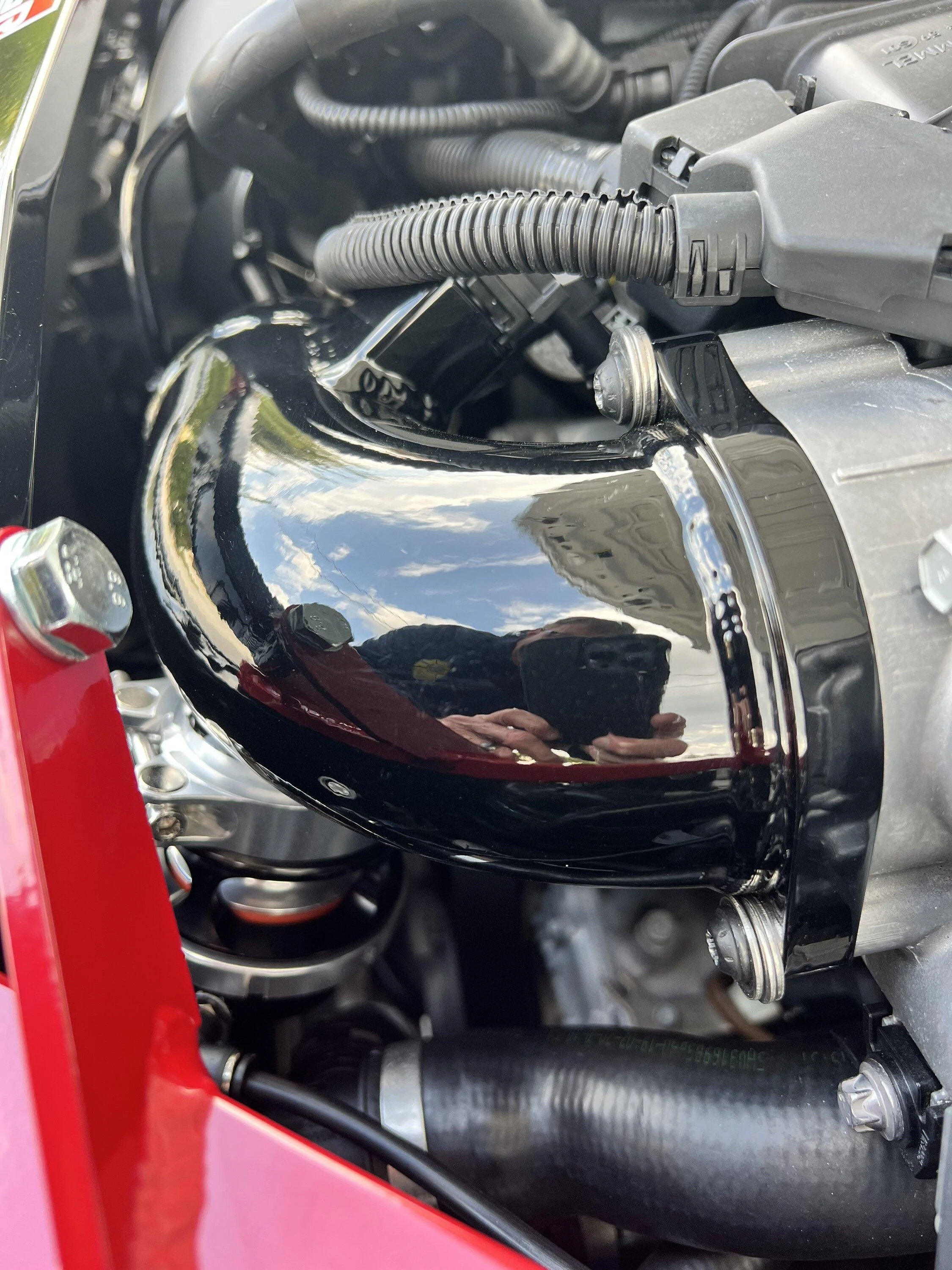

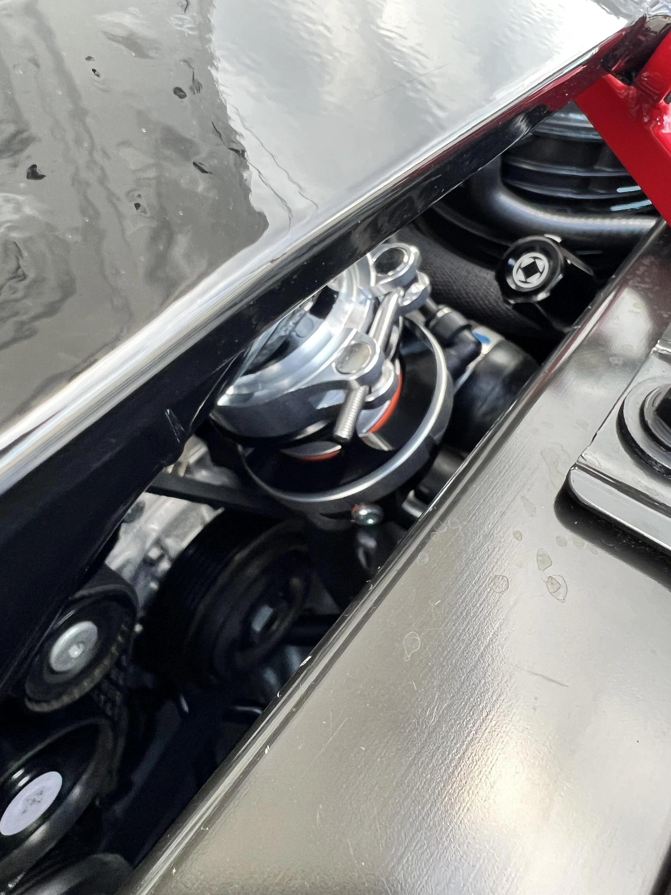

The line going across the bottom clamp is for my meth injection. You can’t see it from any of the photos. In case anyone was wondering. It’s to keep it out of the way from ever touching the fan or shroud.

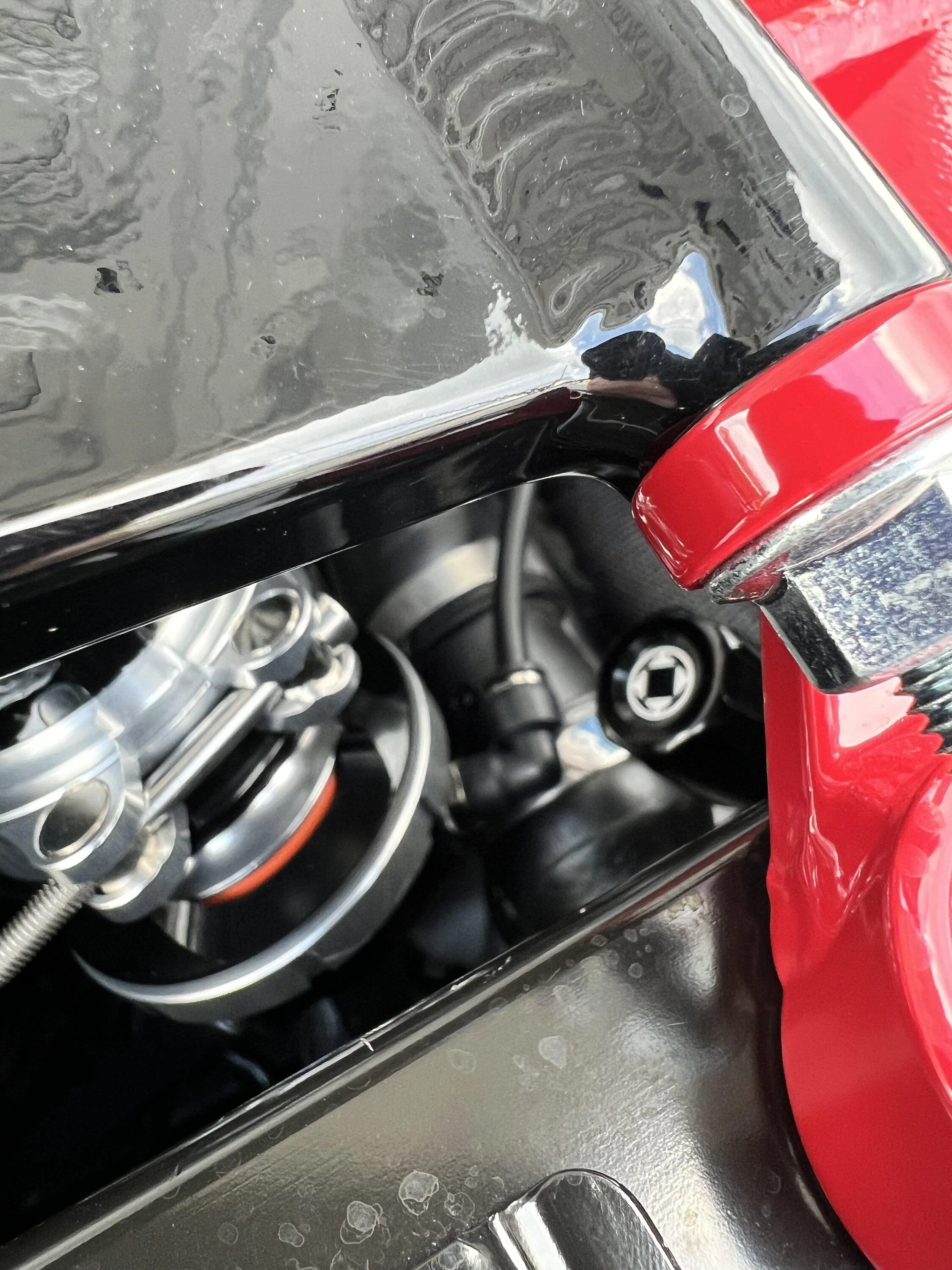

Pure your request. Hard to see it but it’s the bottom section of the FTP. Notice it’s not shiny. It’s flat black. The coupling is one from Visconti since I am running port injection.
Thanks for the photos. I'm going to install mine next week and try to keep the bottom half of my ftp installed.
