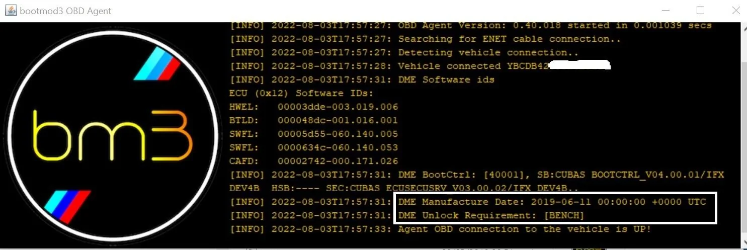

yep ... even though its a 2019 ecu its locked :-(

Wow! Mine's 10/24/2019. I assumed it would be unlocked.
8,586
16,851
guys, BENCH UNLOCK, no big deal. :)
Not the same thing as the 21+ where you have to send it into the Ether and spend a bunch of money and have to deal with a certain companies AMAZING customer service ;)
