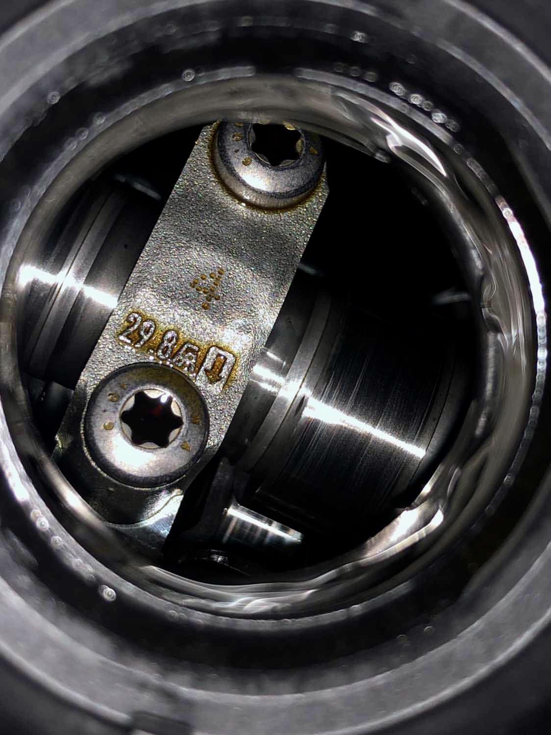

Was curious to see what I could see through the oil filler cap. I put my phone on the engine cover and snapped a photo. I would appreciate anyone willing to snap and share.
I noticed wavy lines on the camshaft. I know there are engine experts here but also this is fairly easy to photograph. :)
I have 2,400 miles on the my 2021.

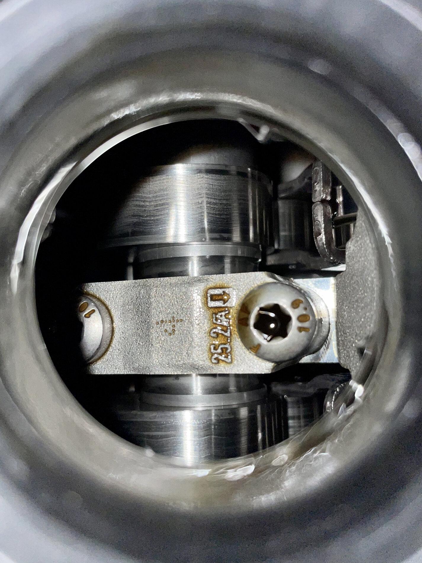

A friend sent me a photo of his 2021 with just over 4,000 miles.
The wear looks different (more of what I'm used to seeing on engine rebuilds I watch), and also one of the part numbers is different 25.2 vs. 29.8.

Thanks! Frankly I'm not concerned, more fascinated. But I'd be interested if it's something I should be concerned about! Looking forward to your results. I did use a pic just to lightly run over the surface of the waves. I couldn't feel anything till I hit the borders of the wear path.

I think the wavy lines are part of the process when they grind the cams to shape. If it was a wear pattern they would look more like helixes in there. They should wear away as seen on your friends car with the 4000 miles.

Used a fine metal pick to run over it. couldn't feel a thing till the edges of the lobes so i think it's fine.

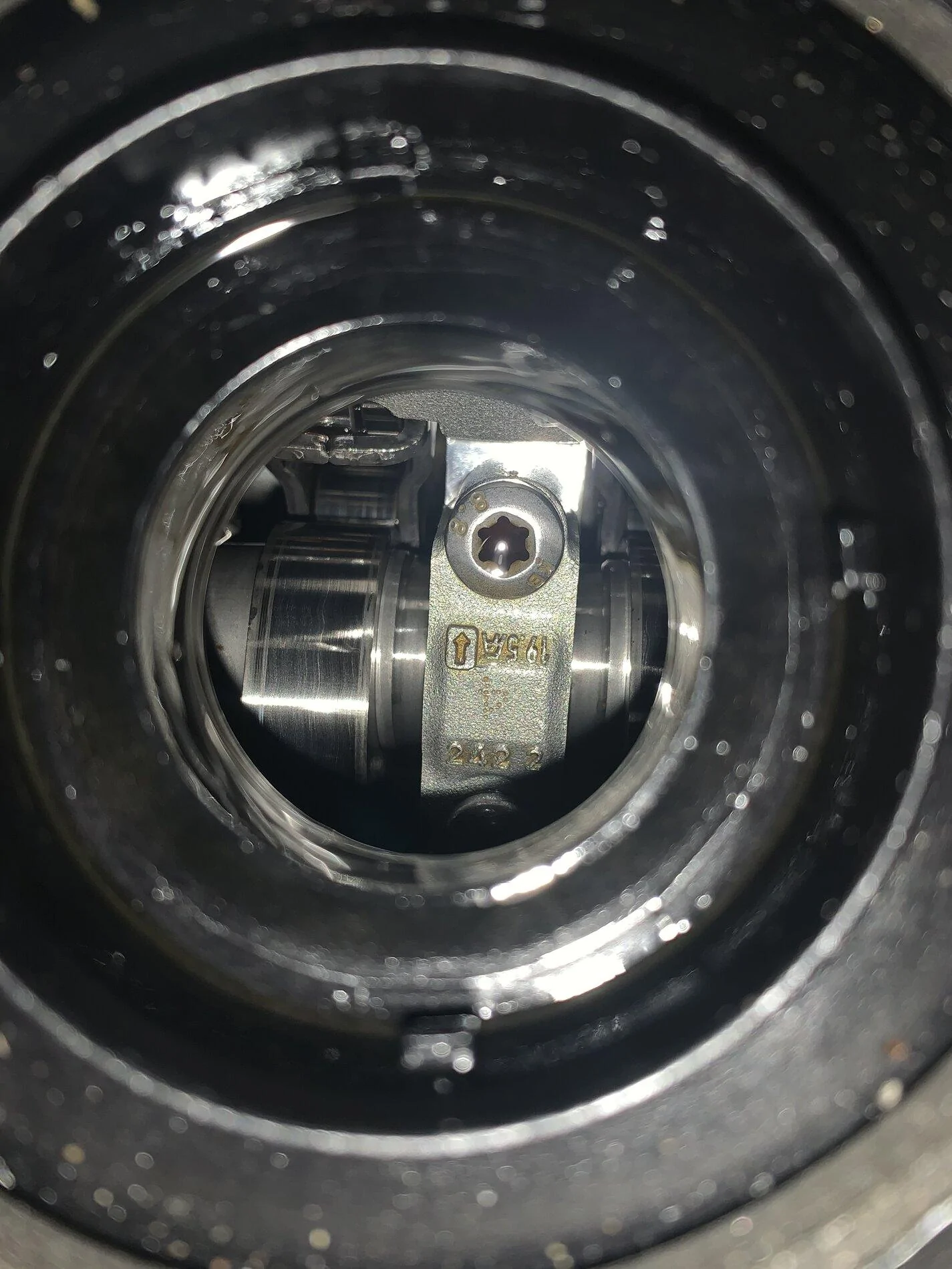

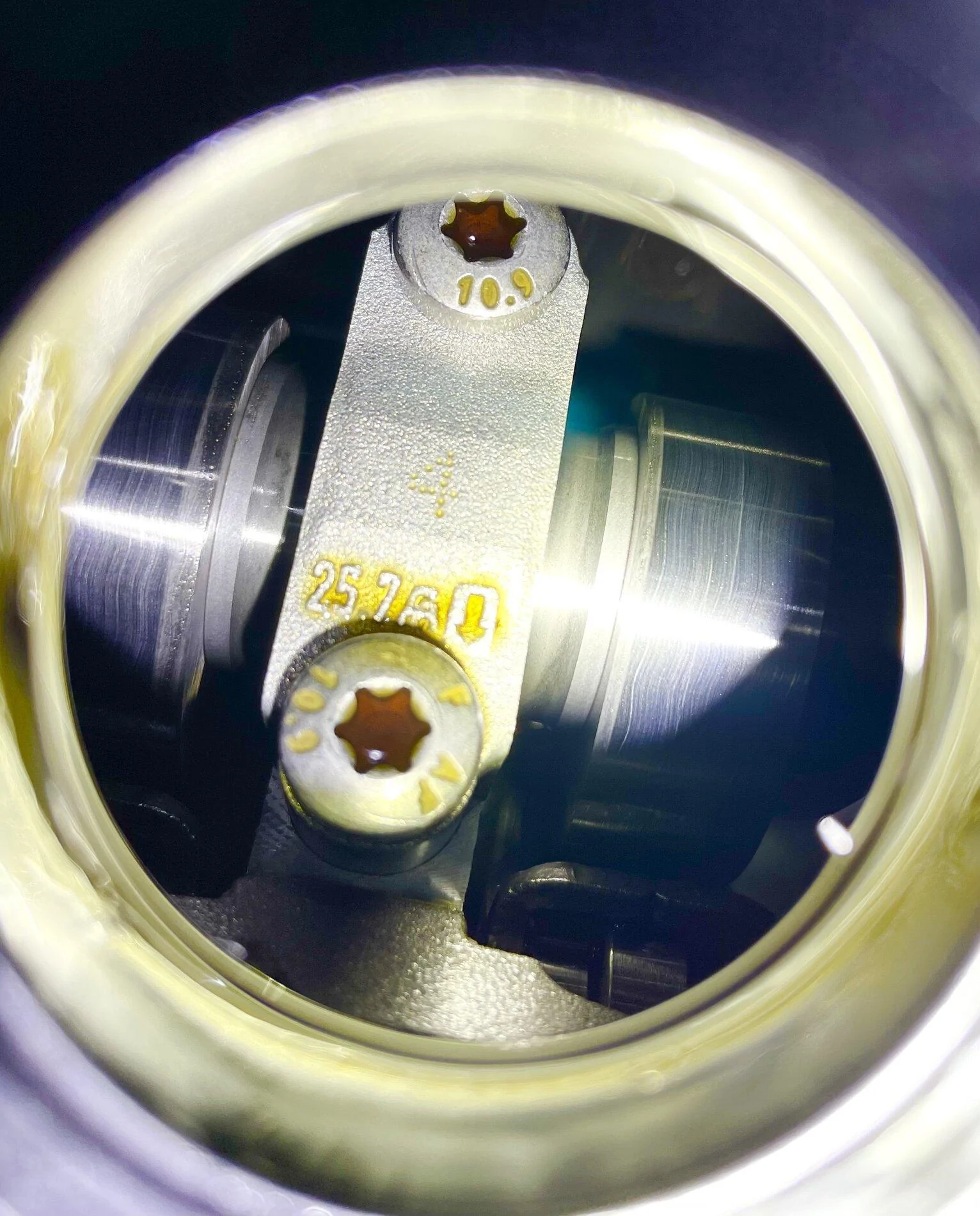

Thanks! So there's some waves in yours and different numbers. We need an engine expert to chime in!
My part # may be different since its a 2020. Just to add i have 13k miles on the car.
Another thing i noticed, mine has 8.8 grade hardware as some of the others have 10.9 hardware for the cam cap bolts. wonder if thats a 2021 thing?
Your guesses are as good as mine but hey as long as they're running strong, I couldn't care less.
