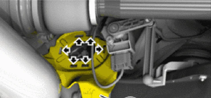

Could be the height sensors. Make sure they are in the right configuration.
Also, if you have new struts, you need EDC cancellers or coded out.
Rear should look like this
